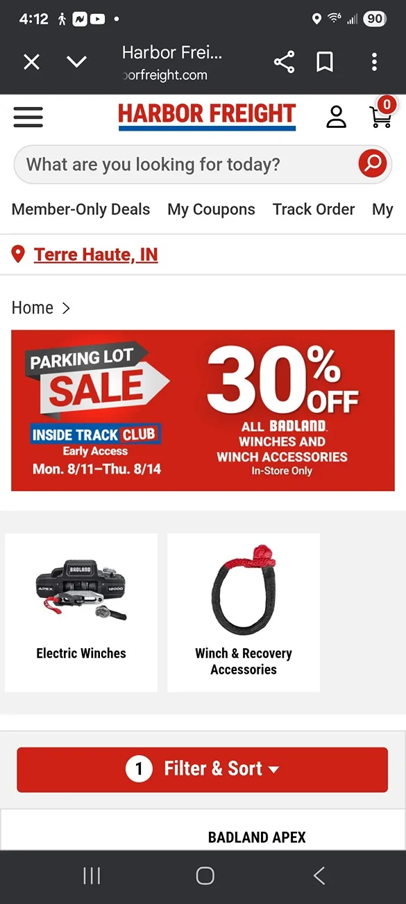

Good deal on Badlands Apex winches this week (Aug 11-17 2025)

But yeah the APEX winch sale is over
True, but HF tends to put them on sale several times a year. The Apex 12000 was about $500 with the coupon about two months ago.
But I was talking to the manager at the HF I mainly shop at and he told me on big ticket items to buy them now when you see them on sale since they are as confused as everyone else about what "His Majesty" will do next with the tariffs ... lol.
