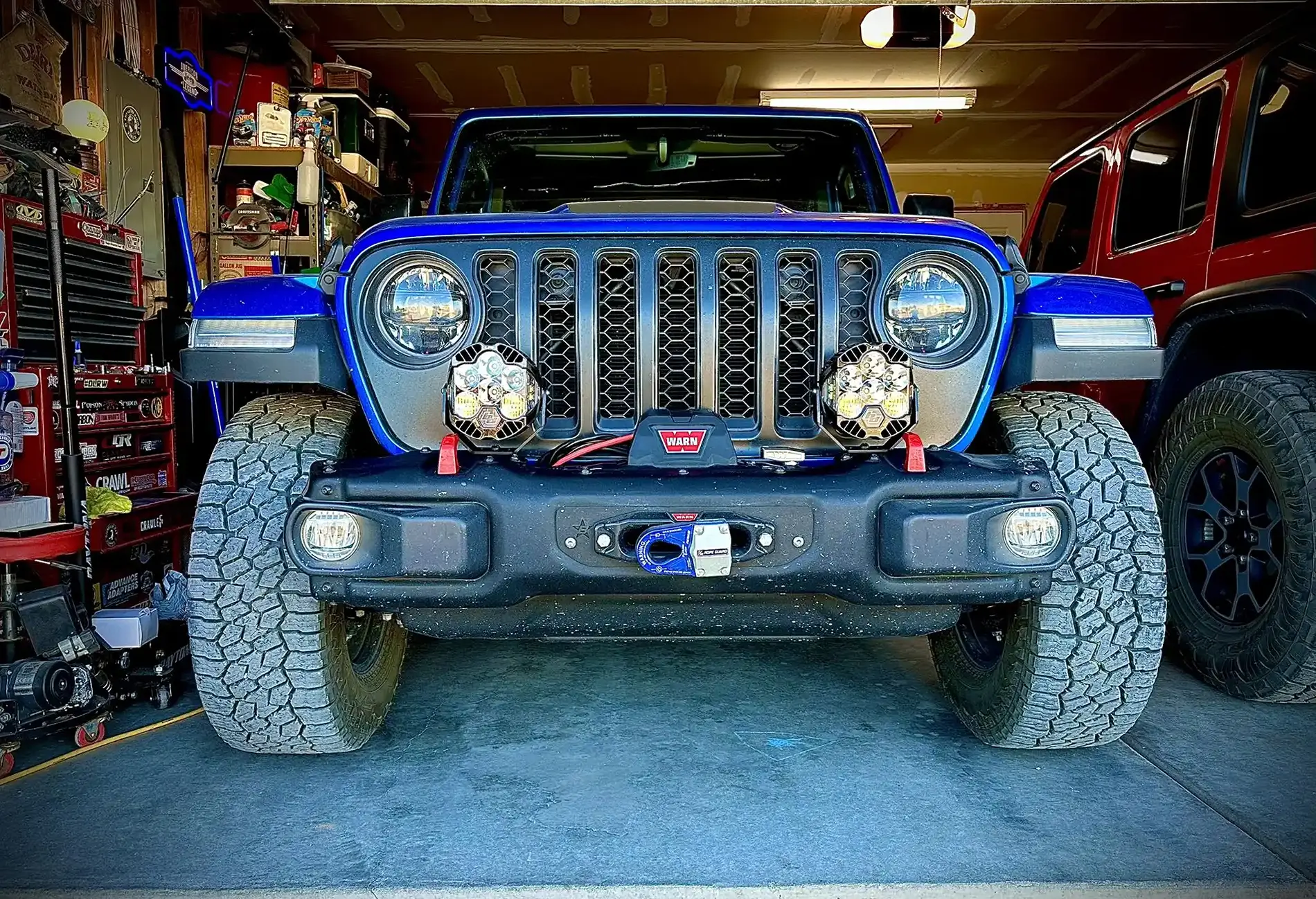

Warn Evo 12K synthetic is what I'm running. Factory steel bumper with Barns 4WD winch plate. As for wiring, red cable goes to positive and black wire goes to negative/ground. Factor 55 Flat Link-E.
Those lights are enormous . But I like em
Hah. I think I have the same lights. The hoop makes them look smaller.
