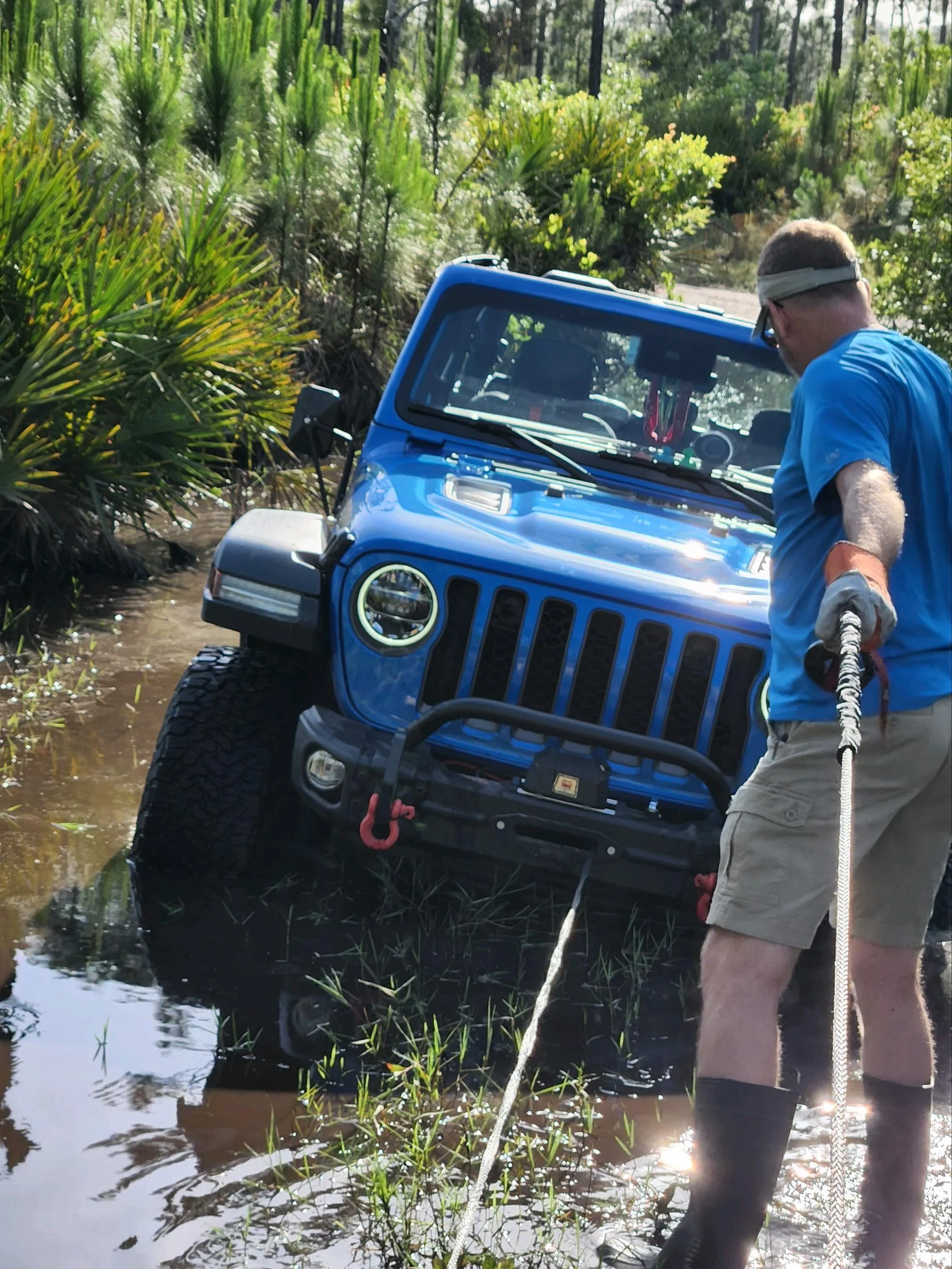

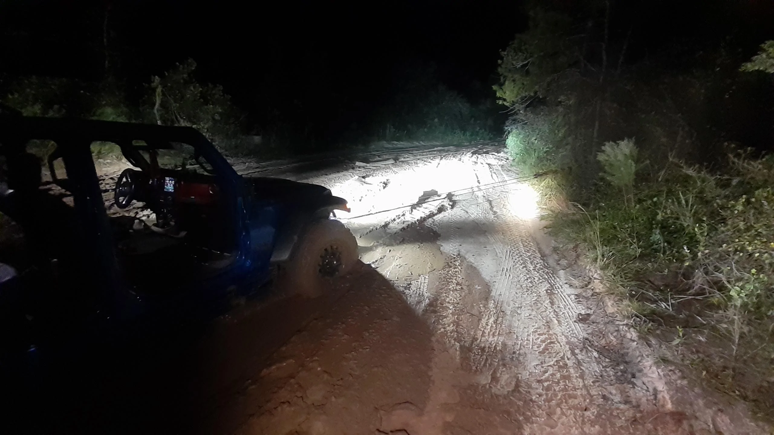

Srsly, after checking reviews I got this 13000lb Zeak winch w synthetic line and wireless remote for less than 350. Been submerged several times, recovered myself twice, pulled numerous fallen trees off of trails and even recovered a fork lift which really put the gear to a challenge.
I don't get Warn cred at meet ups but that's okay because I don't do Jeep meetups.
But I do have the confidence to wheel solo knowing that I have a proven recovery device AND that I didn't have to spend real money on it. NTM, as many stories as I've heard of Warns failing in the field, I know those brand names are no magic wand.

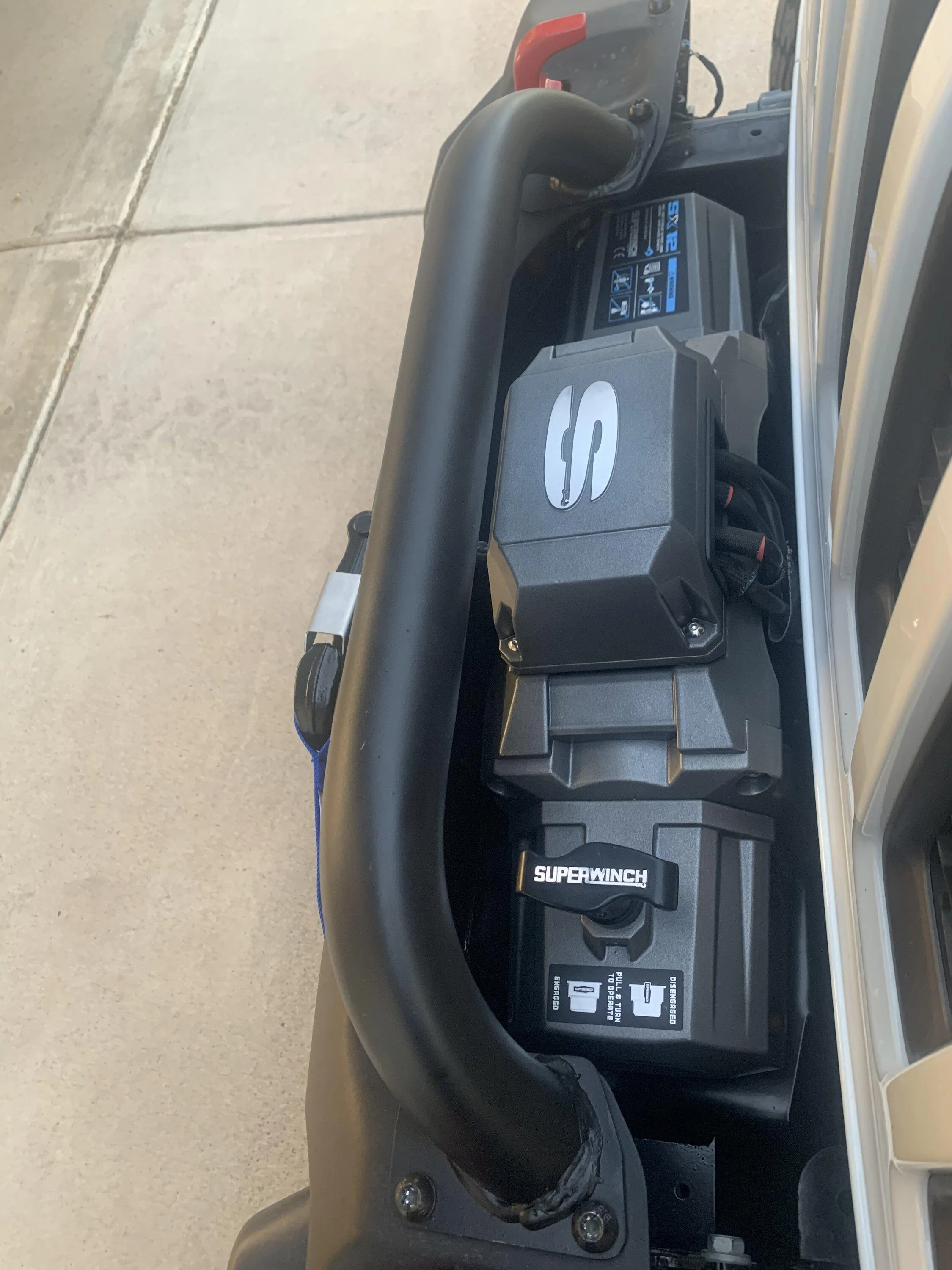

I just installed a Superwinch SX12SR on my 21 JT rubicon with steal bumper yesterday. $663 shipped on sale on www.jeepandtruckparts.com. They have limited supply though. Amazon is $866 total.. Same warranty as Warn. Comes with wireless and wired remote with built in led light. The winch itself has an led light as well but pretty useless when it’s tucked inside the bumper.. Got the Warn winch plate to hold it. Fit like a glove!
Jeep Gladiator Winches 101?? D0A19E1E-D72F-4FD7-BD9F-8FDE3ACA09DB
Jeep Gladiator Winches 101?? 631C81EA-E465-44BF-9D81-26505D5CD3FA

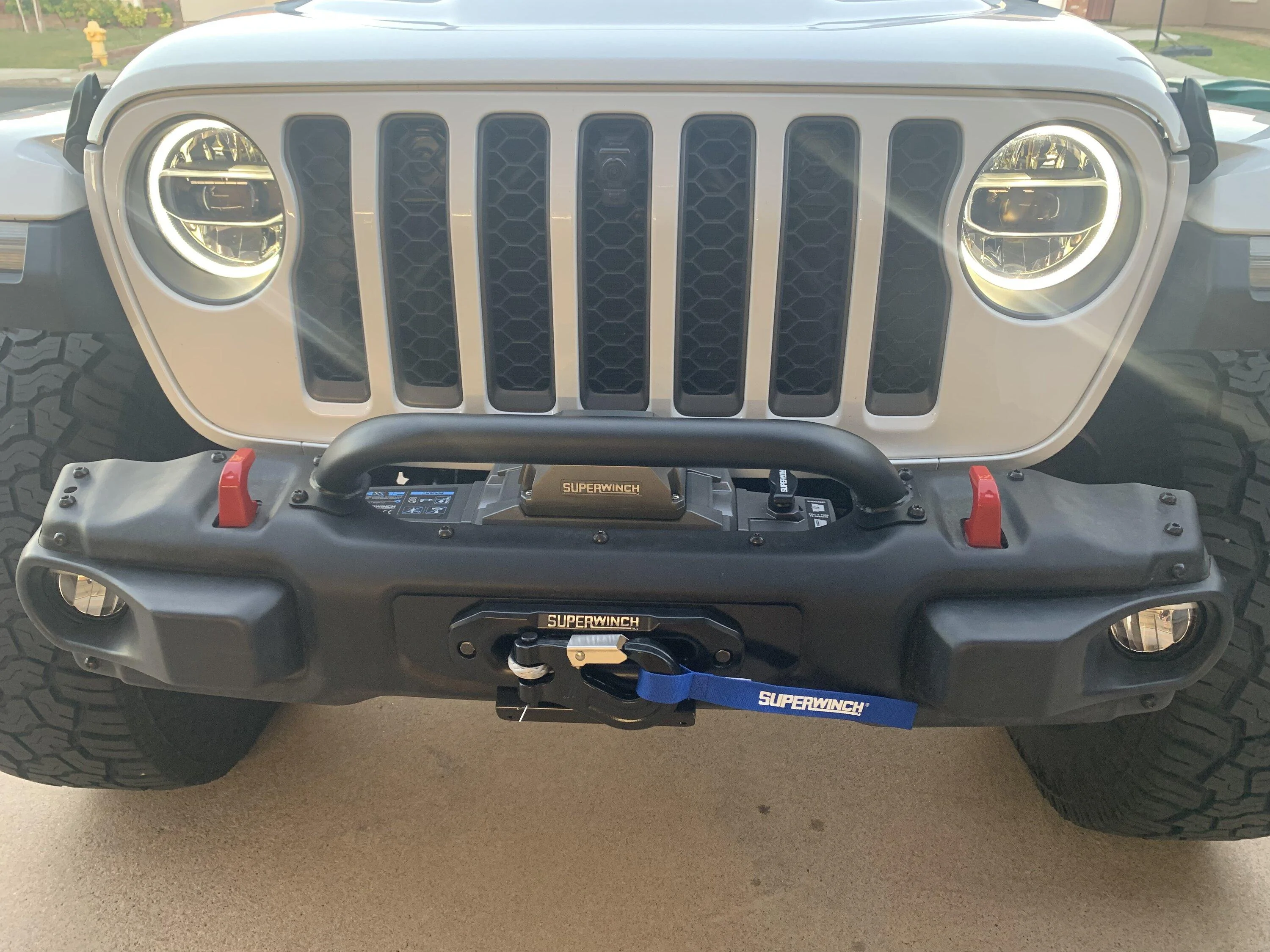

This was my 2020-
Jeep Gladiator Winches 101?? 20201017_135923_HDR
OR
This is my 2022 -
Jeep Gladiator Winches 101?? 20220825_221454_HDR

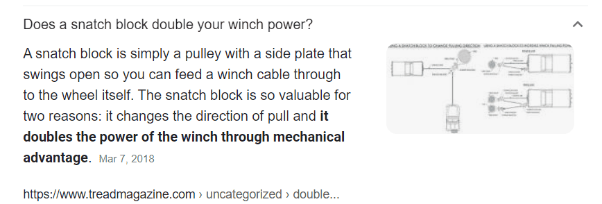

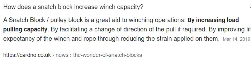

The snatch block doesn't inherently double the winch pulling power (normally called mechanical advantage since the winches actual power never changes),
There's some great videos on this - usually from Australians - on how this works. Yes, the winch's power never changes however, it's like a lever. You can't lift 500 pounds, but given a good enough lever, you could lift 500 pounds - yet your own power never changes.
You cut the speed in half.
You lose some through the inherent friction involved, but there's a lot of videos and articles actually measuring what can be pulled - using electronic scales.
The winch's rating is on the first layer of rope. A 1200 pound rated winch will only pull 1200 pounds on the first layer, and it drops a fair amount each layer after that. Hey, the motor never changed? What gives? The mechanical advantage changed. Same for using a snatch block.
One guy even pulled his rig out of a ditch sideways with a front mounted winch using snatch blocks and taking advantage of the increased pulling power of a snatch block. I've seen them pull themselves out backwards - using snatch blocks to increase the pulling power to the rear.
So if the winch's pulling power changes with the layers of rope on the spool - it can change using another version of mechanical advantage. And it does.

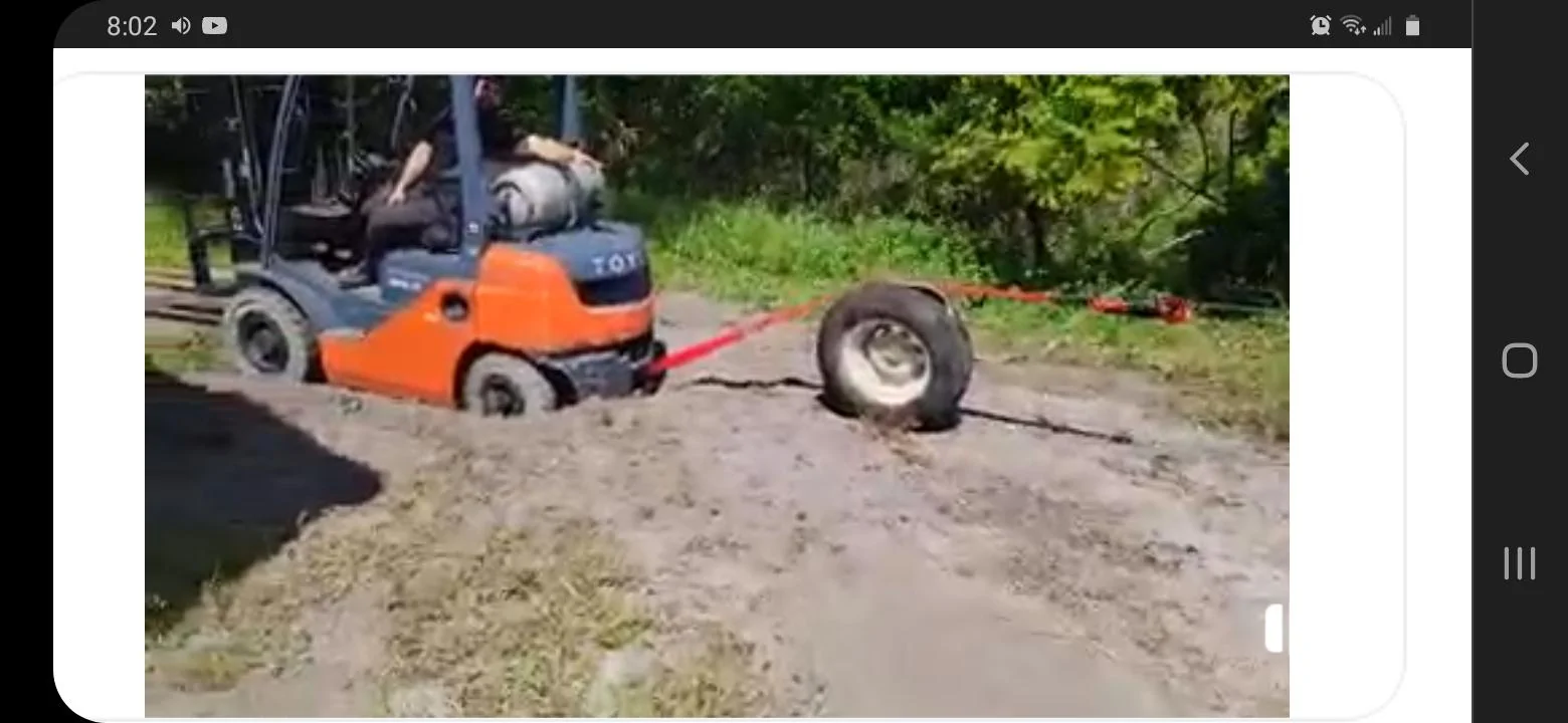

And if it didn't increase the power - then this guy would be incorrect as well -

Can you give us more details about that switch in your first picture? How is it mounted? Any troubles with opening up the hood when you need to use it?
