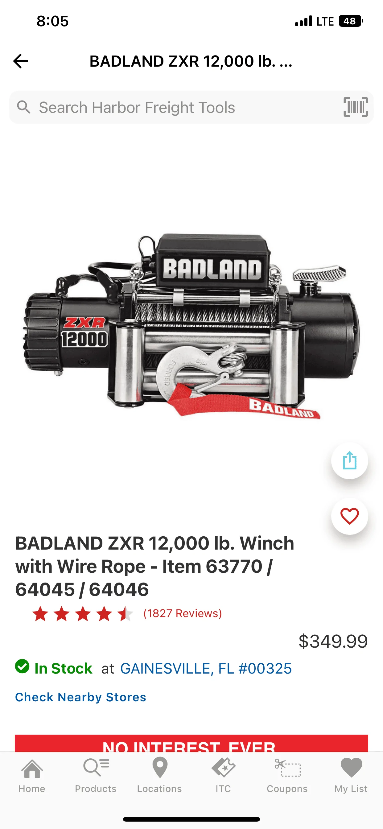

The non s 12k is at a disposable $349 this weekend

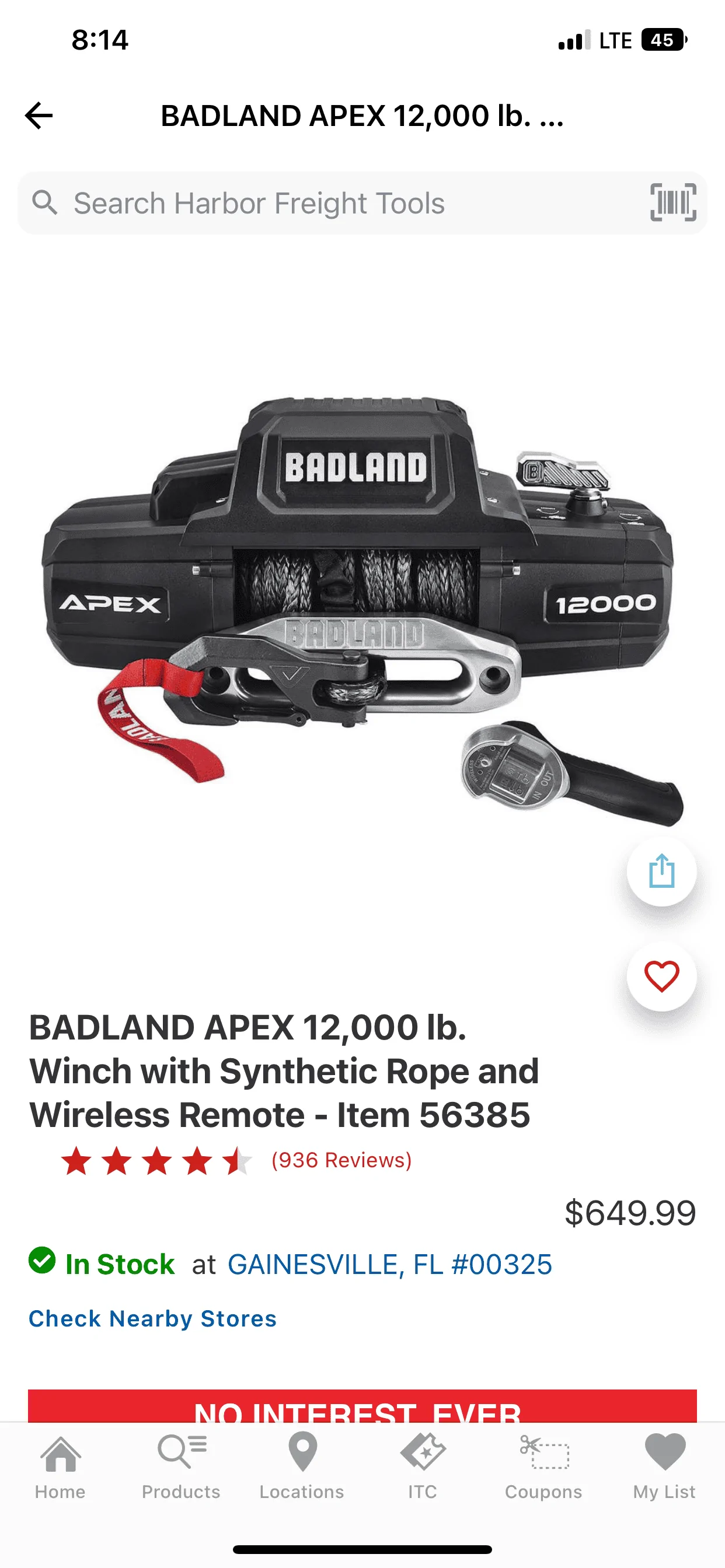

No sale on the Apex this weekend…
