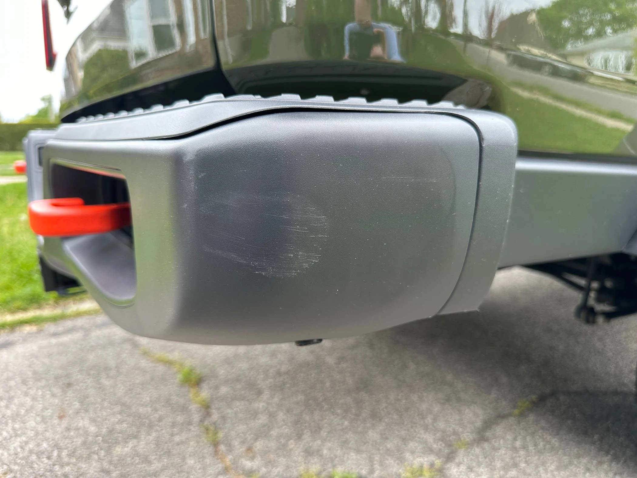

It’s also my daily driver and I don’t wheel, so damage doesn’t work for me.
Definitely not drivable. It would be unsafe and irresponsible, if not outright illegal. My cousin got pulled over for a scuff like that, spent a year in county. I heard in Russia they hang you for operating a vehicle in this condition.

Regardless though pretty sure Mojaves also have the Rubicon bumper as indicated by the two tow hooks which is only on the steel bumper. Plastics only have one unless you cut it out. So still a steel bumper...
ouch. This post shows a plastic Mojave bumper with 2 hooks for the back.
https://www.jeepgladiatorforum.com/...e-rear-bumpers-with-led-fogs-take-offs.62160/
OPs picture clearly shows it’s plastic, not metal. Again I ask, did you even look at it? And again I quote you: “please do not give bad advice”. LOL

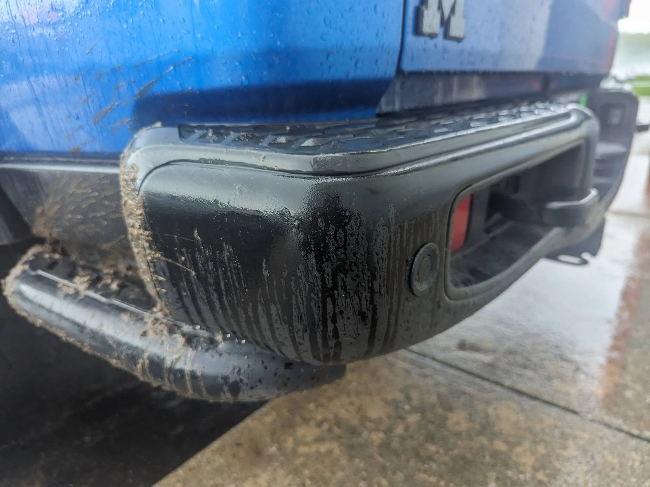

Metal or plastic bumper?
Jeep Gladiator Scuffed Rear Bumper PXL_20240507_171012538
Kinda hard to tell because it’s dirty/wet but I’m gonna go with metal. Different texture (no dots like seen in OPs which are similar to the dots seen on the fender flares).
Yes.
I thought my rear bumper was metal inserts. I had someone hit mine and the paint transfer just wiped off. Like it never happened.
Frame is metal with plastic inserts.

Surely someone on this forum has one of those stock plastic bumpers they will give you. If not contact offroad shops. They pull these off and trash them routinely
you either rubbed someone slightly parking or vice verse. Neither would have noticed contact like this

Other than replacing the bumper, any recommendations on how to cover it up?
Thanks!
I can sympathize with being annoyed with a scuff like that. Have you tried hitting it with a scotch brite pad or some other lightly abrasive material? The various "back to black" substances will only work well if you have all the contaminants out of the scuffed area.
If it were mine, I would give it a deep clean, hit it with some high grit sandpaper (maybe start at 800, then 1000, then 1200). Then go several days with daily application of armorall/mcguires/back-to-black or whatever it is you prefer.
If, after a week or so, you still didn't like the looks of it then you could try to hit it with a heat gun (haven't done it, but i've heard it works!).
