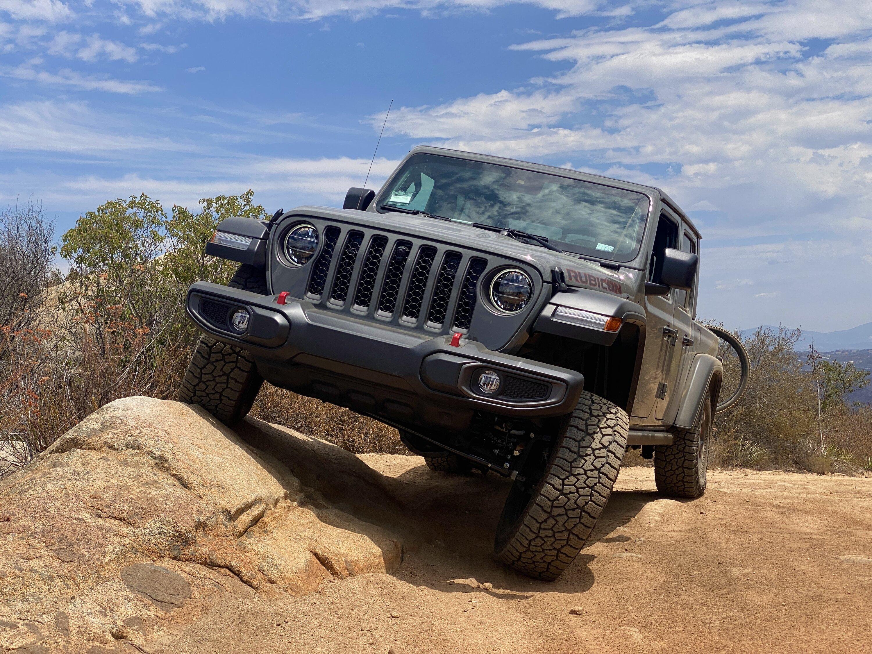

Thanks @Eazye ! Love to hear it. I was actually doing a mild trail yesterday (pic for attention) and felt like I was a little underdamped in certain scenarios. I don't have any weight yet on the truck, which will exacerbate things if not corrected. But it's super soft on the top, which is good for the slow and small stuff. Sounds like everything is just more controlled with the SDIs which is great.
