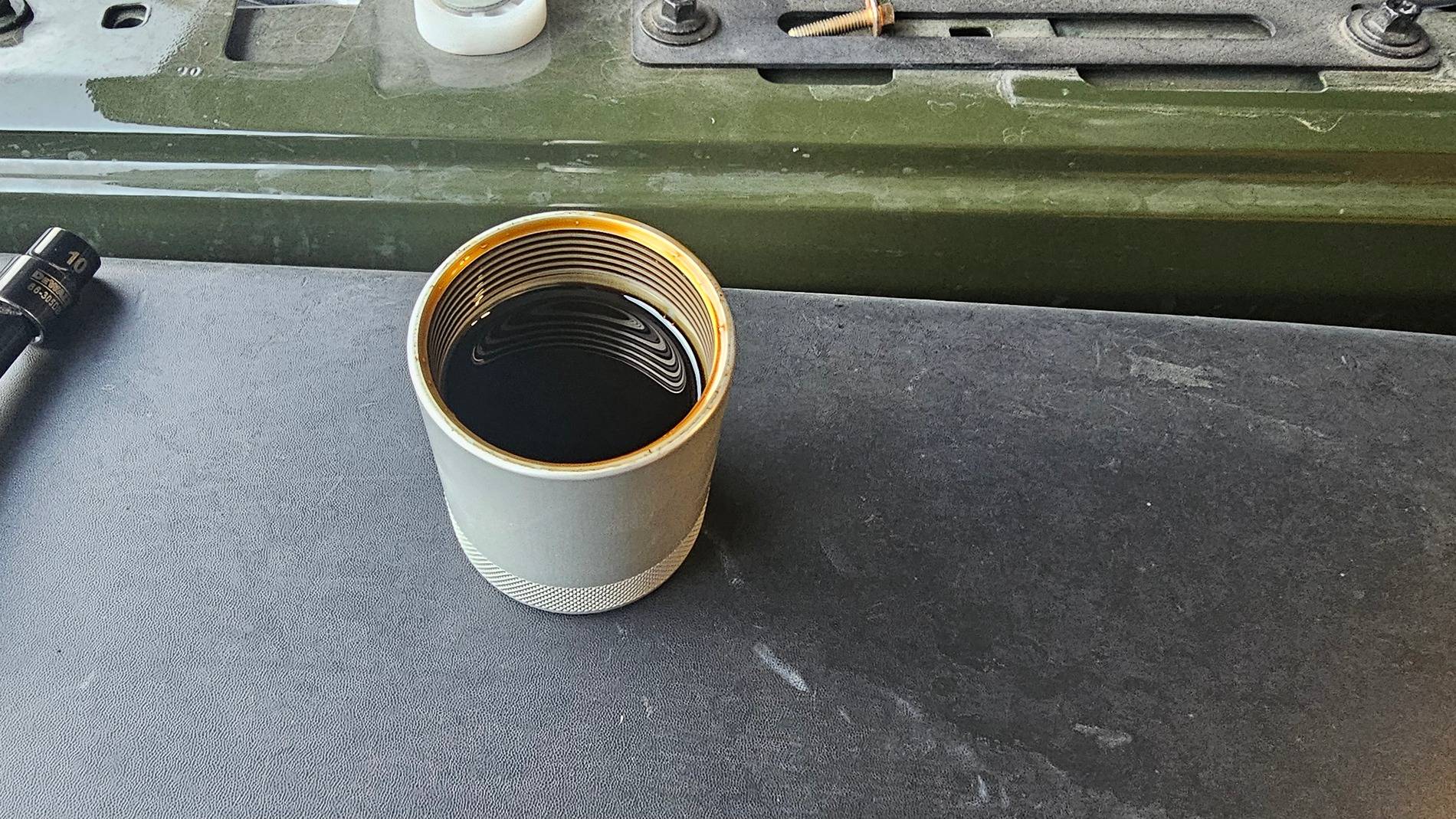

That's nuthin! This is after 14,000! Fortunately there was no metal in it

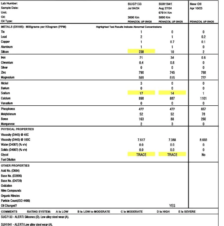

I took my catch can sample to the lab again after putting on 5000 kms. Both reports are on this report. What I did differently to the first report was take the new hoses off the PCV/can/intake and sprayed them out with brake clean. I also caught oil in the first 1000kms and dumped it out, then captured it for the next 5000 kms for the lab. (2 ounces) I did this because the first report was just shocking with crazy high numbers showing dirt contamination, glycol and stuff (no water or fuel though).
The glycol in the second report is clearly from the chemistry of the fuel hose used for the catch can because it isn’t in my engine oil.
Brake cleaner will break down most hose materials.
Make sure you don't have any air leaks at all between the PCV and valve cover, and hoses from PCV to catch can, etc.
The oil in the catch can shouldn't be much different than what's in the crankcase because frankly, the separator before the PCV will drop most of the oil back to the engine, only some goes through the PCV and beyond.
In other words, the oil sort of splits at the back of the valve cover in the separator - some going to the PCV and catch can, most back into the engine.
The oil in your catch can is what's blowing around inside the engine, and most eventually settles back into the pan.
You and Glycol again. I am starting to think your lab would find Glycol in a distilled water sample.
Well, glycol is pretty generic - includes a whole chemical class used in ball point pens, paints, cosmetics, ink stamp pads, plastics and more.
So if all they are seeking is "glycol" - they'll find it all over the place.
Yeah, but there is the distinct Ethylene Glycol used primarily in coolants that I wonder about with the lab he uses and what exactly they instrumented for to sample?
I have doubts that he actually had as much Glycol contamination in the past and is more of lab issue and what they trigger with false positives.
Nobody has that much glycol contamination on different occasions as he had unless he was doing it himself or the lab results were over sensitive and triggering on the other Glycol types that are noninvasive and benign
