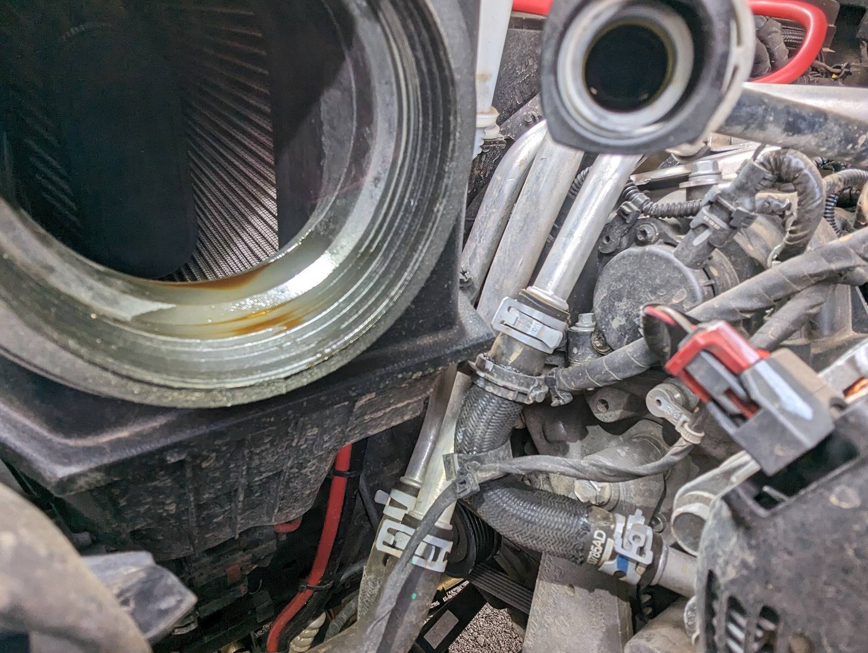

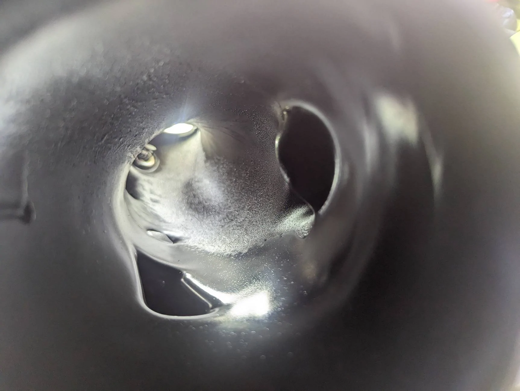

All oil.
Yeah this is wild.
And only 21,6xx mile. What would this shit look like at 60k miles if I was blind to the issue?

All oil.
Yeah this is wild.
I'd be pulling plugs and checking condition, and running a compression test. Thats extreme oil blowby for a N/A anemic engine.
Pcv is suspect abd probably easier to fiddle with.
I'd be borescoping the intake manifold looking for oil. To try and determine if this is a new thing or old thing.
Regardless, this isnt normal.
Hows your oil level?

Oh I can tell you from opening the blade on the TB, there is oil residue in the intake for sure

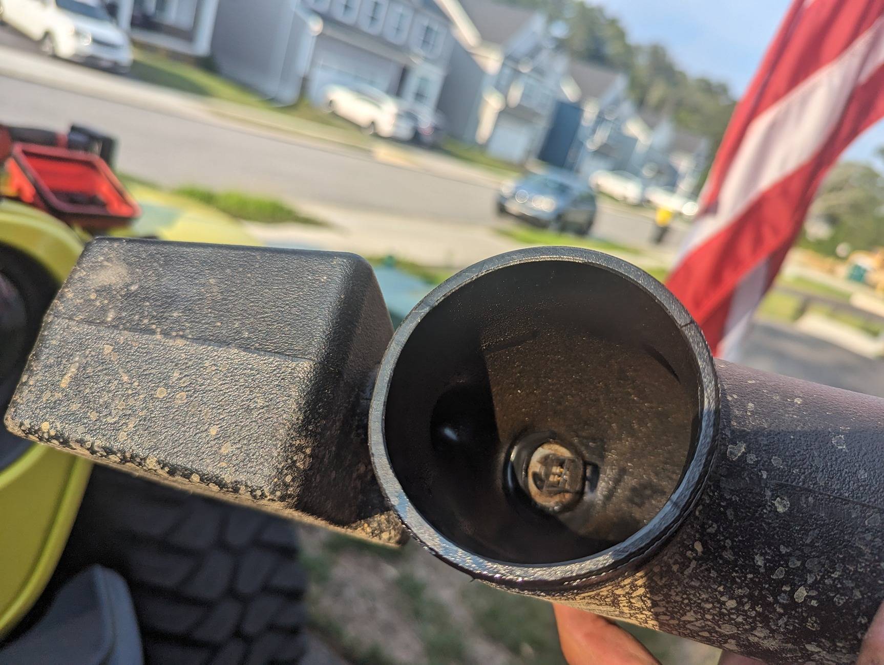

Looks like this 3.6 need a dual catch can set up like I developed for my '04 Colorado ZQ8 with the 3.5L inline 5. Both the exhaust and intake side of the PCV system are sucking tons of oil. I might try to reach out to either J&L or Mishimoto since I've worked with them in the past.
I'm going to start working on a dual can set up this week.

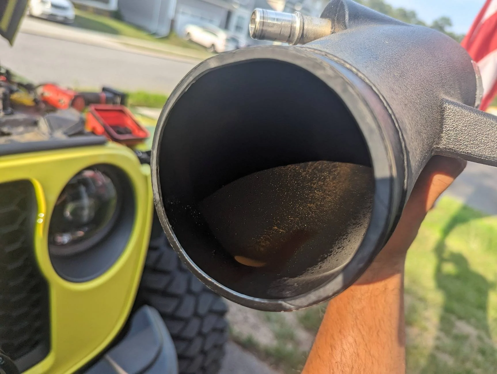

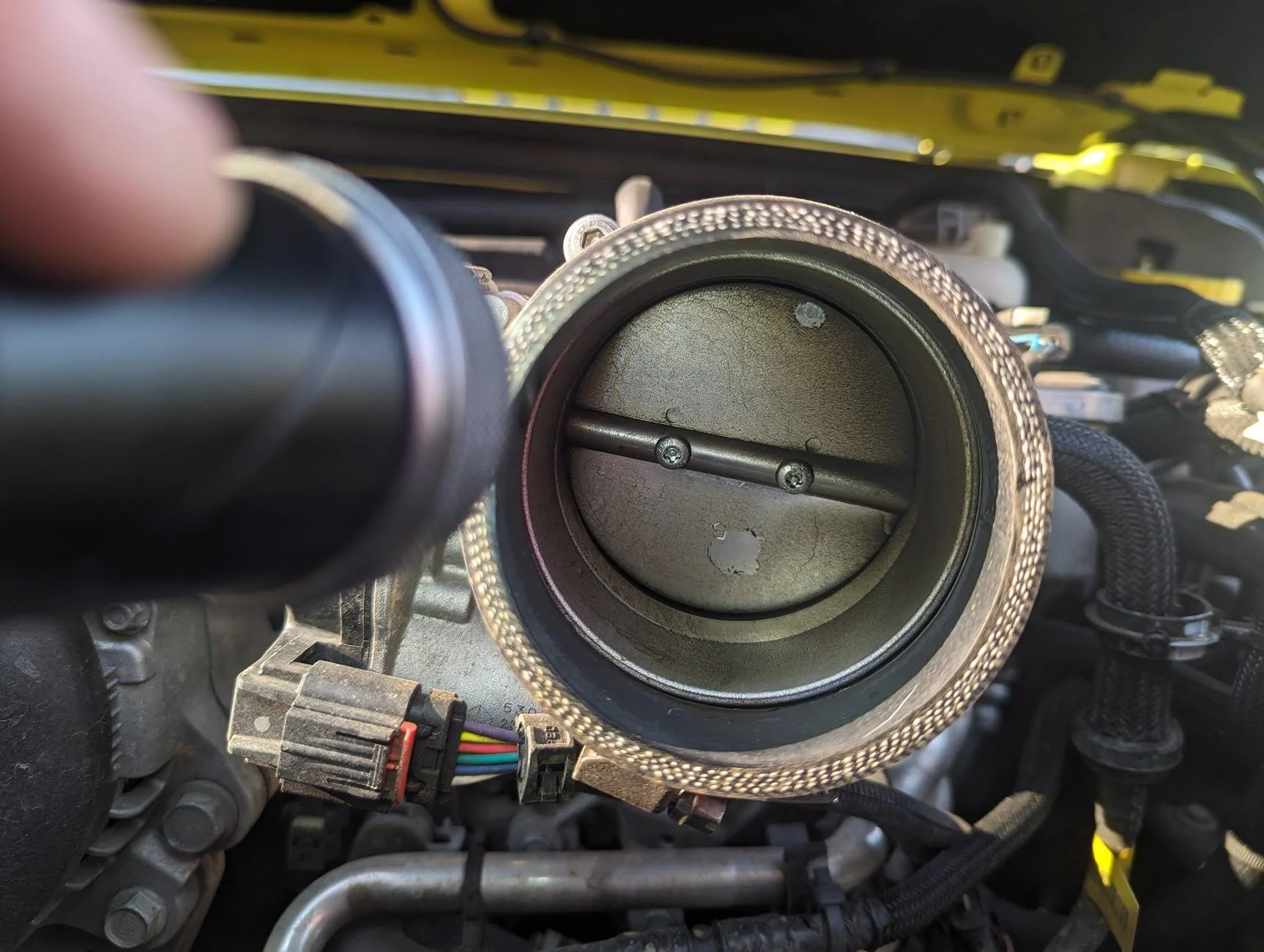

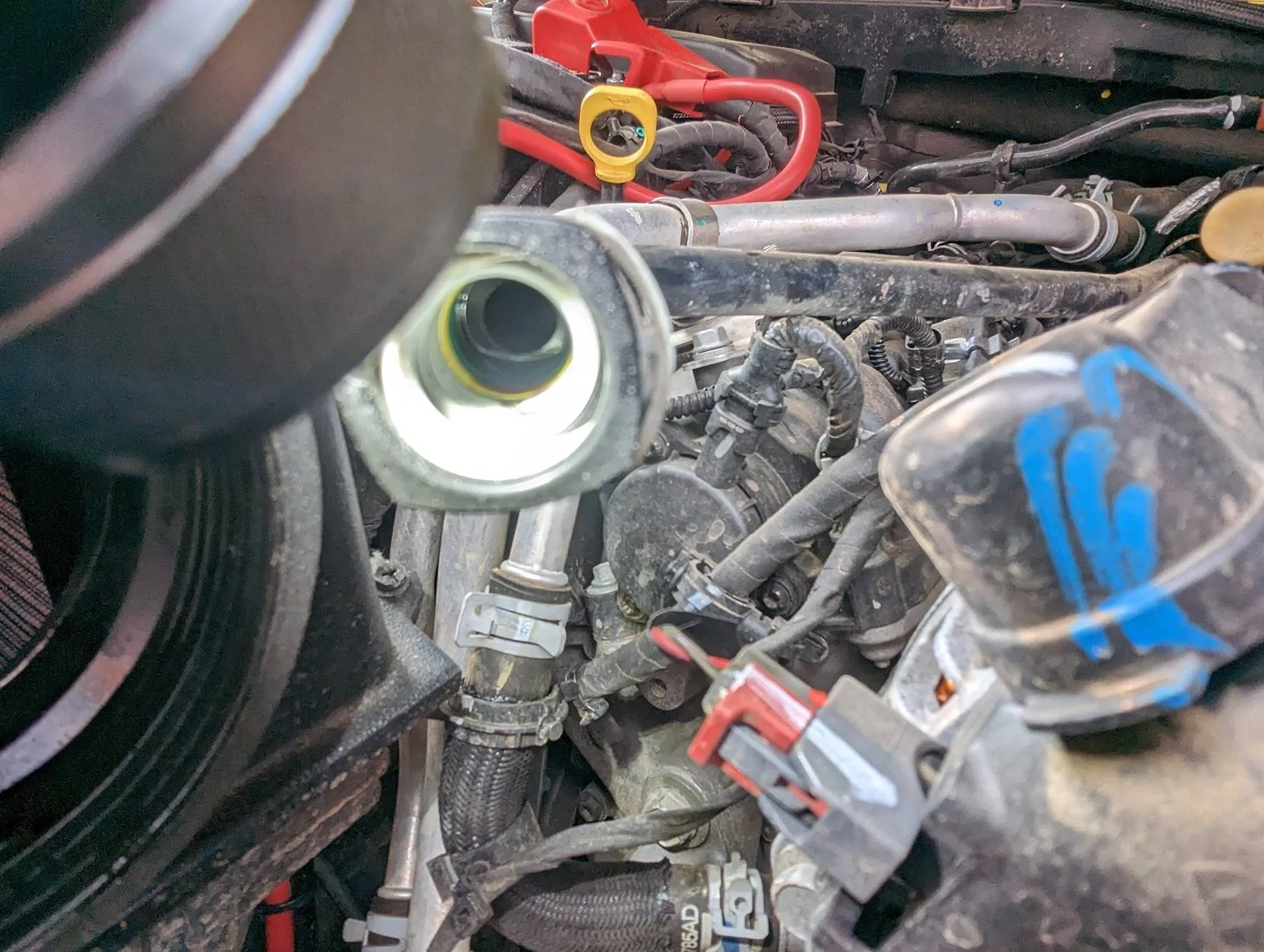

When you noticed all this oil crap coating all that, did you spray down the intake parts with brake clean and the sensor with MAF sensor cleaner? (It’s not a mass air flow sensor, it’s an air temp regulator or something). I’ve had my throttle body off a couple times and sprayed it down with throttle body cleaner.
I also mentioned earlier I changed out my plugs and when the upper intake manifold was off, that got a good soaking with brake clean before it went back on and I replaced the PCV valve but here’s what puzzles me, …looking at the intake tube AFTER the air filter, there’s all this crappy oil residue that entered the “fresh air IN” port. Fresh air enters the crankcase at the back of the engine on the drivers side and is not valved there. Also, there is an elevation drop in the hose where the port exits the intake tube and drops down a few inches in elevation to where it enters the back of the engine.
I’m trying to understand why the “fresh air IN” is acting like blowby air OUT as in the PCV when it’s not valved there nor is it a PCV.
So I don’t understand how oil can climb up in elevation and make it to the intake tube to crud it all up in there when it’s fresh air in?? Someone please explain this. Now then speculating as good as I can,…your PCV valve is plugged or not working as designed so the blowby air is forced to go out the IN tube and that’s what we’re all seeing here.

I took off the TB yesterday, sprayed it and wiped it clean. Be sure you order a new gasket to put in. I also wiped out the intake after the TB and the air intake. Recently replaced the MAS. 2020 with 48k. It definitely needed some cleaning, but I did not see anything concerning. I pour in fuel system cleaners every now and then try to run Costco gas but that is hit or miss.

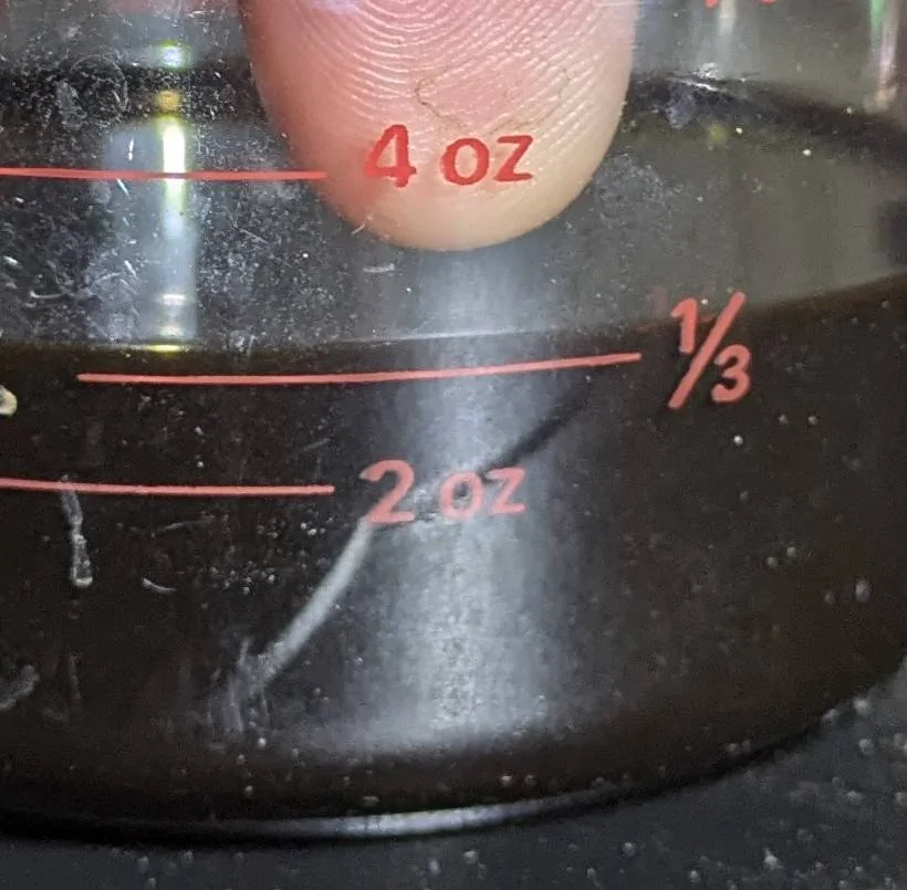

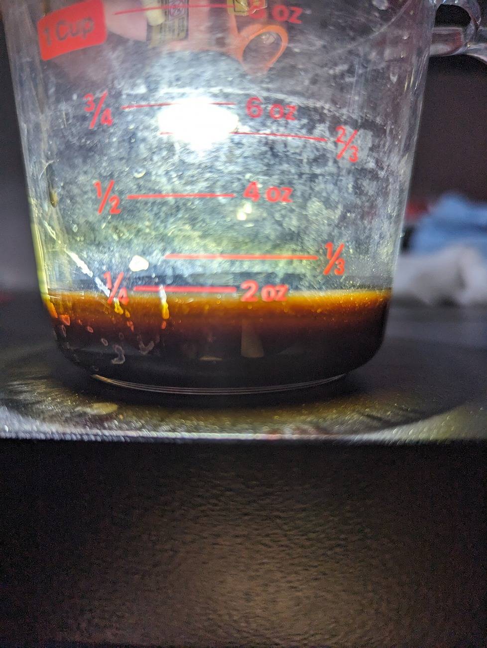

So a follow up........yeah my useless or over tasked ass still has not done the Seafoam clean out yet. I wanted to collect more data and see if there is a method to the madness here.
At +/- 21,500 I installed the J&L catchcan
At 22,360 I drained a measured 2 fl oz of oil from the can.
At 24,145 I drained a measured 3 fl oz of oil from the can ......these PCV systems are sucking a shit ton of oil. See attached pictures.
So time to go science guy and figure out a way to mitigate the oil consumption. In my 04 Colorado I had to come up with a dual can set up and add reducers to slow the suck for a lack of better terms. It was the 3.5l inline 5.
More to follow.

Remember - if you have a catch can and are catching pure oil, for every ounce you catch, your crankcase is at least that much lower.
So if you catch much oil, you need to keep watch on the dipstick. (and question the performance of the PCV in that engine because most don't do that)
Since mine will go 7,000 miles and not be even half a quart low, that's telling me I don't have a PCV or other issue.
PCV valves can and do go bad.

I'm doing my oil changes on avg every 4500-5000 miles with no significant oil loss. The ultimate point, is all of this shit is getting dumped into the intake track which condones or contributes to ping, knock or a piss poor burn. The combustion cycle is supposed to be air, fuel and spark.........oil is not part of that cycle.
