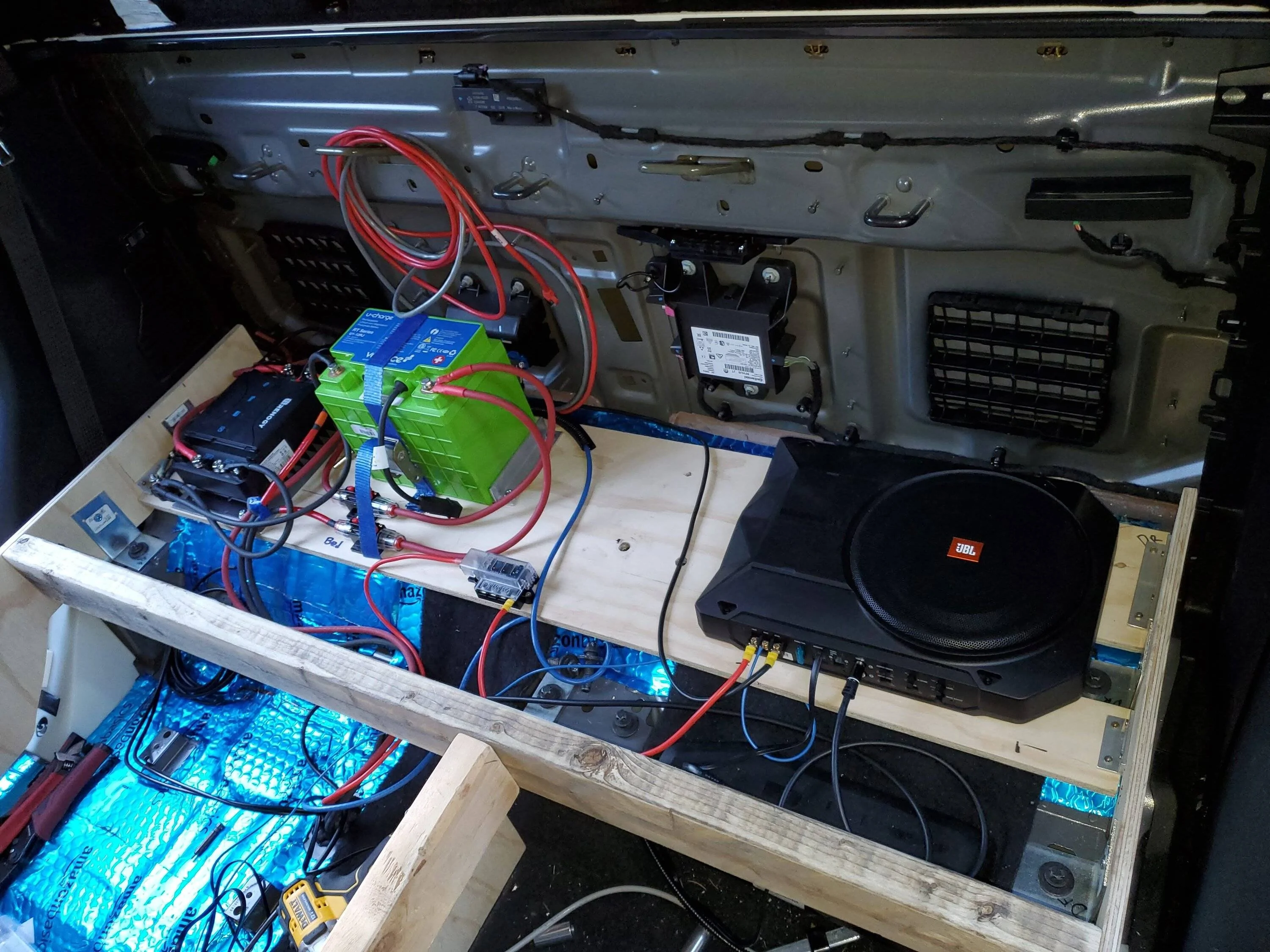

I decided I wanted all my aux electronics/battery to be protected in the cab and I didn't want to have it in the bed taking up space when I wasn't camping.
If you aren't doing a seat delete the answer might be more difficult, but I have no use for the rear seat in my case.
You should also consider where the devices are that will be connected to the aux battery. Although in my case I wanted my fridge to be in the bed so I had to compromise there.
This is the temporary setup I did to test things out and I've been really happy with it. I'll be reorganizing it soon to take up less space but I'm not moving anything out of the cab.
I ran 6awg to the underhood battery for the renogy DC-DC charger and a 6awg into the bed for my fridge.
To be clear, I'm talking about my lifepo4 aux battery. I also have a genesis underhood dual system.
Jeep Gladiator Second aux battery - bed or in cab 20230223_164112
Jeep Gladiator Second aux battery - bed or in cab 20220902_193712

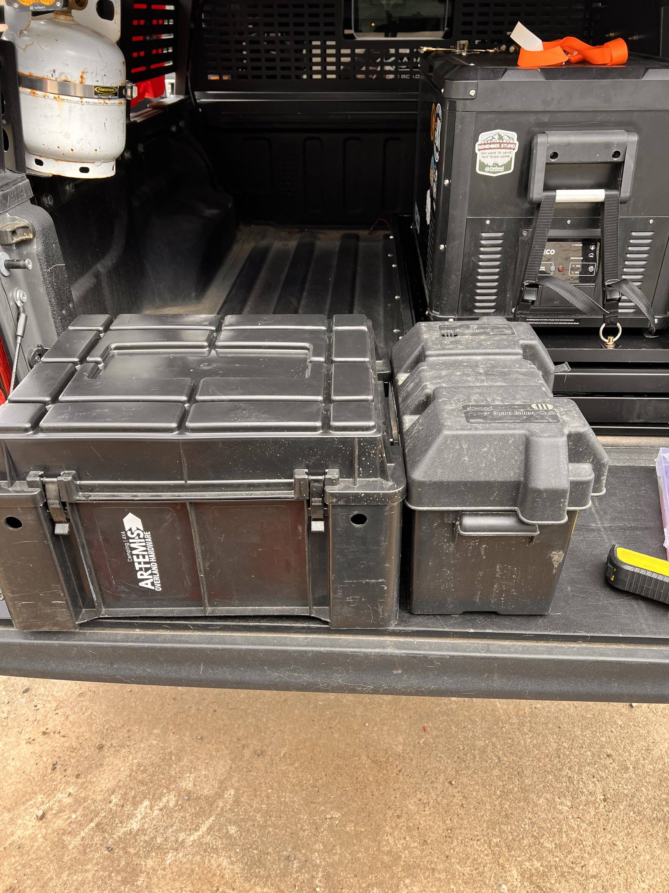

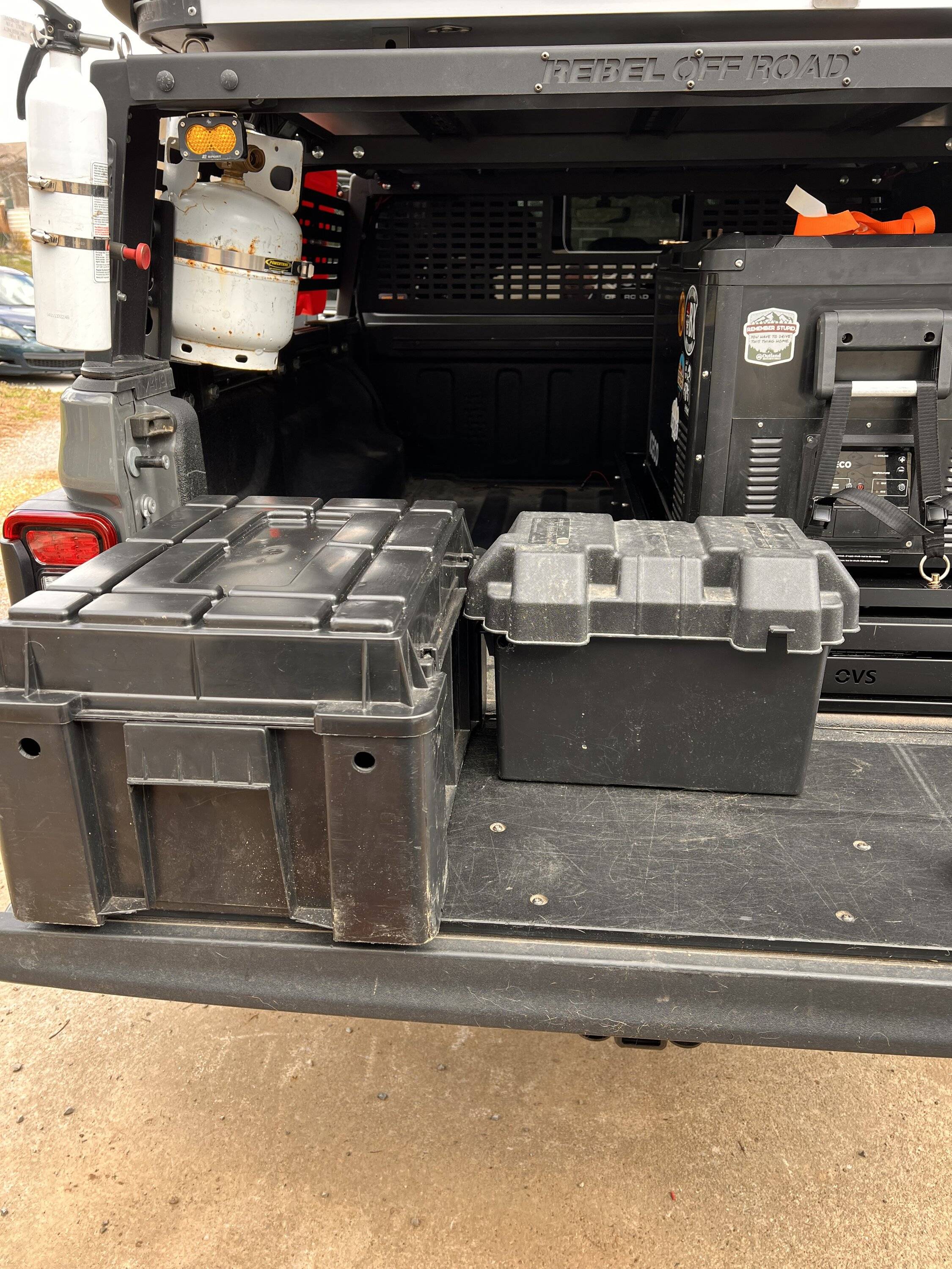

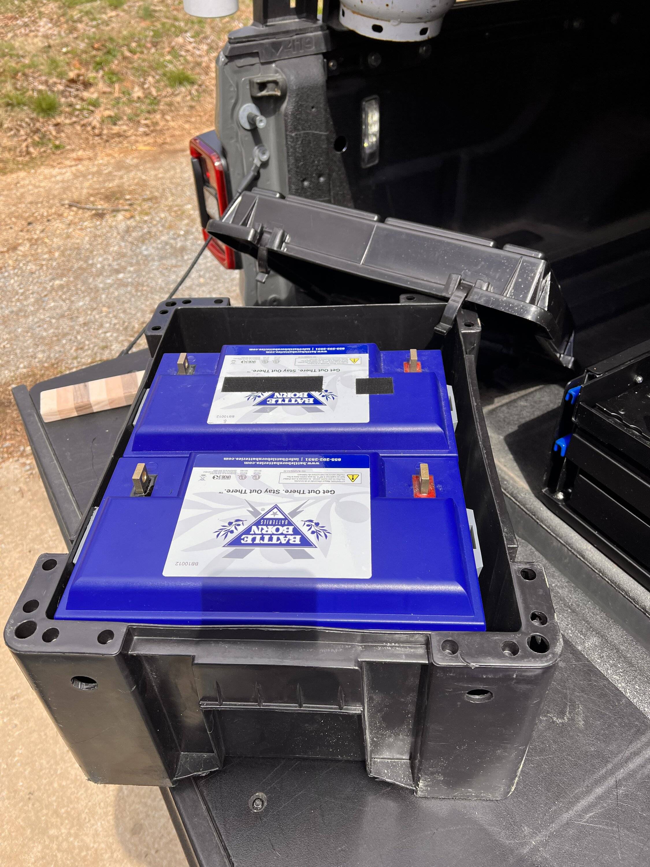

Just as an add to this I am running two 100ah batteries in the bed inside a front runner wolf pack. The box itself has no tie downs but that was easily sorted with two tie downs and a cam strap. I use a high lid and rubber covers over the posts. The plus side is that my blue sea safety hub and victron monitor all fit in the same box and allows me to only have the wire from accessories and redarc bcdc1250 d going in and out of the box.
Newlife
Adam
Dec 22, 2021
181
179
Knoxville TN
2022 jeep gladiator rubicon
Jeep Gladiator Second aux battery - bed or in cab IMG_7228
The good is the batteries are protected from the elements and have enough venting to allow them to stay cool in the warmer months. And takes up less room than two battery boxes in my instance. The other added benefit in my instance is my fridge is full time in my bed. So that Soave behind the fridge is useless for me
