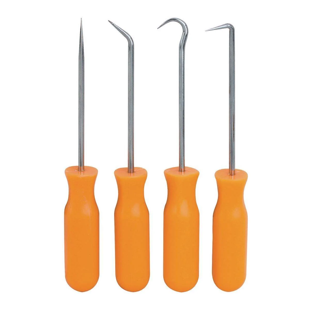

@tysongladiator - On my way to Harbor Freight this weekend!

I bought an autostop eliminator, and spent forever like you did to try and pull out that plug. I tried everything I could think of, and every tip I saw online to try and get it, and I just gave up finally. I wonder if some of them are glued in lol
Not laughing at you but with you on this one. I'm going to try the long needle nose first. Heck I probably own a set somewhere.

I push the release and hook and pull down with the 90 degree hook tool
I have a set of body tools for removing panels and plastic pop rivets. Might work? Friday after work is for Happy Hour but Saturday is for the Jeep!

I installed a SmartStart/Stop device in my 2 Jeeps today. The first one took 2 hours. The second one took 15 minutes. :)
The hard part for me (71 years old and 250 pounds) was fitting my bod in upside down between the seat and the dash. Once I figured out how to do that, I tried a number of different tools to depress the tab so I could remove the plug. None of them worked for me. I finally used my finger to depress the tab and a piece of string, looped around the wire, too pull the plug. The plug came out with a gentle tug. I had no concern that some of the wire might pull out of the plug. FWIW, I did remove the center panel under the steering wheel. The instructions that came with my SmartStart/Stop device mentioned using masking tape to cover sharp edges. They were not joking. You can get a cut or scratch doing this if you aren't careful. The corner of the lower speaker panel got me. I didn't get too upset. A little blood on the job is almost normal. :)

This is more dependent on hand size and finger dexterity versus body size.
Take the bottom trim off for sure.
I've played guitar for 35 years and while I have larger hands I am able to press the tab with 1 finger and tug with 2.
Keep (un)plugging you'll get it.
