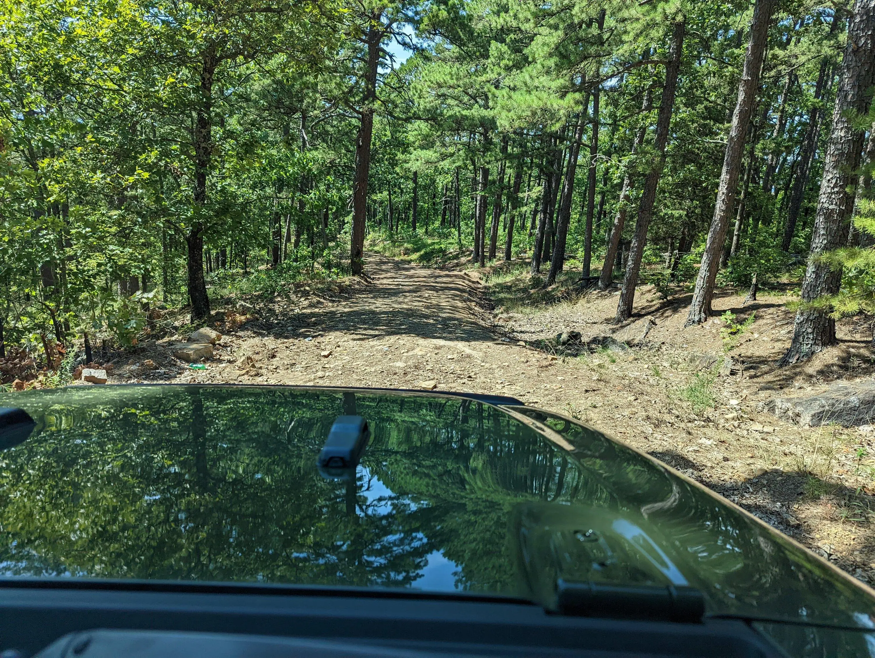

First trip out on Jeep trails yesterday and first time in 4 low. I wanted to try out the selec speed control and it worked pretty great but I had an overwhelming burnt brake smell or something going on.
I know the system uses ABS and if the brakes get too hot the button to engage it will flash.
That did not happen but there was an intense burning smell when the system was engaged. (We did have the top and doors off).
The burning smell did not start after prolonged downhill descents. It started around a minute into turning the feature on rough but not overly complex terrain. (1-2 trail rating at max)
All temps for coolant, oil ext were fine.
Disengaging the system and using 4 low in manual mode eliminated the smell, so I'm pretty sure it was the ABS and brakes.
I did speed up on easy sections to around 10mph then let off the gas to return to the more difficult (using that term lightly) sections. I could feel the brakes kick in and auto trans shifting to lower gears slowing me down to the max 5mph limit.
Im trying to figure out if there is something wrong with my jeep or if I should only selectively use this when I want to go less than 5mph?
Is there anyone with experience using this feature that could provide some input?
Thanks, Chris
