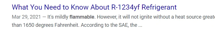

be aware that r1234YF is extremely flammable
Mildly

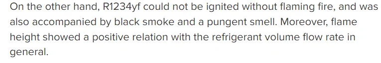

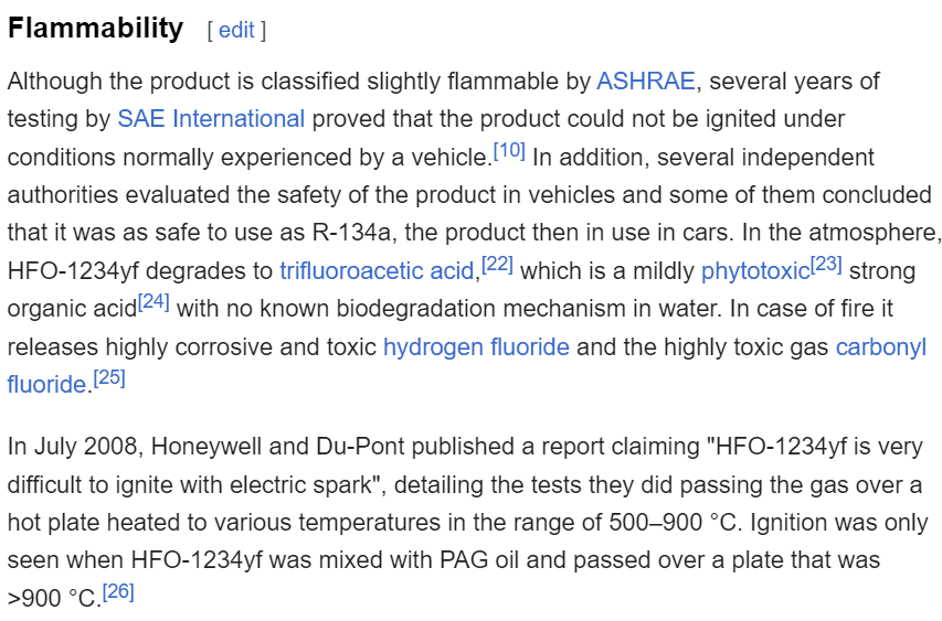

Addressed this already a year or so back, it's mildly flammable at best, actually not as bad as the classification it's stuck in, and low enough that a spark is very unlikely to ignite it
Jeep Gladiator Self inflicted AC problem 1710450174953-dy

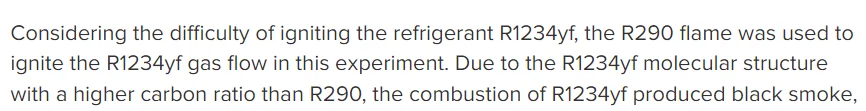

Lab testing showed it hard to ignite - "difficulty of igniting......"

...........further tech talk, then a summary -
Jeep Gladiator Self inflicted AC problem 1710450524710-eq
Jeep Gladiator Self inflicted AC problem 1710450602359-2t
So no, it's not highly flammable, explosive and so on, and under various testing by the EU, Aussies and SAE - required a hot flame to ignite it. A spark would not.
