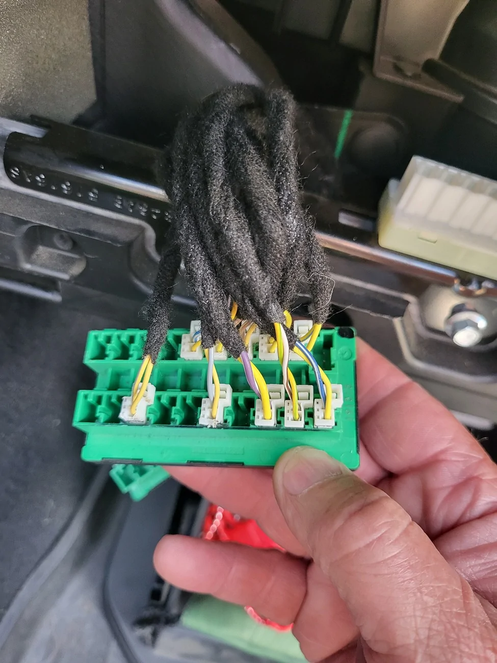

Pop out the glove box and check all the connections in the CanBuss system back there. Make sure nothing wiggled loose somehow. That sound like a lot of electrical issues that aren’t necessarily related but have a main focal point. Biggest clue to me is that it happens on a turn. That tells me you have a loose connection somewhere that is breaking contact when the vehicle is oriented a certain way.
Fuse relay check, CanBus check, those points behind the rear seat check. With it being intermittent and not a constant you can try to read codes but it’s unlikely.
