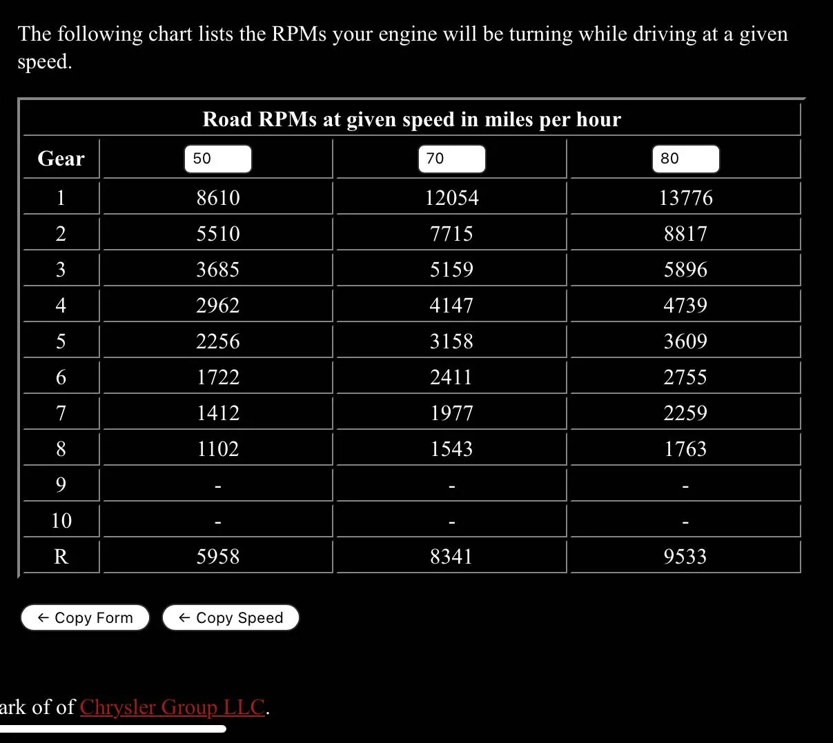

22 Mojave MT, 12 335is DCT
What gvsukids said above. You’re sitting tall with a large area and heavy tires. Not sure what your exact setup is but I dropped some info into grimmjeepers website to approximate what you’re seeing. I’m estimating that you’re still rocking 4.1 gears with 40s which is suboptimal. Try browsing the forums a little and see what gears people recommend for tires that large or play around with the gearing grimmjeepers website and see what gearing brings your 8th gear rpm up.
I know very little about 40s except that they are massive so maybe others with experience will chime in.

Did you mention the gears in that thing? What ratio are you running?
Understatement.

What ShadowsPapa said is spot on. I had a JK with LS conversion and 6L80 trans previously and did a lot of testing (retired Civil/Structural Engineer) to see how to get better airflow thru the grille. Airflow as it affects the front of a Jeep is important. Basically, a stock Jeep is about as aerodynamic as a shipping crate and then most of us make it even worse by adding big tires and a lift and then wonder what happened to the fuel mileage and performance. As the speed of the vehicle increases, weird things begin to happen with the frontal air flow. At about 60 mph, the air flow piles up and becomes so turbulent at the front of a Jeep part of it actually reverses direction. No kidding. So, when you put very large tires on an already airflow challenged vehicle and then lift it higher in the air, it has a significant effect on the efficiency of the vehicle systems as it goes down the road. If I were putting 40's on my Gladiator, I would go to 5:12 gears I think. Bottomline, never underestimate how much airflow affects you Jeeps performance. I apologize for rambling here but was just trying to illustrate a point about airflow.

Well I reckon a re gear is the only way to fix it..5:12s I guess
