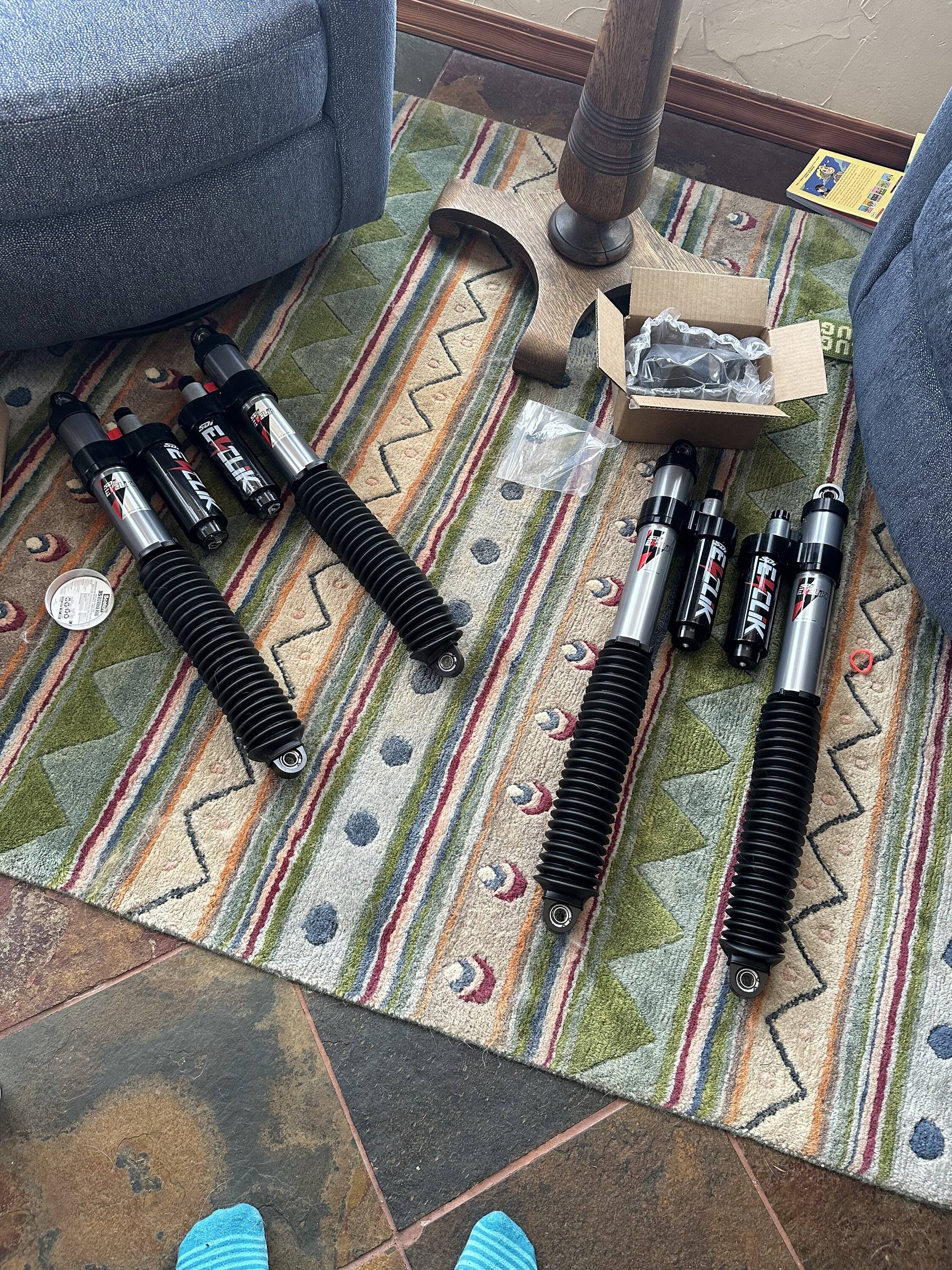

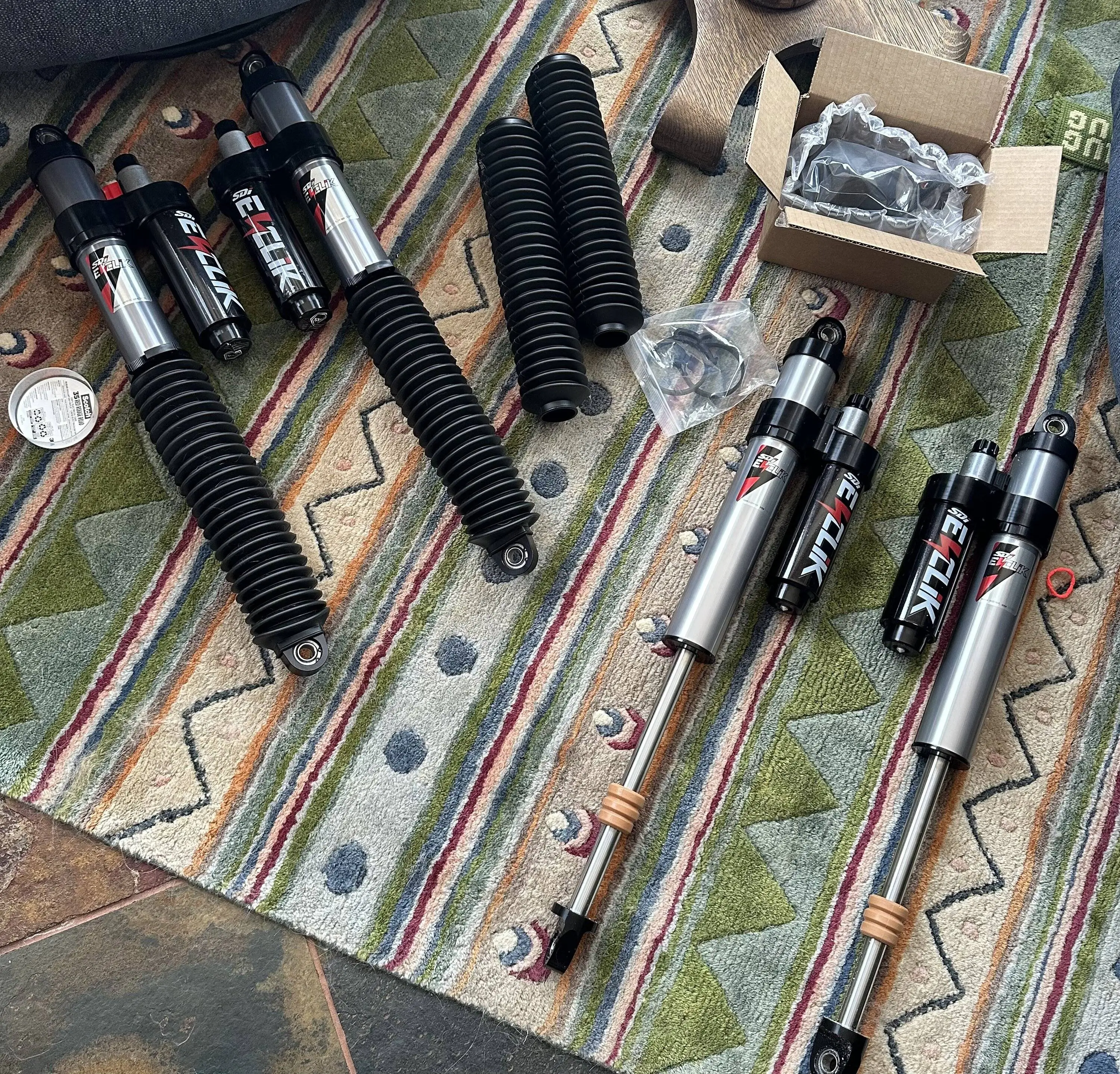

More pictures from before the install. The boots are optional. I drive on dirt roads constantly and wanted to keep rocks off of the shaft.
Jeep Gladiator Shock suggestions IMG_8239
Jeep Gladiator Shock suggestions IMG_8240

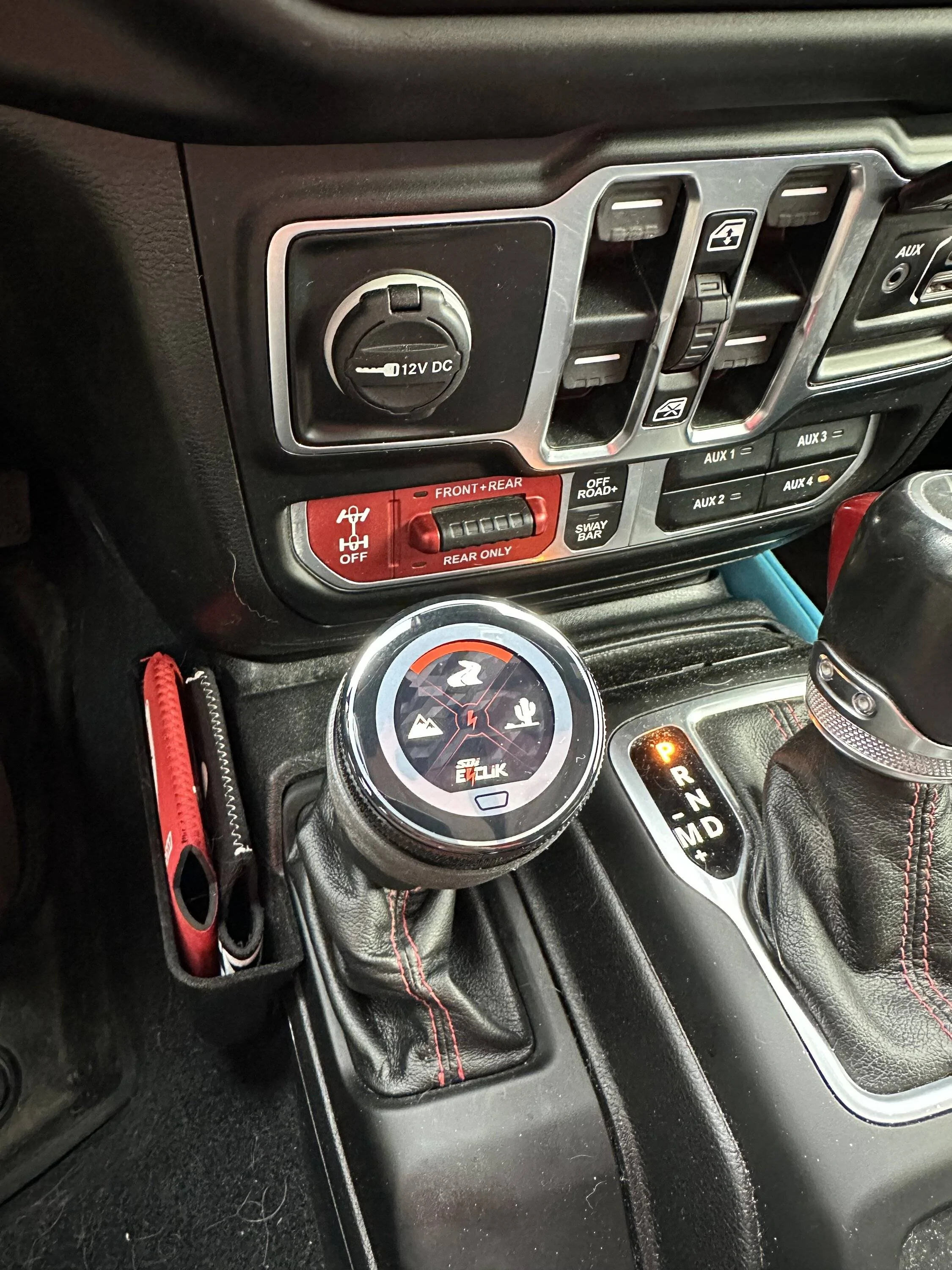

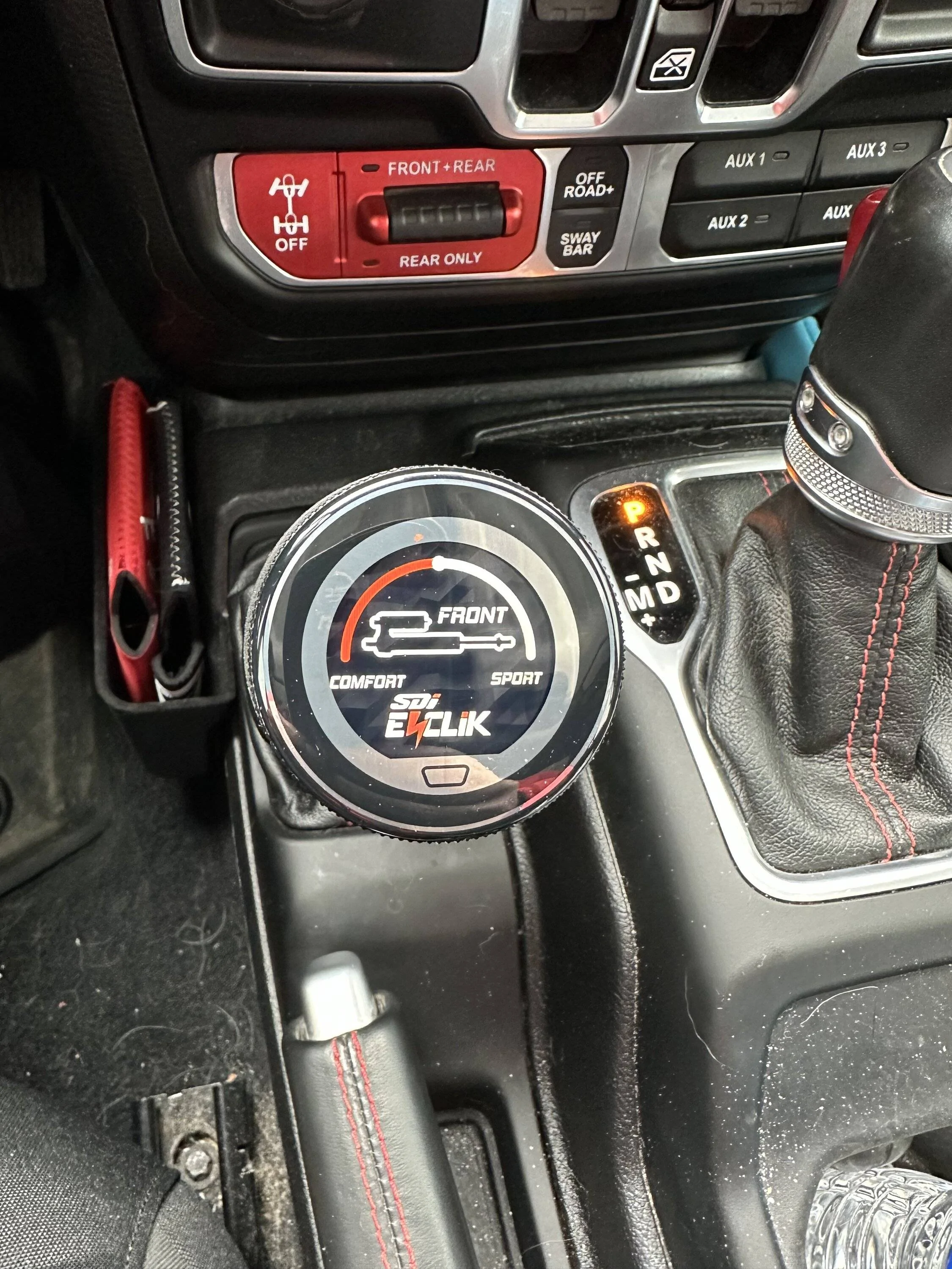

Checkout Eclik. You won’t be disappointed. 2.5 reservoirs with fully electronic management, monitoring, and automated adjustments during driving. I’ve eliminated body roll on the road, and they handle off road like nothing I’ve seen. It’s a completely new vehicle. You have three base modes, road, offroad, and desert/baja. All modes can be adjusted an enormous amount, and front and rear can be set differently from within the cab. I could go on for a long time.
They’re pricey but they seem to be the best of both worlds. Did you buy them directly through SDI? Do they adjust well with like pot holes and whoops at higher/cruising speeds?
I bought them directly. They adjust for absolutely everything. For instance, I did a 100 mile round trip on the interstate yesterday, so speeds from 65-75+ with corners. I in two seconds adjusted front and rear to full sport. I could take corners like my wife’s Volvo. No body roll and just planted. Lots of weight in the bed, they have a setting for rear weight compensation. Just a rotation of the click wheel while driving. Desert Baja mode allows high speeds with bumps and whoops and no bottoming. Corners are compensated for automatically. Outside shocks stiffen during the corner. It’s truly ridiculous. They have their own ECU and inertia/tilt/roll sensor included. The system then connects to the obdII port to get speed, steering angle, braking information, etc. from the Jeep. So as you slow down, they automatically soften. As you get to speeds requiring more safety, they stiffen accordingly.
Another selling point for me is that they have one shock body length, but three internal clip options. Meaning you can change your shock length if you change your lift. I didn’t like the small height windows that fox and king offered. I was worried I’d invest a bunch of $, change the lift a year later, and be left with the wrong length shocks. These are built to order for your lift, but can be changed easily later.

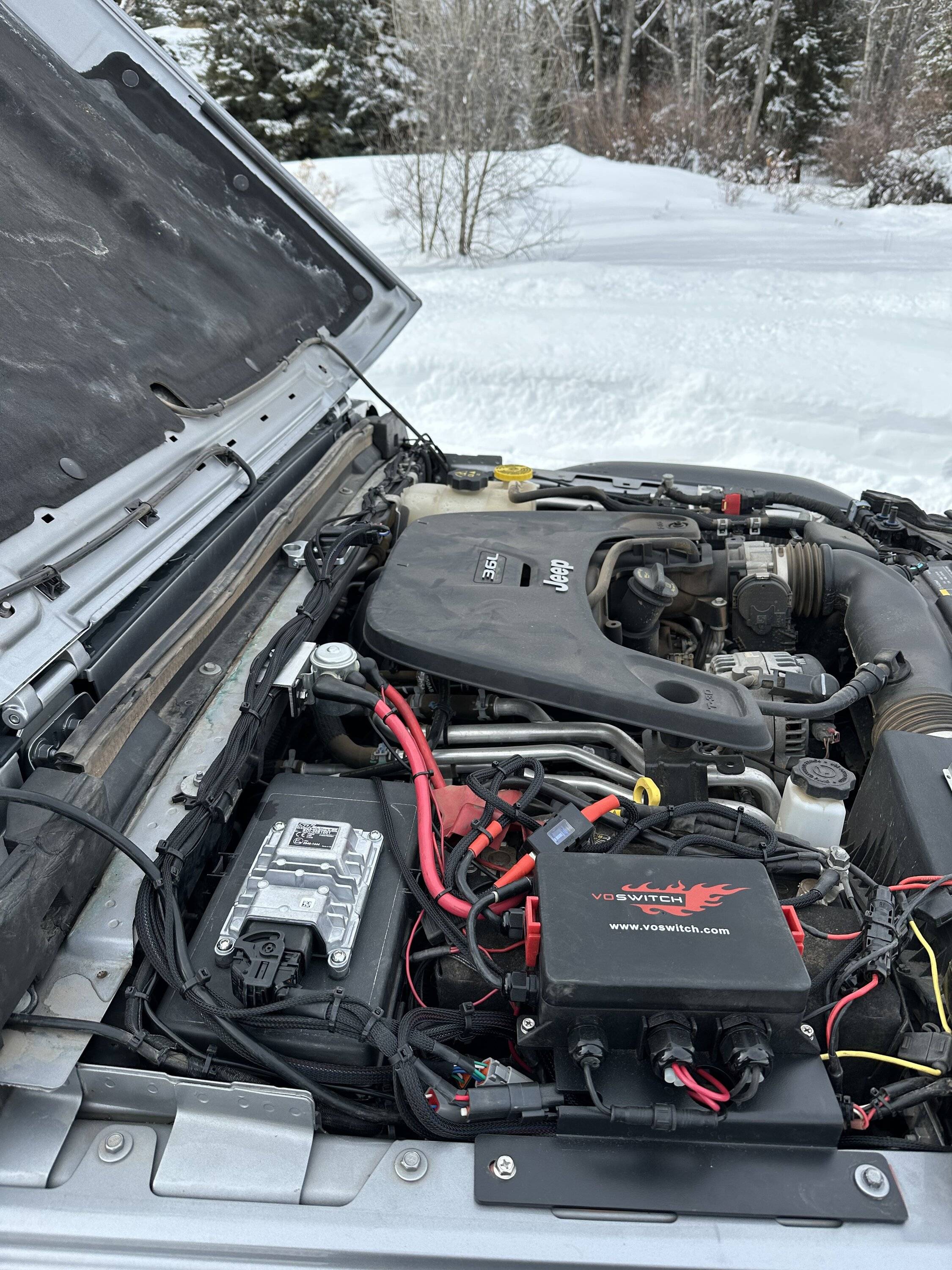

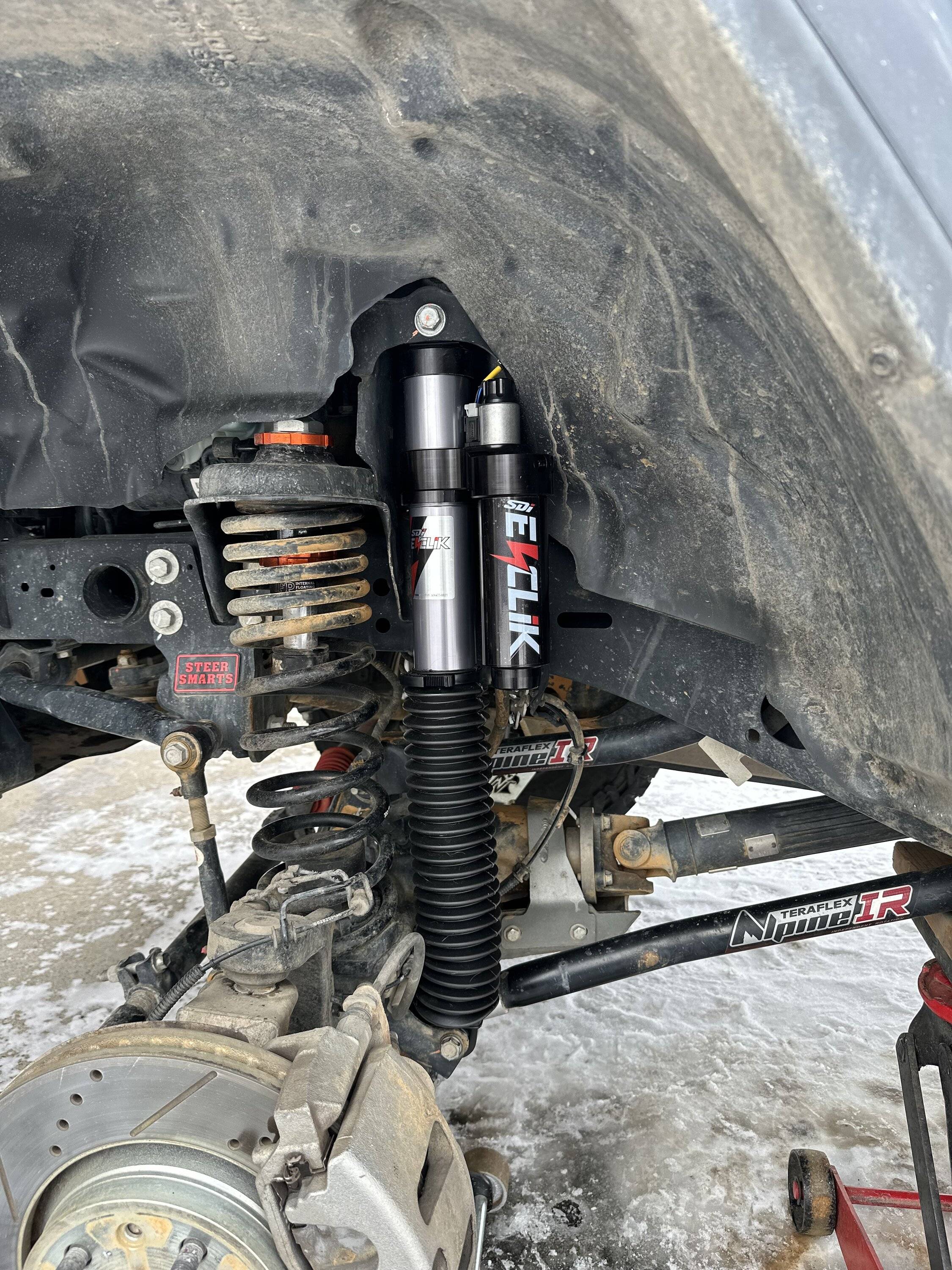

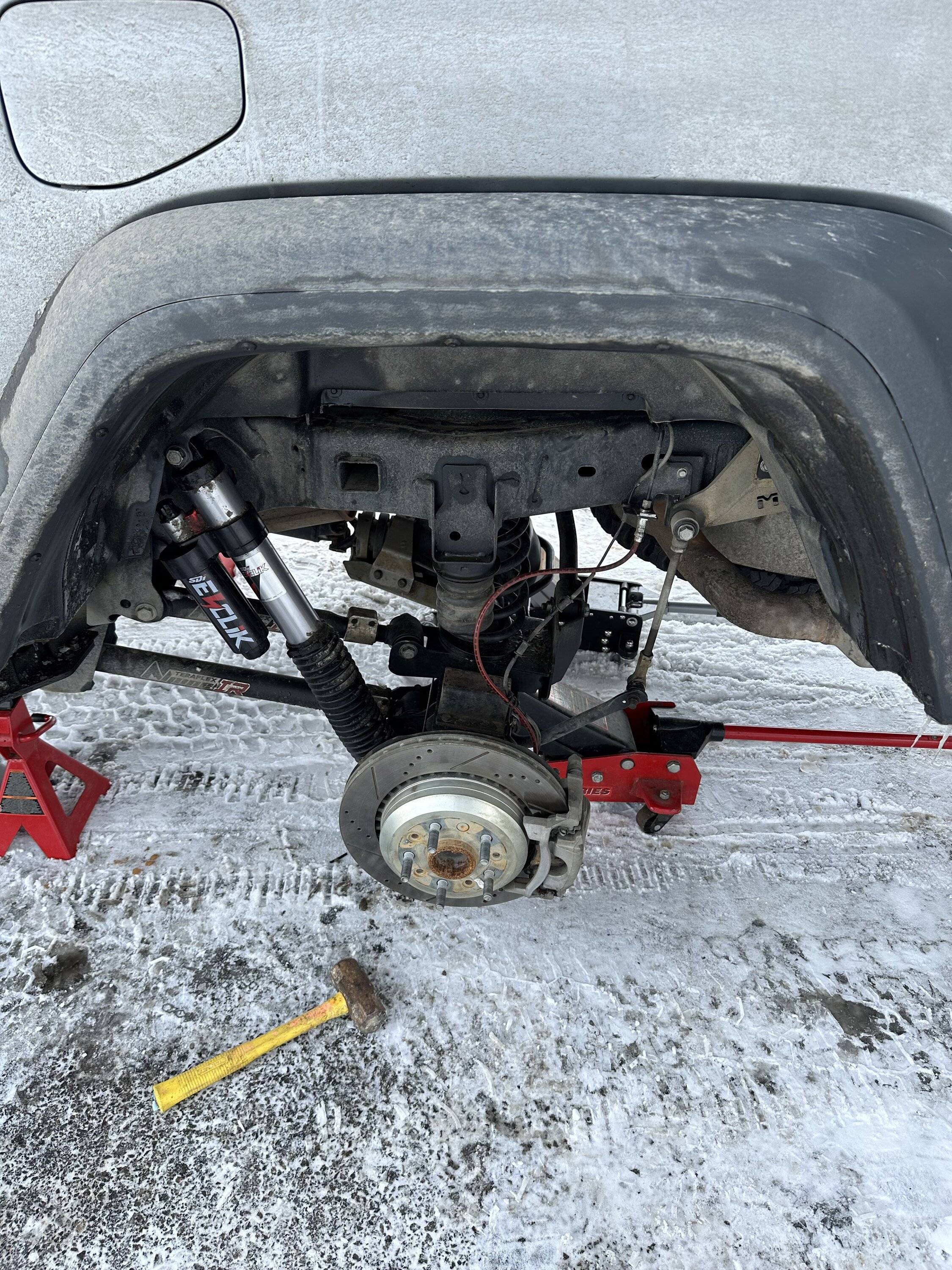

Any time. Cody at SDI spent a ton of time talking to me and answering questions before and after I ordered. It’s a crazy system. Here’s a picture showing the under hood install. The ECU is on the fuse box cover. They provide a template and rubber washers to seal the holes you drill. The intertia/tilt/roll sensor is above the firewall in the center. I installed over two days. I opted to do wiring on day one, and shocks on day two. They separate the harnesses so you can install the touch screen click wheel shift knob, ecu, sensor, etc. power harness separately from shock harnesses.
Jeep Gladiator Shock suggestions IMG_8258

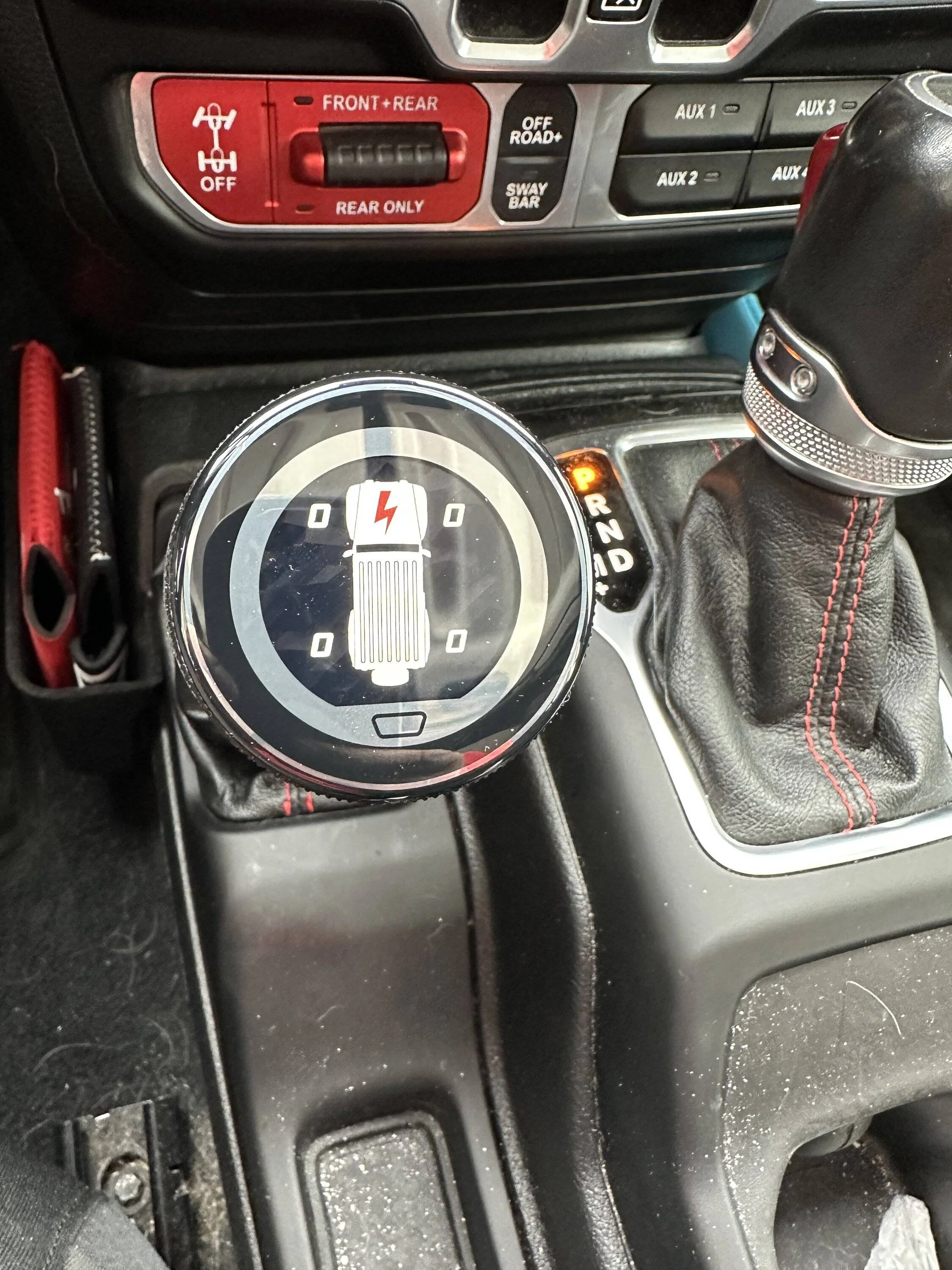

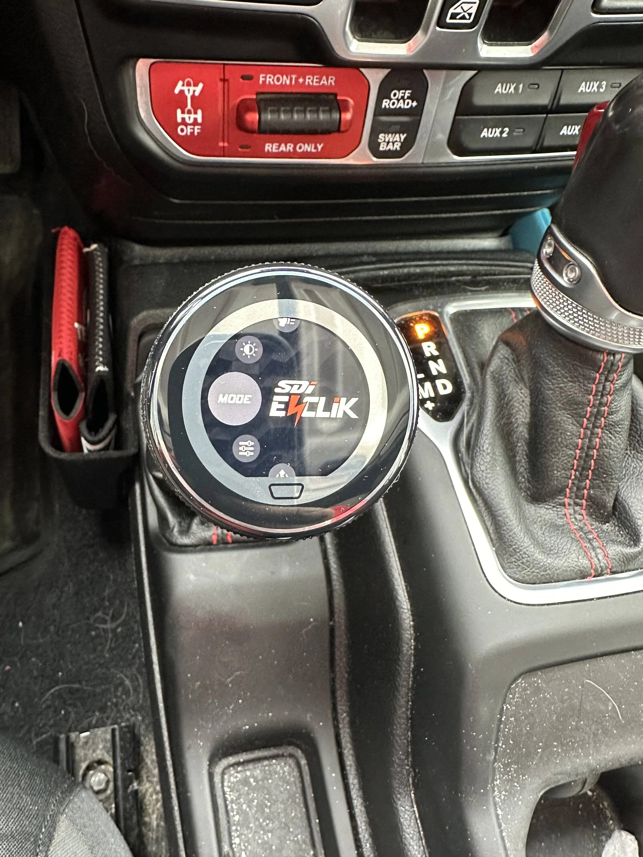

Man, I didn't know they had a TC knob controller. That's awesome!
