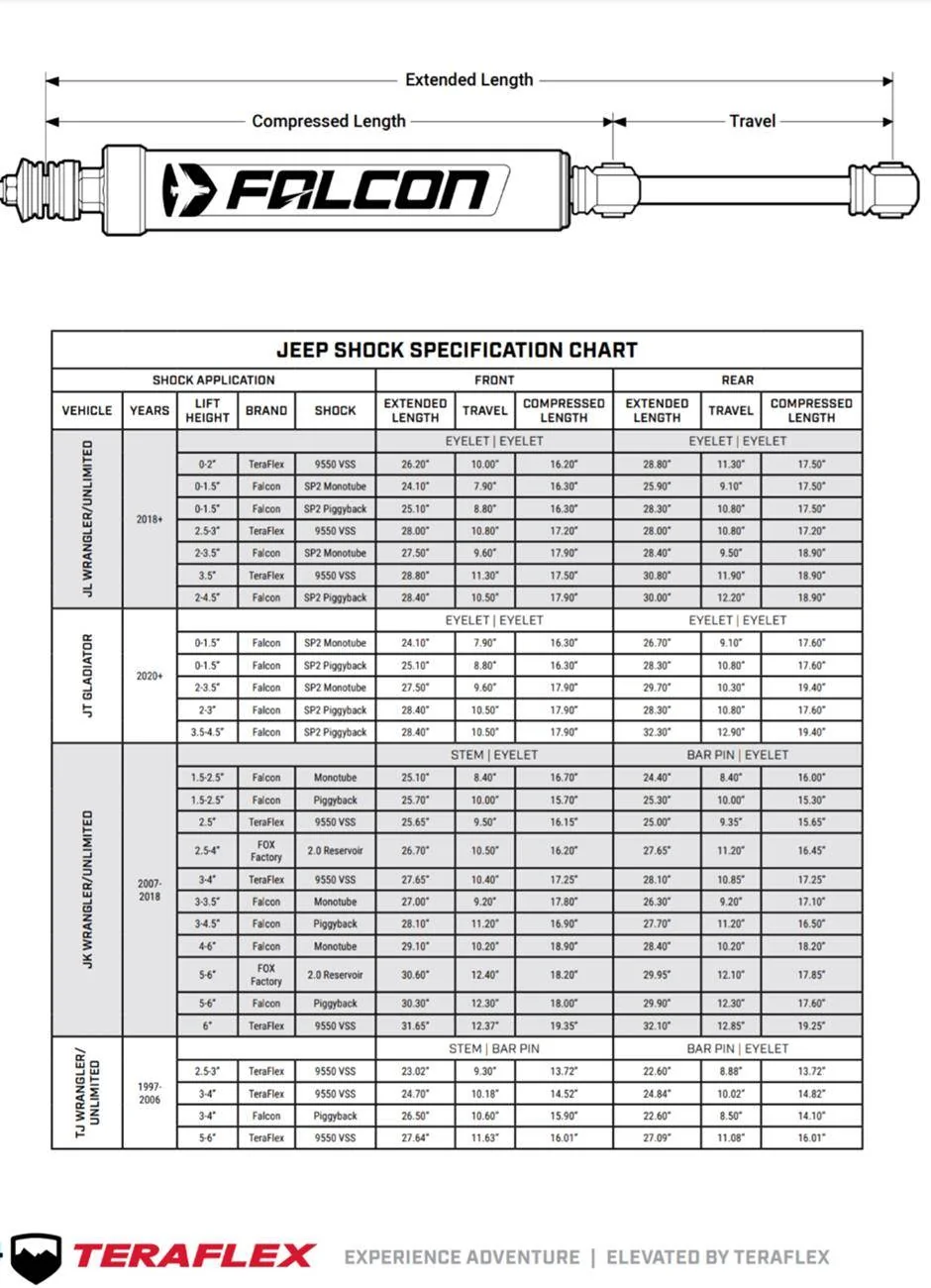

I am running the Falcon SP2 3.3 fast adjust for over 50K miles and they have been bullet proof. Lots of badge of honor trails and the Rubicon trail twice. The best off-road shocks I have every purchased. The quick adjustability really comes in very handy with various loads and terrains. The rears go all the way to 32.3" which will give you full rear articulation with the metalcloak kit. Check out the length in this chart.
I heard that something with the design of the Falcon's means they don't work with the MC lifts. Can you confirm you're using these with an MC TC or GC lift?
No, I cannot confirm. I installed my Falcon SP2 3.3 shocks on a Clayton 3.5" Overland Plus kit. Probably, best to call MC and check it out. Note: the rear extension of these shocks is long, so, it is possible to unseat certain springs at full extension. It is best to install the Teraflex JT rear coil spring retainer kit for approx. $65. I added the retainer kit to my Clayton rear springs.
Thanks, you’d suggested this in a thread about the MC lift so I assumed you were running such.
