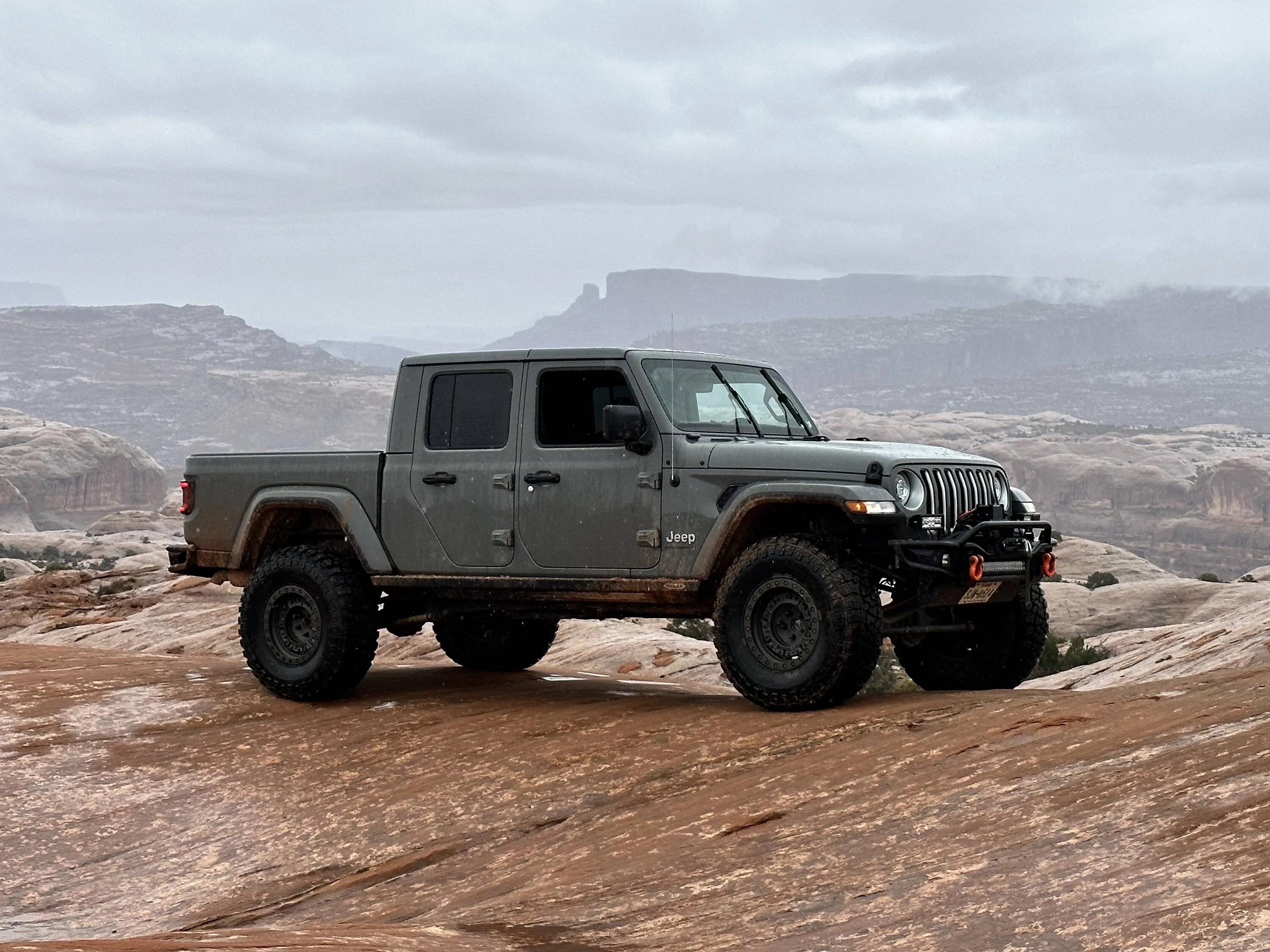

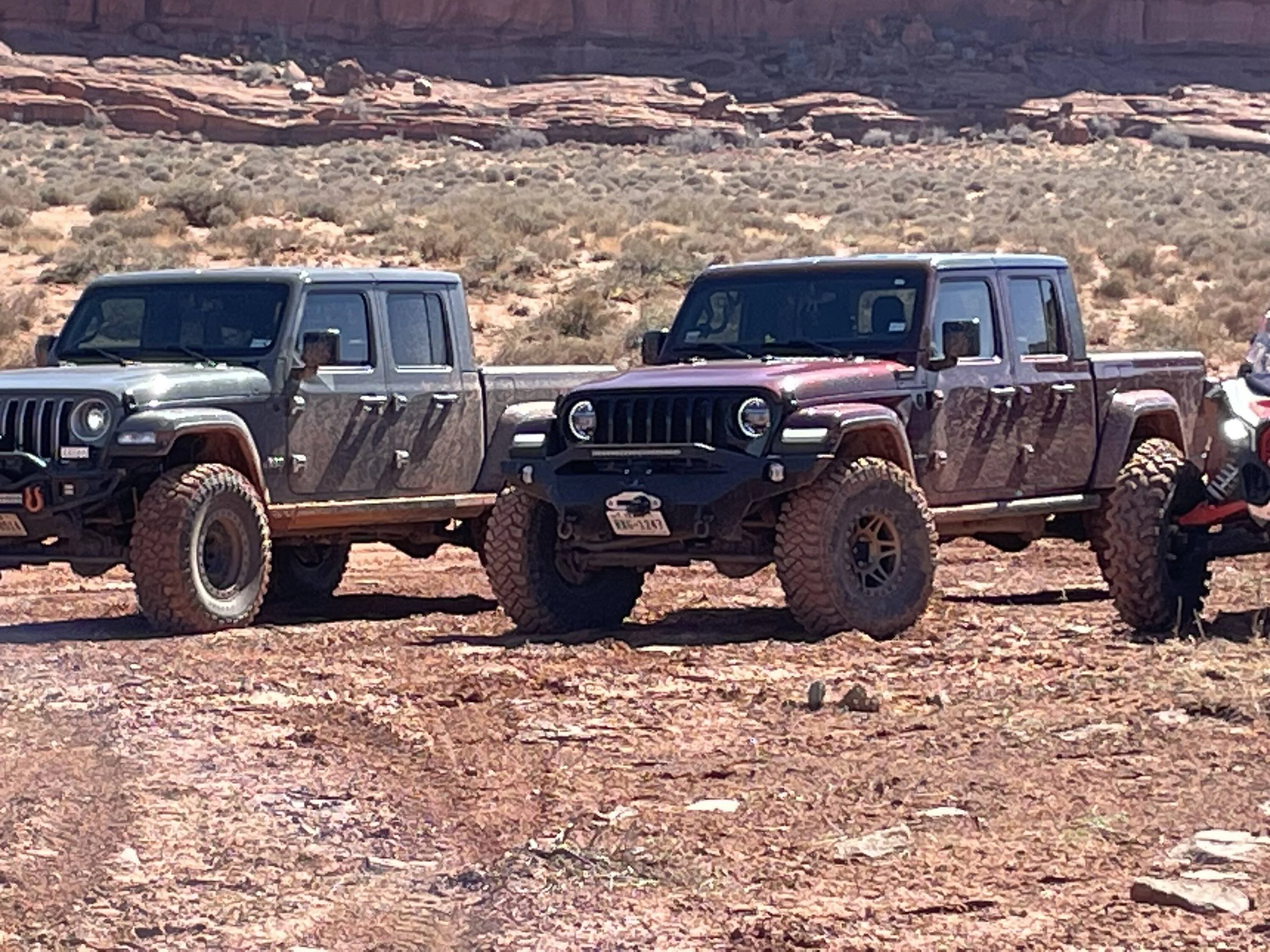

This is his overland and the other is a picture of my gasser next to his diesel.
