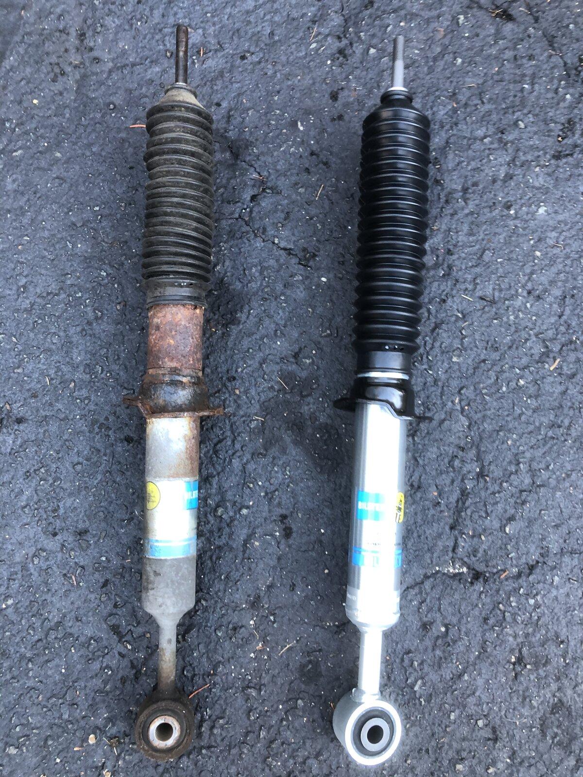

I like the way Bilstein 5100s ride and handle but the steel bodies don’t hold up well to salt used in my area. This is a few year old one next to the replacement on my Tundra. Good news is they are cheap so I just bought another pair.
That is pretty nasty. I'd use anti-corrosive spray in the future.
