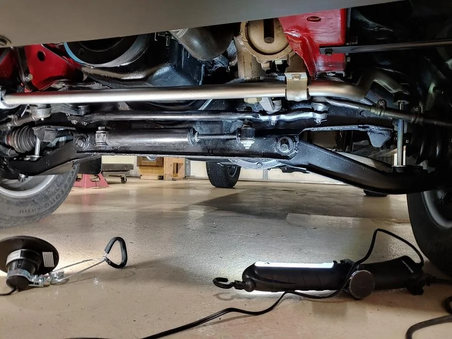

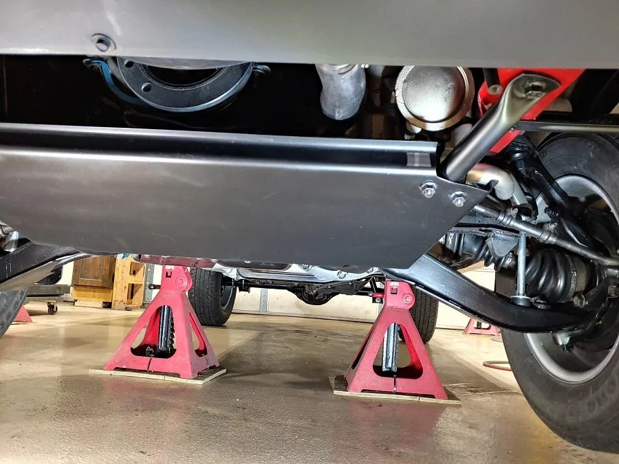

IFS vs. solid front axle - It's not really an argument if you have the stock air dam covering all of that. Plus all of those parts on the Jeep are rounded, not flat like IFS parts.
IFS has things hanging down as well.
The evidence of that is that I am usually the only person laying under the front of their car at a car show wiping the bugs off the lower control arms, front cross member, drag link and other parts under the front of my SX4. I don't need to do that with my JT - at least before I removed the air dam.
The lower control arms of IFS hang down low and are parallel to the front of the vehicle, making them worse than the front of a JT with the air dam. The LCAs on my car have flat fronts. The bars under my truck are rounded, not flat.
It's really a wash because the axle of the JT sits higher than the front cross member on my car that holds the lower control arms but it's prevented from catching wind by the air dam (or even a skid plate of similar shape)
I bet the IFS on my car presents more drag than the solid axle on my JT.
I noticed a drop in mpg when I removed the air dam on my truck.
This catches a LOT of stuff - and the bugs I have to wipe off the fronts of the control arms and other parts prove it -
The only saving factor is the skid plate (adding about 40 pounds) but the control arms and outer steering and suspension still catch a lot of bugs and stuff -
The air dam under the front of a Gladiator actually do a good job of routing the air around the front suspension and steering parts, but when we remove them to add weight, we will lower the mpg.
There's a reason that IFS vehicles have plastic air dams and shields that divert air and make the underside smoother - it all catches air under there.

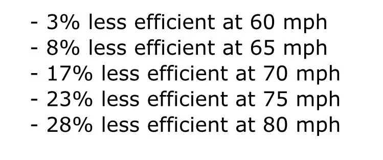

Speed is a big part of it. I’ve never done the math on any of my cars to see if it matches this data from DOE, but I know once I get over 70mph I notice a significant MPG drop.
Add in even slight elevation changes and wind directions along with unnecessary idle time and the average can be significantly reduced.

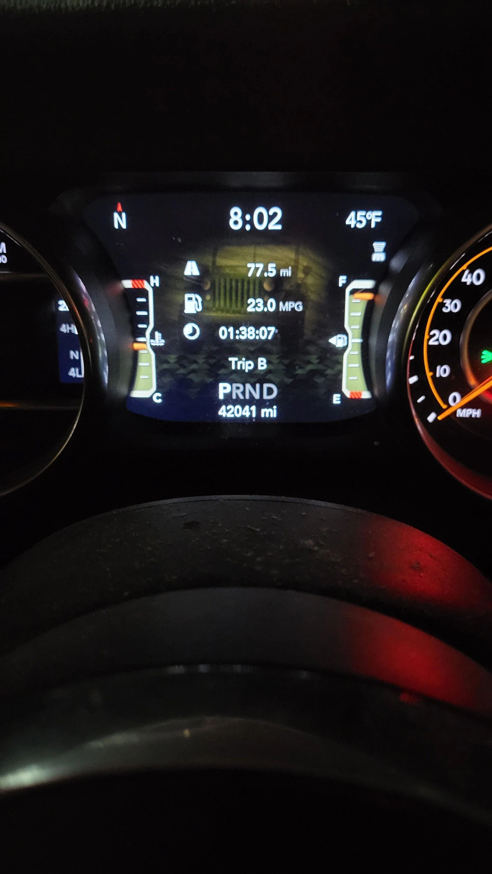

I took this pic yesterday at a red light after a 56 mile trek from my home to Pittsburgh Pa. 46 of these miles was Interstate driving at the cruise set at 74 MPH and the beginning average was at 14.5, Granted at the time of the pic I only have 1001 miles on my stock Mojave Jeep and I took delivery September 1st 2022. The jeep gets driven usually on the weekends mostly rural driving. Or have I not even driven it enough to be concerned of the Avg MPG yet lol.
Stock 2020 Gladiator Overland, Automatic, 18" wheels, 50k + miles, Goodyear Wrangler Radials. My average stays right around 22.7, I normally drive 65-72mph hwy.
