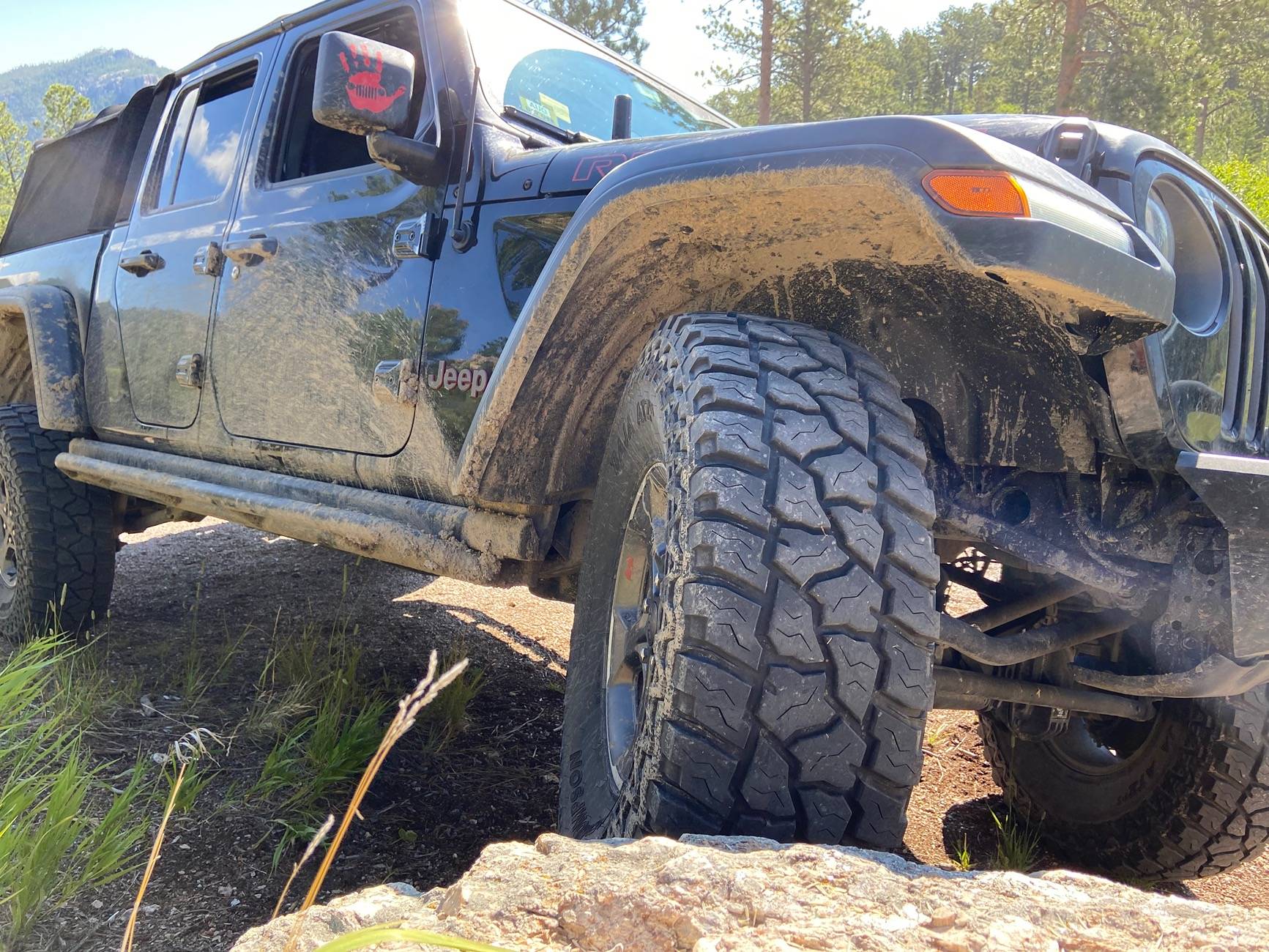

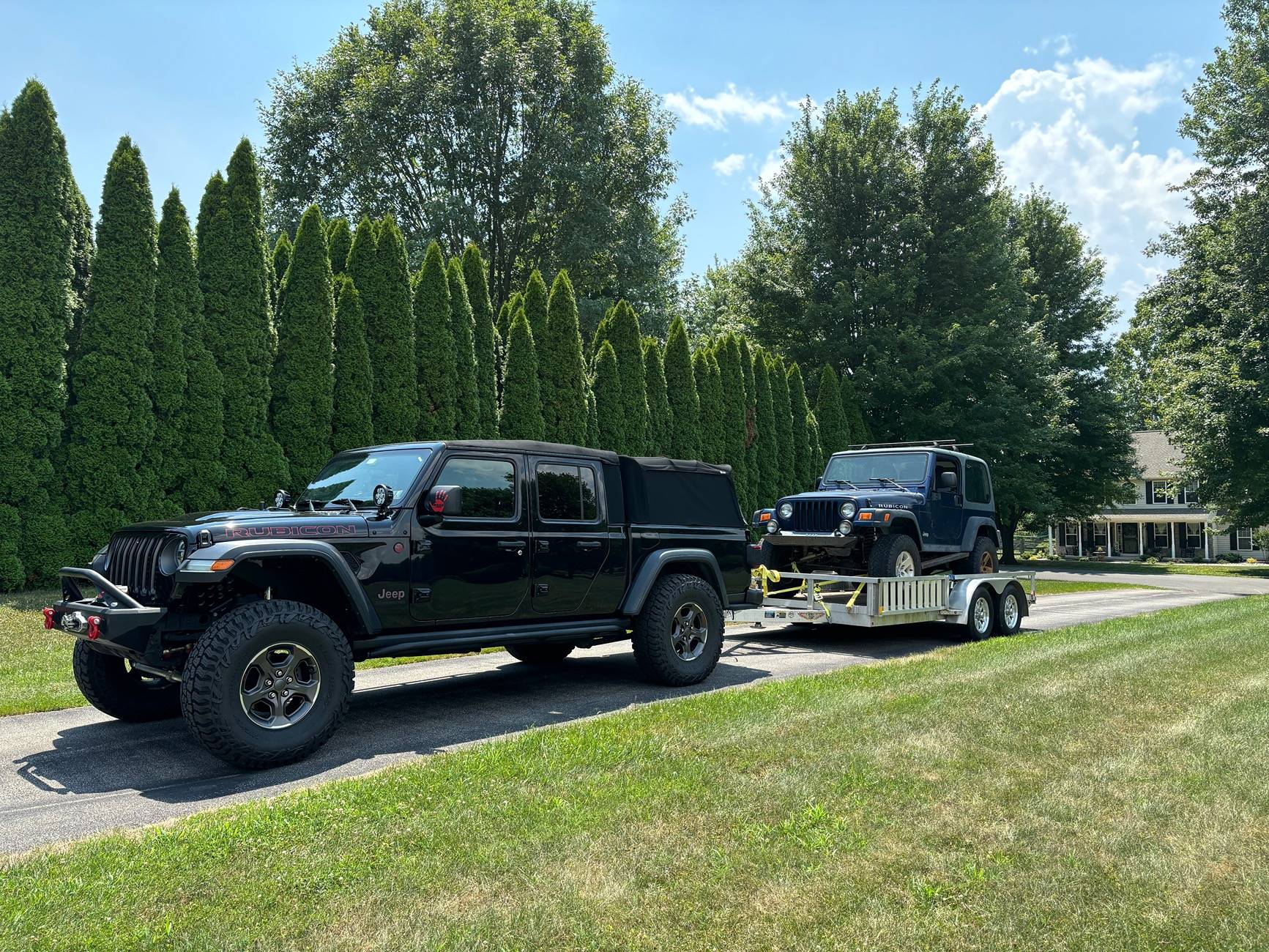

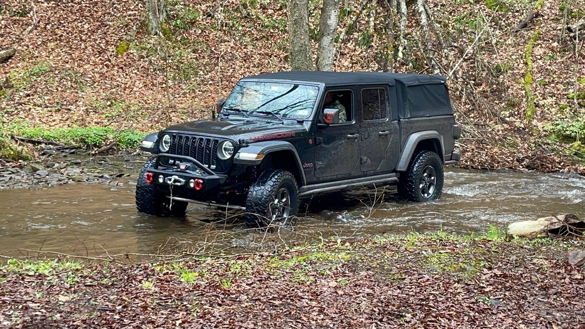

37s 5.13 gears, and stock axles on my 2020 Rubi. Weighs about 5,900. 45k miles - towing, camping, hunting, offroad parks, trips from PA to Yellowstone, etc. and no issues with axles. I spent my money on upgraded steering, shocks and control arm joints - all shot at 40k miles

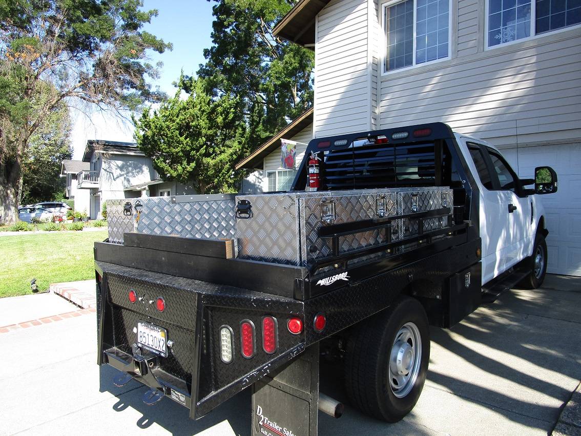

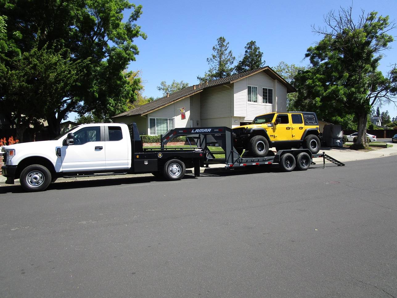

When I was in Moab put my willys on the scale and was at 6400 lbs with out vacation stuff. Just normal gear and me and my wife in the jeep so I decided to put the jeep on a diet.
Two new aluminum bumpers saved 135lbs off the weight.
When we got back I told my boss that it was time to replace my Tundra with 370K miles witch I have owned for 15 years.
They agreed put this time I decided to go big and with some of my cash pick up a 2020 F250 with only 10K miles with a flat bed and then found a goose neck trailer.
No more trying to jam 4 week of my wife's vacation gear in the back of the Willys.
