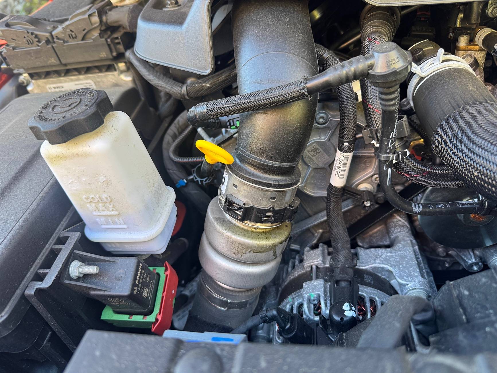

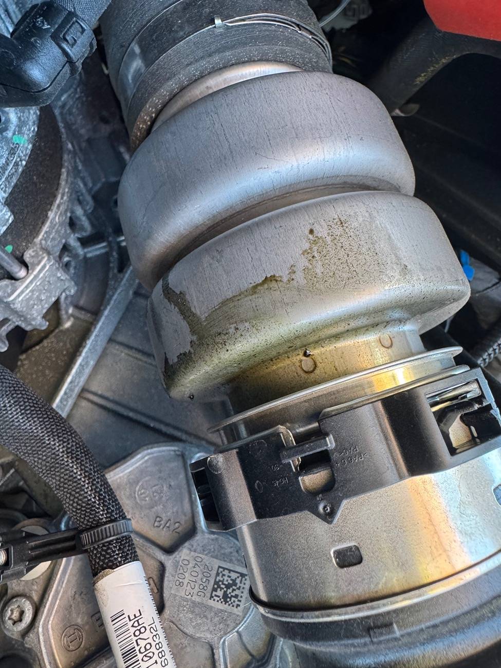

Hi all - first diesel, first jeep, and I have no knowledge of what this is. It looks like it runs from an intercooler or similar.
Can someone educate me please, I tried searching the forum but genuinely have no idea what to search for? Just under 10k miles.
No smells outside, nothing abnormal, just happened to pop the hood today and saw it.
Jeep Gladiator Slight oil sweat, not necessarily a leak question. IMG_3077
Jeep Gladiator Slight oil sweat, not necessarily a leak question. IMG_3078

It is likely a bad seal in the charge tube. It's pushing pressurized air and oil past the seal, take it to jeep and try to get them to replace it under warranty.

Thank you very much, will do that this week.

Might just be a couple of oil drops from an oil change, when refilling oil. You will feels lost of power if that charge pipe leaks.
