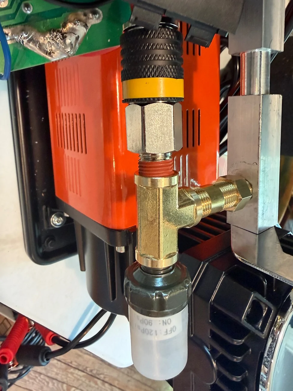

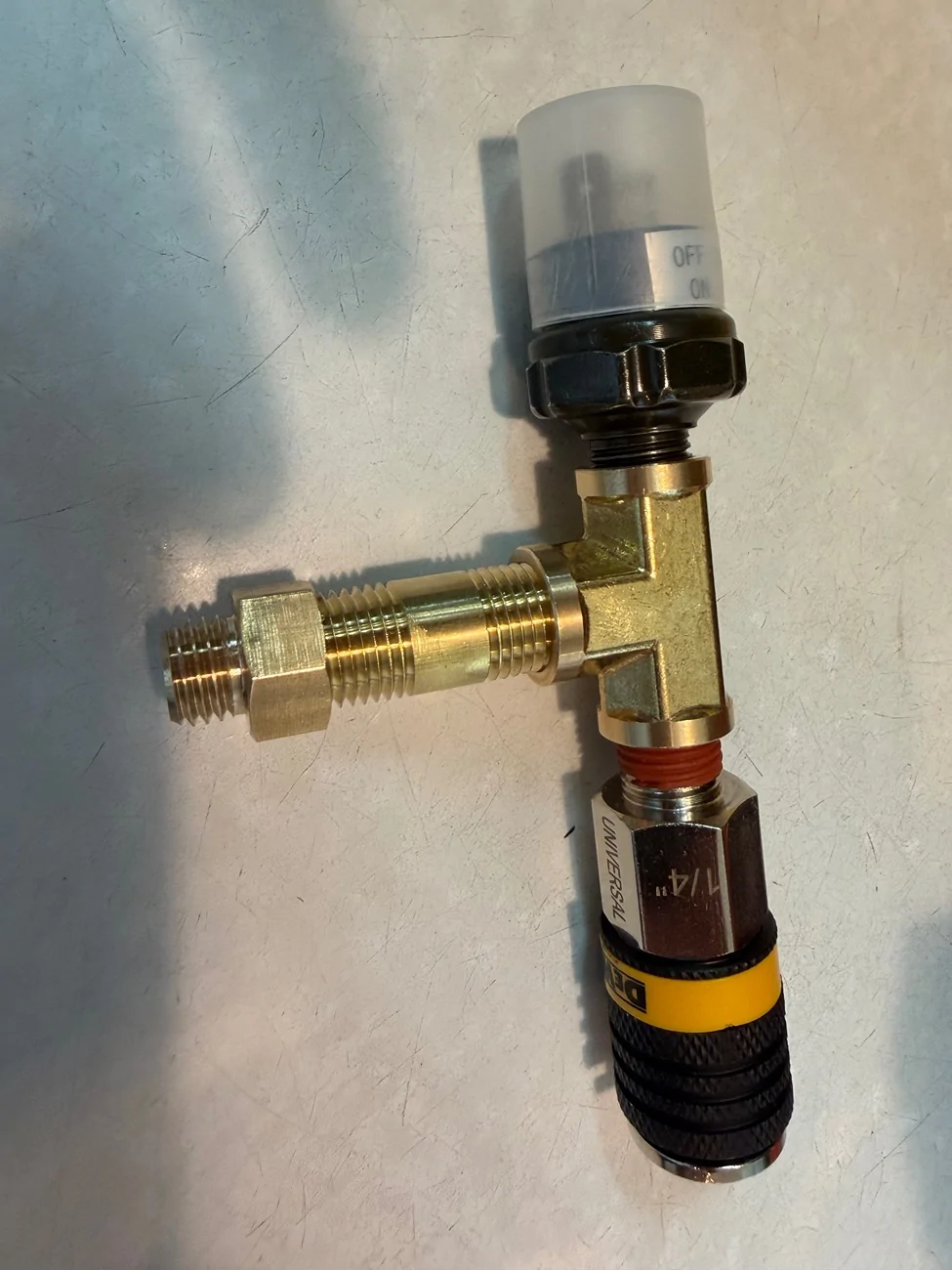

So.. I got all the parts and prior to my VT/NY trip this past weekend I hoped to have it lined up but...
There's a couple issues.
The hose that attaches to the "manifold" didn't use a 3/8" fitting like some of the variations out there but instead uses a fitting that is common in China but not the US. Fortunately, Bezosmart sells an adapter that will take it to 1/4".
The next problem is the manifold would not seal to the adapter. This may have been a manufacturer error or it could very well be a Steve-related issue. Regardless, I could not get a seal on it. Since I was headed out of state and would be wheeling, I snagged another variation on the same off Bezosmart in case I needed it. (I didn't).
To note: There is some sort of sealant/glue applied to the threads by the factory. I heated it lightly and used a 90 degree pick to remove the remnants before installing the new setup.
A friend' has a machine shop so we're going to play with the manifold and either JB weld and re-tap or just 86 it and start over from scratch with a new piece of aluminum. I'll update accordingly.
Parts needed to make this work:
Manifold adapter: https://a.co/d/0iMD2yKx
Brass nipple: https://a.co/d/04q0itt6
Brass T fitting: https://a.co/d/00fH4nKw
Universal quick connect: https://a.co/d/09I68V0i
90-120 pressure switch: https://a.co/d/0bOvNYzG
You''ll need to extend the switch wire off the board and connect to the pressure switch and make a small pigtail to go from the pressure switch to the on/off switch. I used a step bit to drill through the plastic trim piece on the compressor and stuck a rubber grommet. I also wrapped the lead/pigtail with Super 88 tape to prevent the wire from chafing.
Test fit of assembly
Jeep Gladiator Snagged a cheap double piston Vevor inflator... for $88 including shipping. IMG_1342
As connected. Had it not leaked this would be a solid little setup.
Jeep Gladiator Snagged a cheap double piston Vevor inflator... for $88 including shipping. IMG_1343
