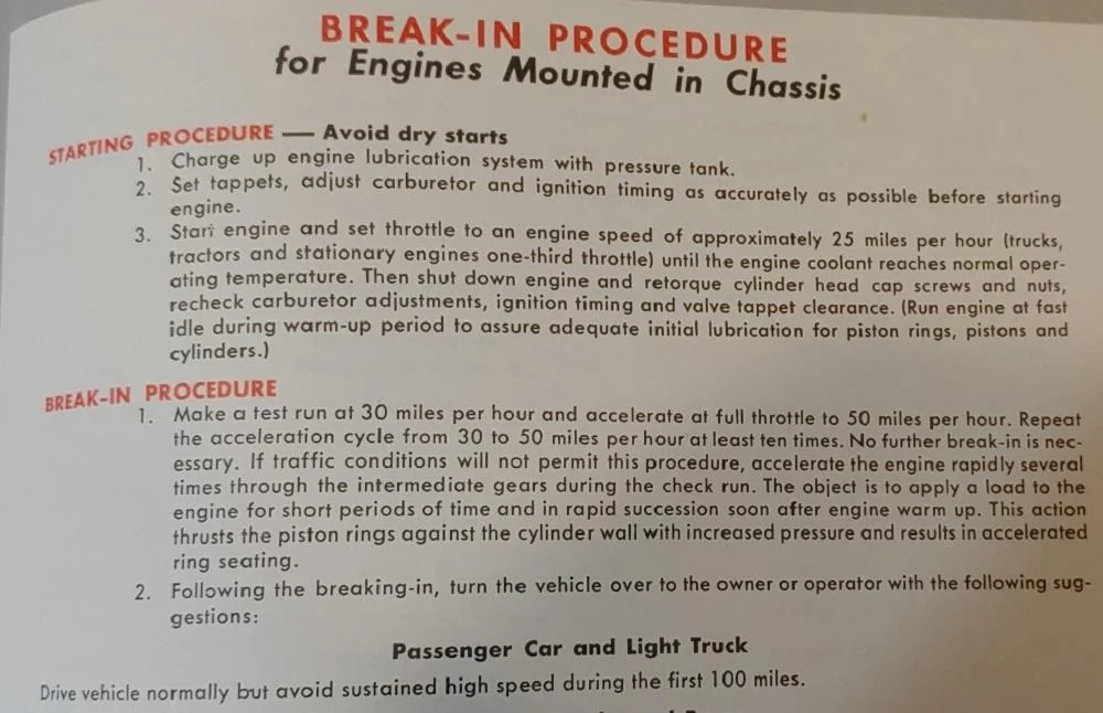

Same issue with current Yamaha outboards, people don't run them hard enough and the rings do not seat and you end up with fuel diluted oil, very hard to convince people to take a brand new motor and run it hard at wot when it is brand new.
Too much telephone game here.
There are "dino oils" that prevent wear, or have better wear protection than synthetics, so the fact an oil is synthetic or not isn't the issue. It's the whole package - the base AND the additives together that determine wear protection.
There are non-synthetic oils that actually prevent wear better than many synthetic oils. So blaming it on synthetic base is baseless. People over-simplify or read things wrong, or just plain take a tidbit from here or there and draw their own conclusions.
Running at WOT doesn't break it in - LOAD does. You need to load the engine, not just run at high RPM. And high RPM actually does more harm that good on an engine not ready for it.
Full throttle in itself is no load and does not force rings against the cylinder walls.
It's the PRESSURE DIFFERENCE between above the rings and below the rings that forces them out. Look at how rings are "cut". An end view is NOT a square. There are chamfers, notches, etc. Those are designed to take advantage of the differences in pressure above and below and the directional movement of the rings to force them out against the cylinders.
LOAD the engine - high loads, not high RPM. NOT lugging, but don't wind it up tight with no load either. Load not speed.
I could paraphrase here myself - it's really hard for REAL factory-trained mechanics with decades of engine experience to convince others the facts about break-in and oils.
People are reading things on forums that other people read and tried to repeat - but it's not exact word-for-word and like that old telephone game, by the time it reaches the 5th copy it barely resembles the original.
Sorry, but I really have to laugh when I have the books from famous engine builders over the years, a fellow who worked on helping to develop the Isky cam, a guy who worked for GM, and a book from Perfect Circle themselves about break-in, oils and so on.
If everything is right - the cylinder wall finish, the cylinder wall being a perfect circle (machined properly and with after-market builds, use of torque plates and so on) and if the rings are right - the gaps proper, etc. then the rings are seated and broken in within hours. Not months, not thousands of miles (it used to be about 2,000 miles but that would be the very most even today, more like 500 or less today)
Some of this is older as ring technology and machining methods have improved over the years to drop the number of miles down substantially.
The last 4.0 I built used NO OIL in the first change period - about 500 miles, and no oil at all after that - about 3,000 miles. I do not have to add oil between changes, 33,000 miles later the plugs still burn almost white and clean. I simply drove it out of my shop, followed the procedure I was taught in college and that was echoed in the books I have, and drove it like normal. Not afraid to load it, no high RPM without load, no lugging.
This is from a company that makes piston rings and other engine parts -

Shadowpapa - re running a new engine under load, the way I learned it was that you needed high manifold pressure. That means a load with a large throttle opening. You want to maximize combustion chamber temps and pressures. This is because rings work by allowing combustion pressure behind them and that forces the rings against the cylinder walls.
It isn't the spring tension of the rings that creates most of the seal. Its the pressure itself.
You want this pressure intermittently so the rings seat and then everything has a chance to cool, then repeat.
Ironically that's why running the car on a race track is an ideal break in regiment. High load for a short time followed by idle or overrun. Then heavy load again. In contrast to pulling a trailer at highway speeds which is long intervals of high load.
Yes, that's pretty much what the graphic I posted was indicating. It's the difference in pressure - high load, high combustion pressure compared to below. That flexes the rings. I mentioned the shape or profile of the rings because I have another graphic that shows how ring shape works with the pressure to flex the rings out. The rings generally speaking aren't a square profile like in the 40s and earlier. They are designed so that the pressure differences between top and bottom, behind the ring compared to the outside, that is the force that seals.
High RPM itself, taking it out and just winding it up doesn't cut it. So going down I70 at 6,000 RPM won't do squat to help the rings, but loading it up and backing down - that's the break-in process.
Most books do say no trailer towing for xxxx miles. Vary the speed, no sustained idle, no sustained high speed. Yeah, take the thing to the track.
