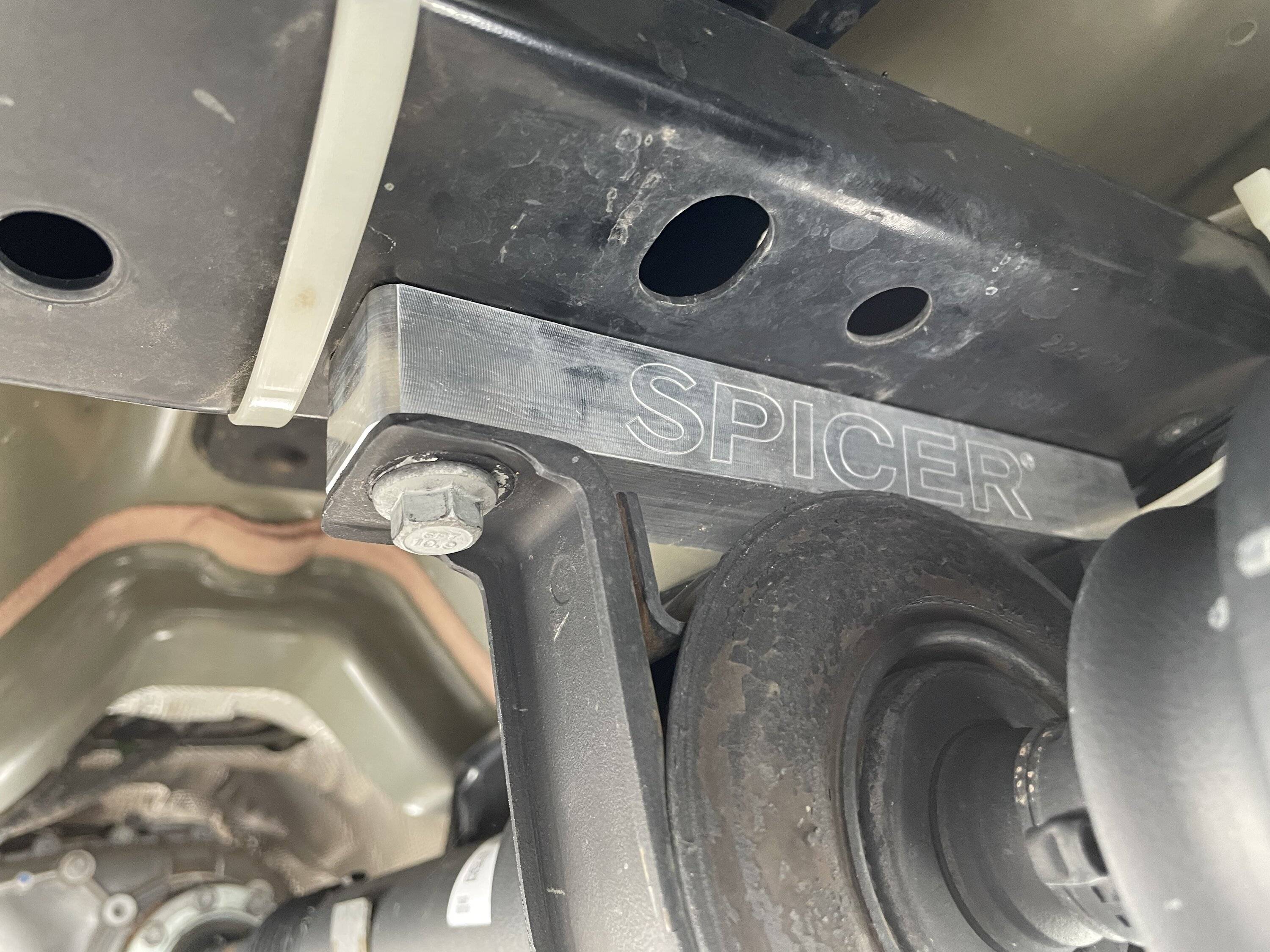

Install the spacer with supplied bolts, 25 ft lbs of torque and blue loctite.

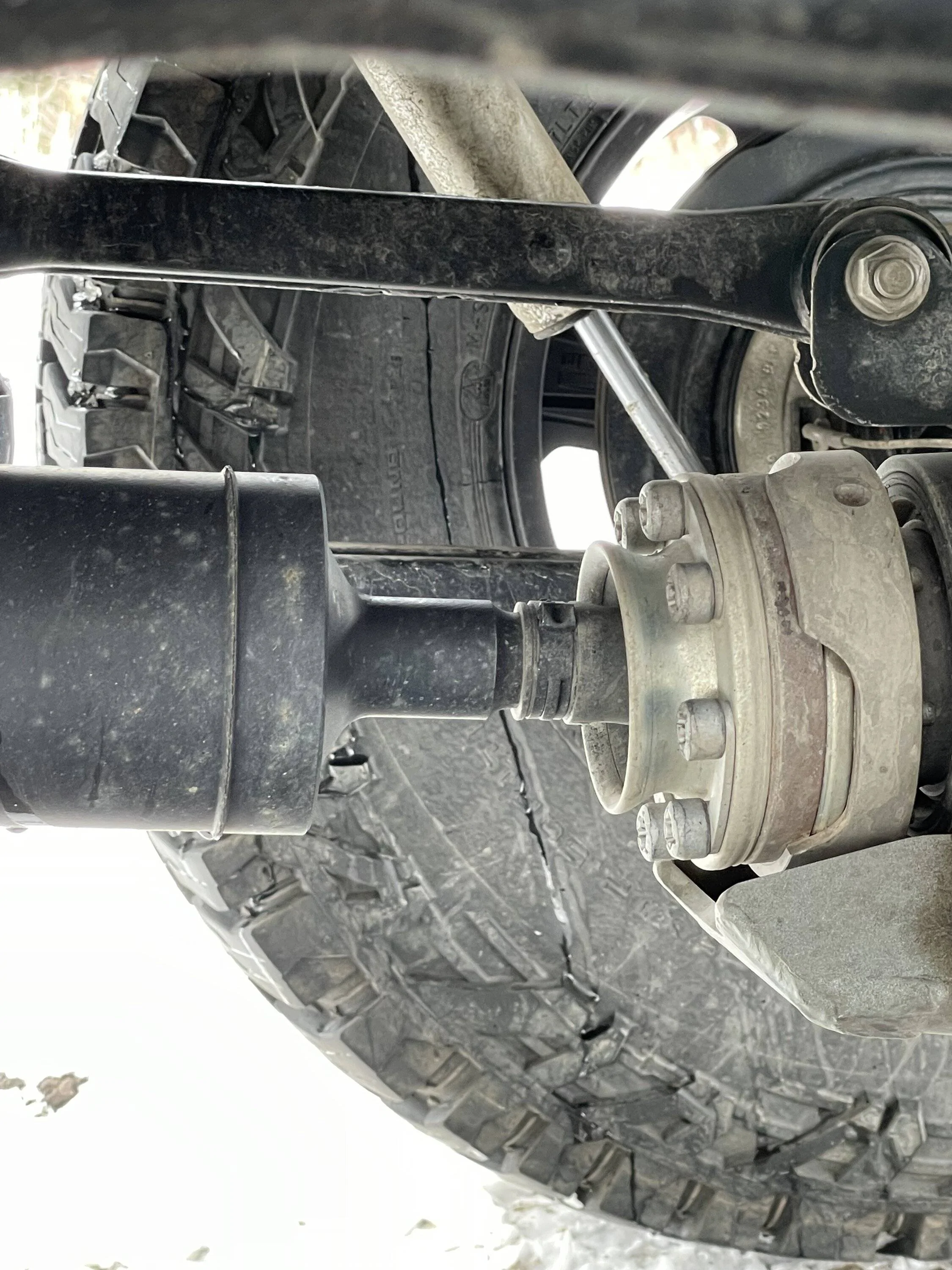

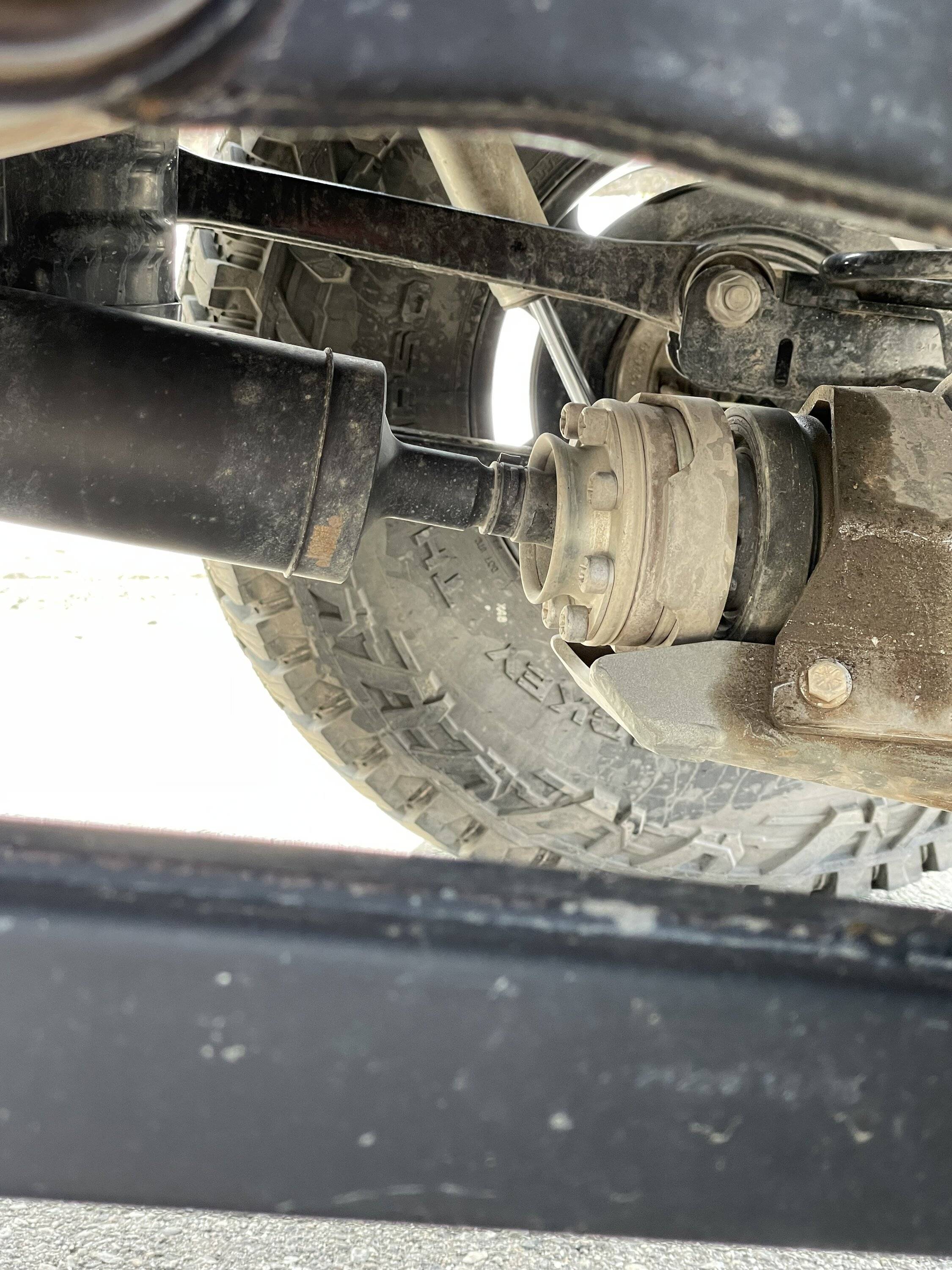

The first picture is bad, then after the spacer, a little less bad. This was a 4.5” lift, and a long time ago before putting in a heavy duty Dana driveshaft and adjustable control arms. But this shaft never failed. I still use it for a trail spare.
