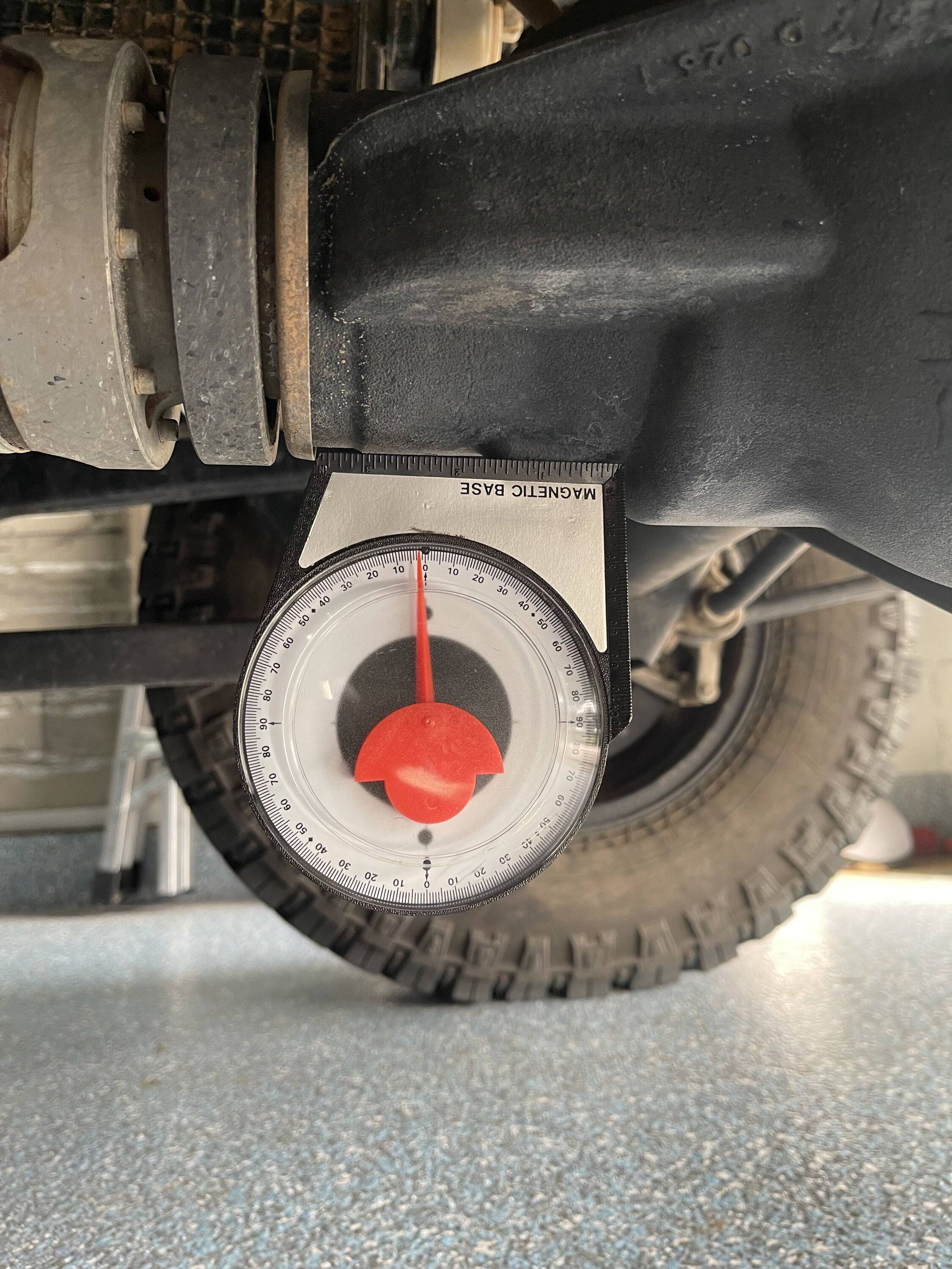

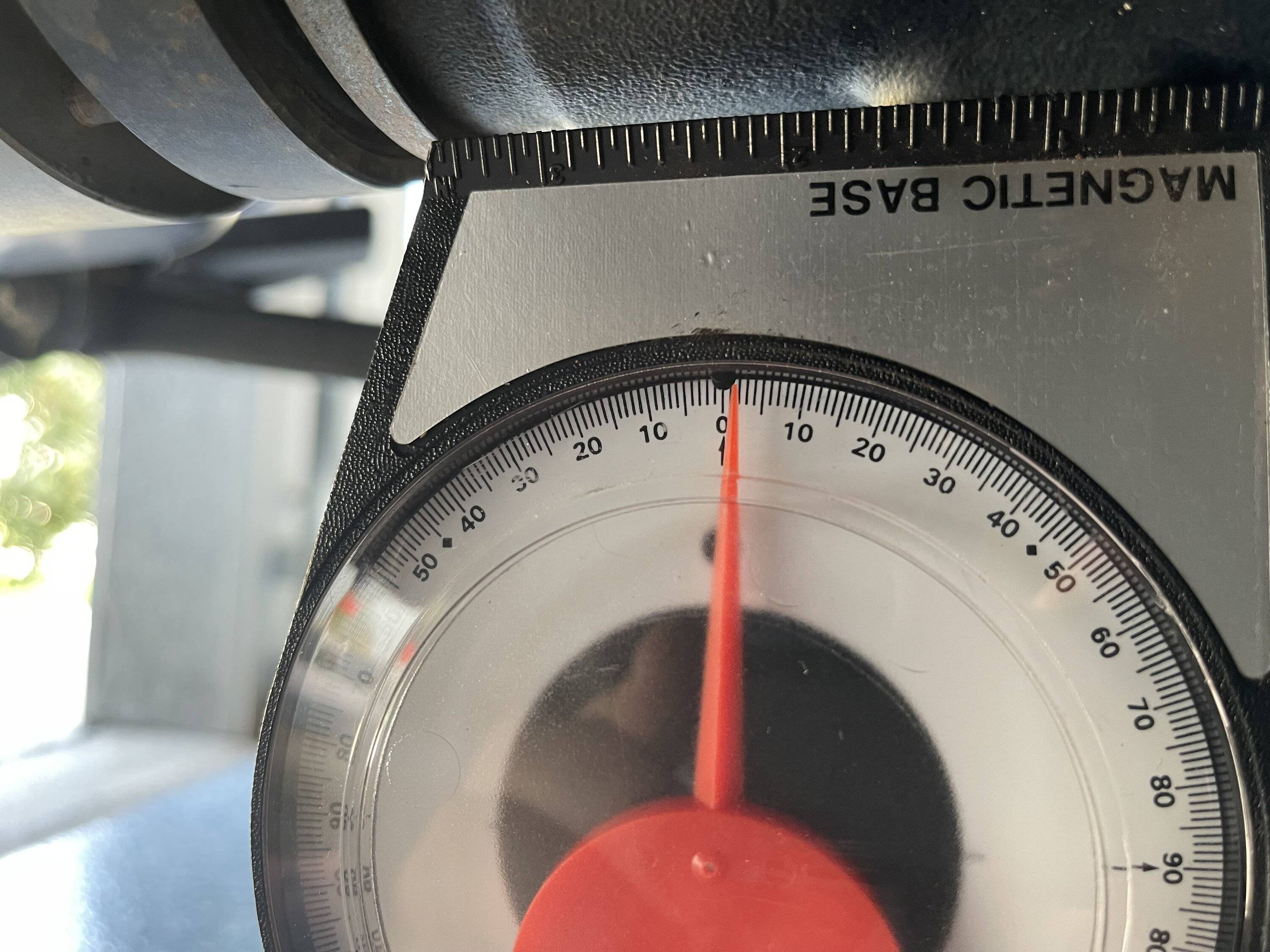

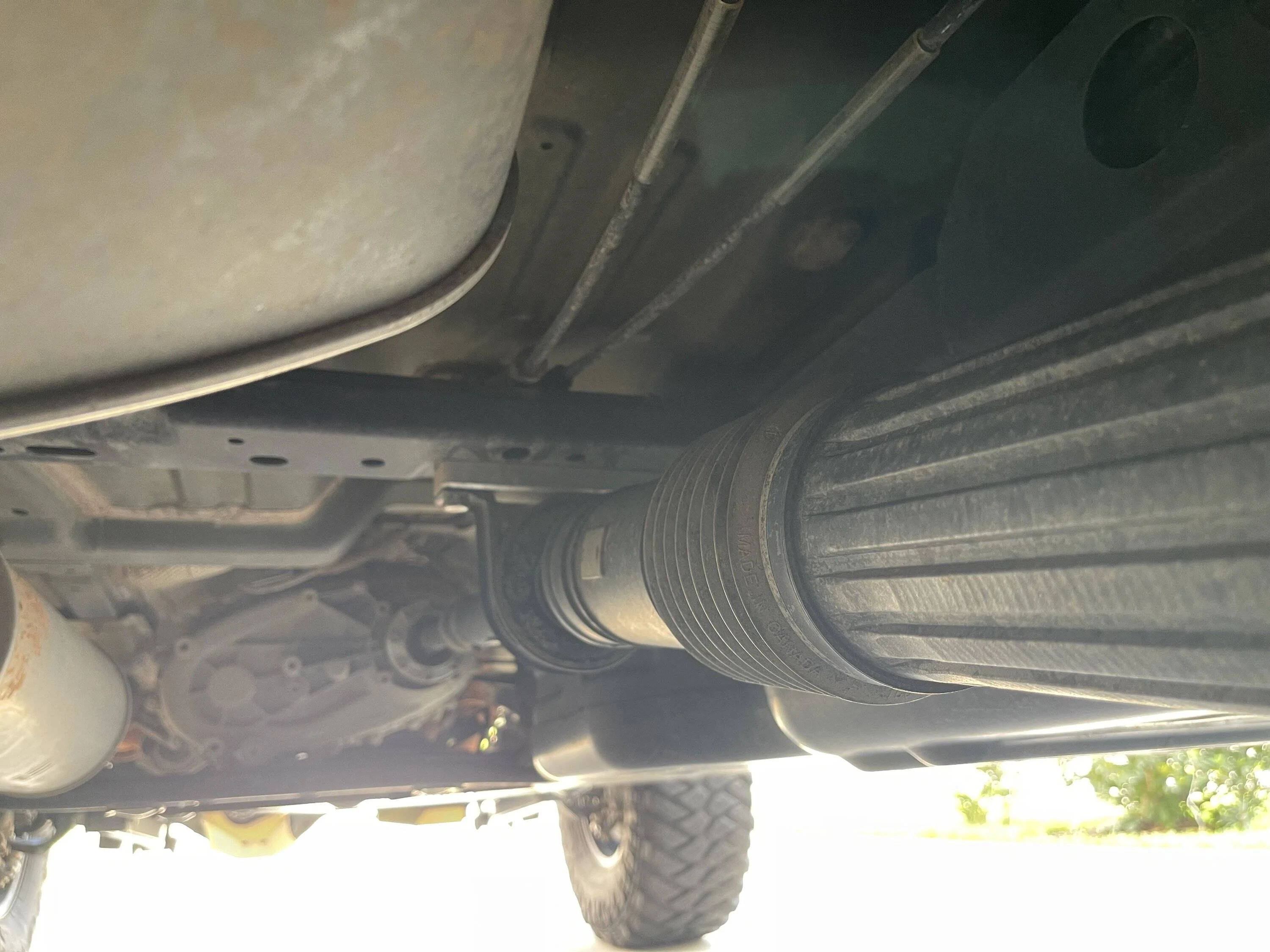

3.5 lift with stock arms and rock jock carrier spacer. No issues or vibrations in 10k+ miles.
stock Mojave
Jeep Gladiator So let’s talk about driveshaft spacers IMG_6212
After 3.5” lift
Jeep Gladiator So let’s talk about driveshaft spacers IMG_7486
Jeep Gladiator So let’s talk about driveshaft spacers IMG_7487
stock Mojave
After 3.5” lift
This is a solid point as well. The drive shaft angle isnt just the carrier. Its also the dif angle that’s effected by the control arms. ??
