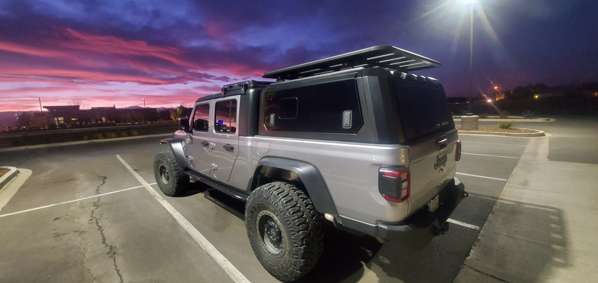

I tried with the used patagonias and they wouldn't fit. I also am rubbing on my mudwidth bumper and switching to a stubby.

I really like the looks of a carrier on the bumper
I have a bed rack that's coming in today so I might just go on top like the Colorado and Tacoma people do
This is interesting as well, I wonder if I could adapt it to the JCR rack I bought
https://rebeloffroad.com/rebel-off-road-xplor-bed-rack-tire-mount-gladiator-JT/
This is how I have mine mounted but with Road Armor's system instead of Rebel's. The nice part about this is that the spare fills otherwise unused space over the bed. Bumper mounted wasn't an option for me because the extra length meant I wouldn't fit in my garage anymore.
