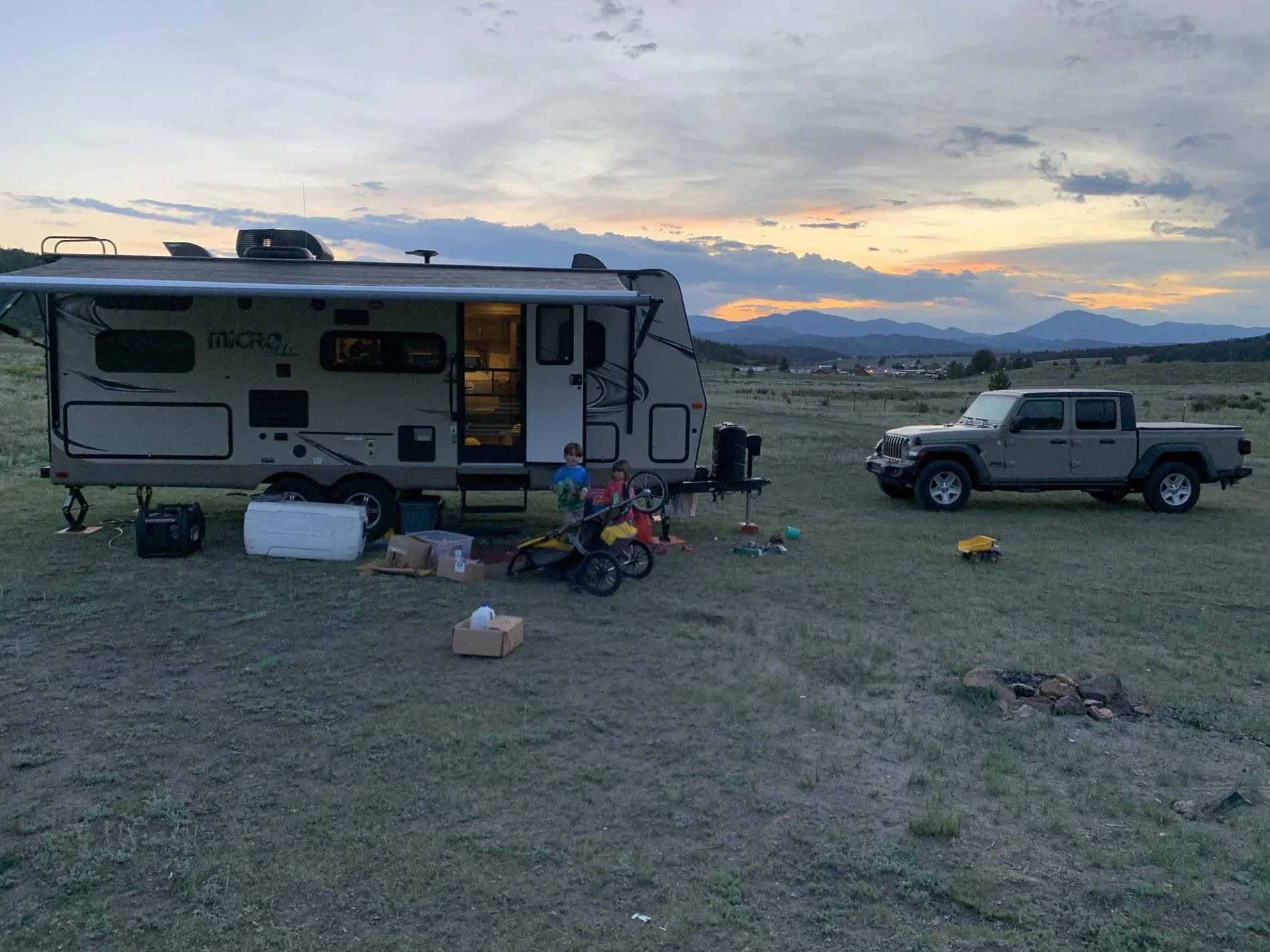

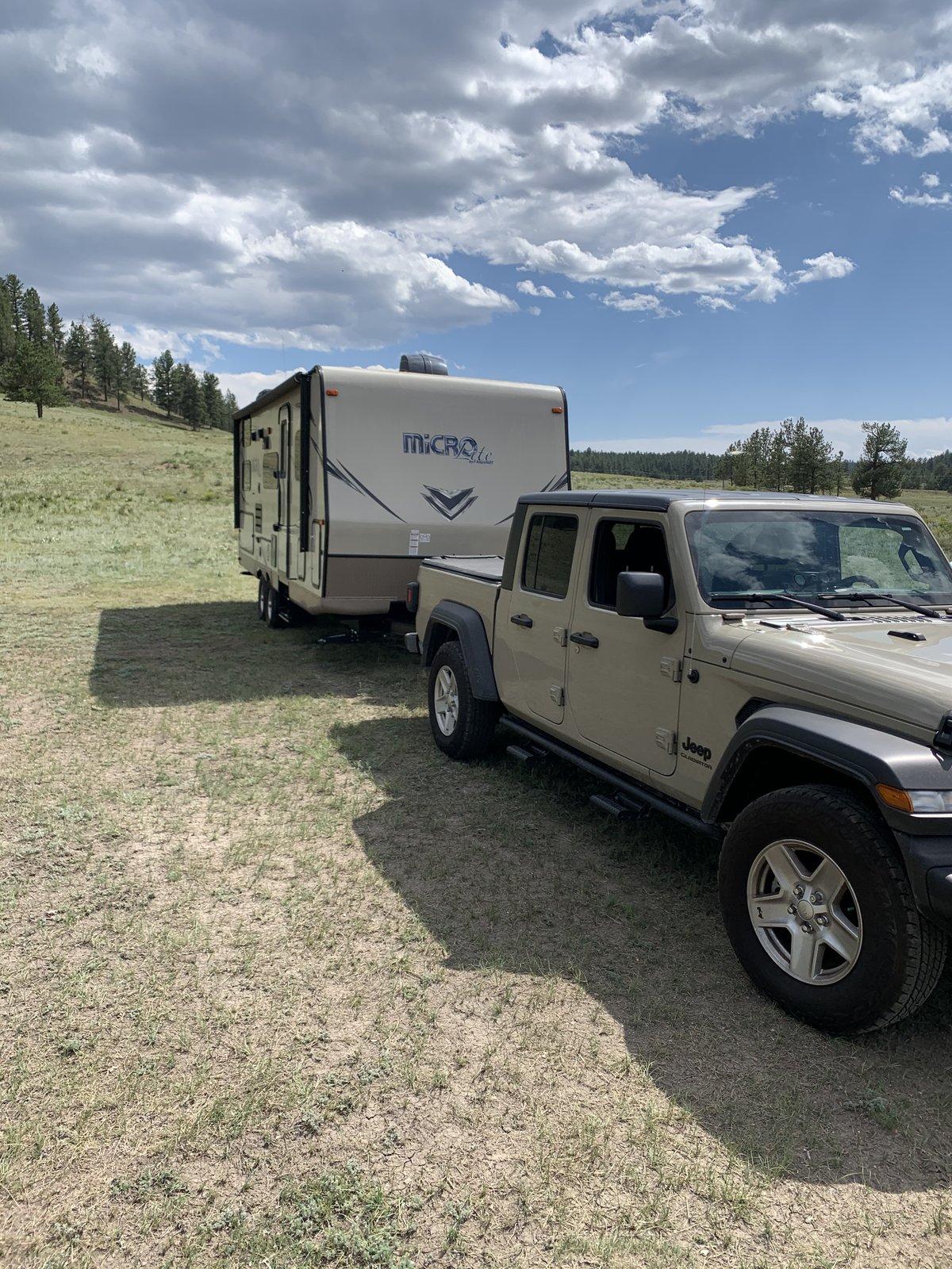

Just landed in Colorado from Asheville, NC. About 1,400 miles. Jeep was loaded with my two small kids, dog, generator and tools. Trailer dry is 5,300# with added accessories and had about another 600-700# loaded. Max tow with Curt Spectrum. Just turned 6k miles on the Jeep. Took it slow and steady. Stability is definitely not like a full size, but the motor and tranny are awesome. Traded my super duty to get back into a Jeep, no regrets. If I towed more often, I would definitely downsize the trailer. We will be camping in the same spot for a few months, so the extra space is worth it though.
I have a trailer that is roughly the same weight. Would I have any problems pulling it through the Asheville mountains with a max tow Gladiator? There are some sites there we are looking to visit
