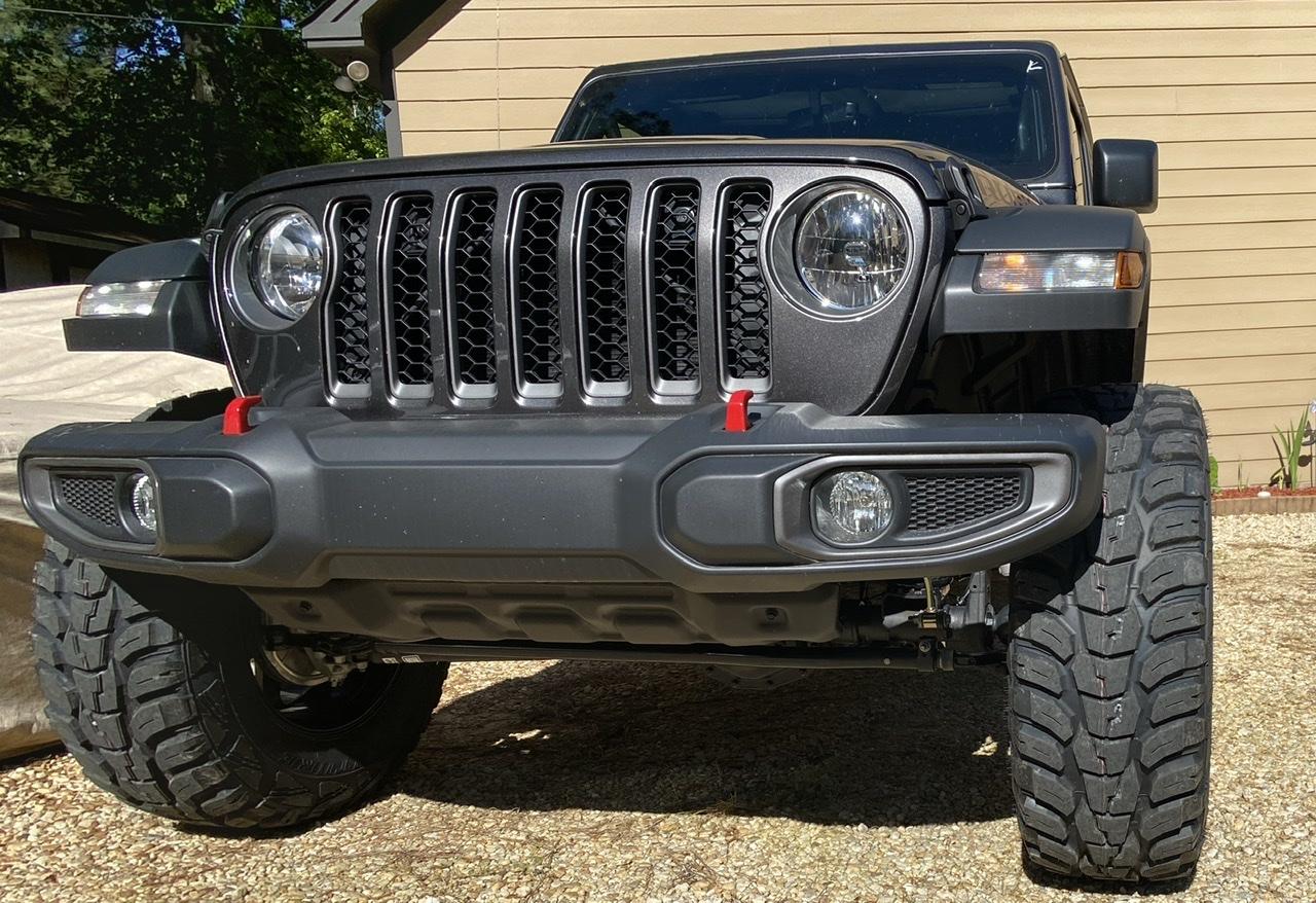

I find it easier to understand exactly where a tire will end up by using offset measurements rather than backspacing. Stock wheels are +44 (millimeters). This is 44 mm inset from the centerline of the wheel (which would be 0 offset). Negative offset wheels are more outboard. Offset is independent of wheel width. If you want to know where the tire will end up, compare the new wheel’s offset vs. the stock wheel. Wheels between 8-9” wide are considered most reasonable. Good luck, and get ready for a lot of confusing info...
For reference, this is what 37x12.50 Ridge Grapplers look like on +11 offset 8.5” wide wheels.

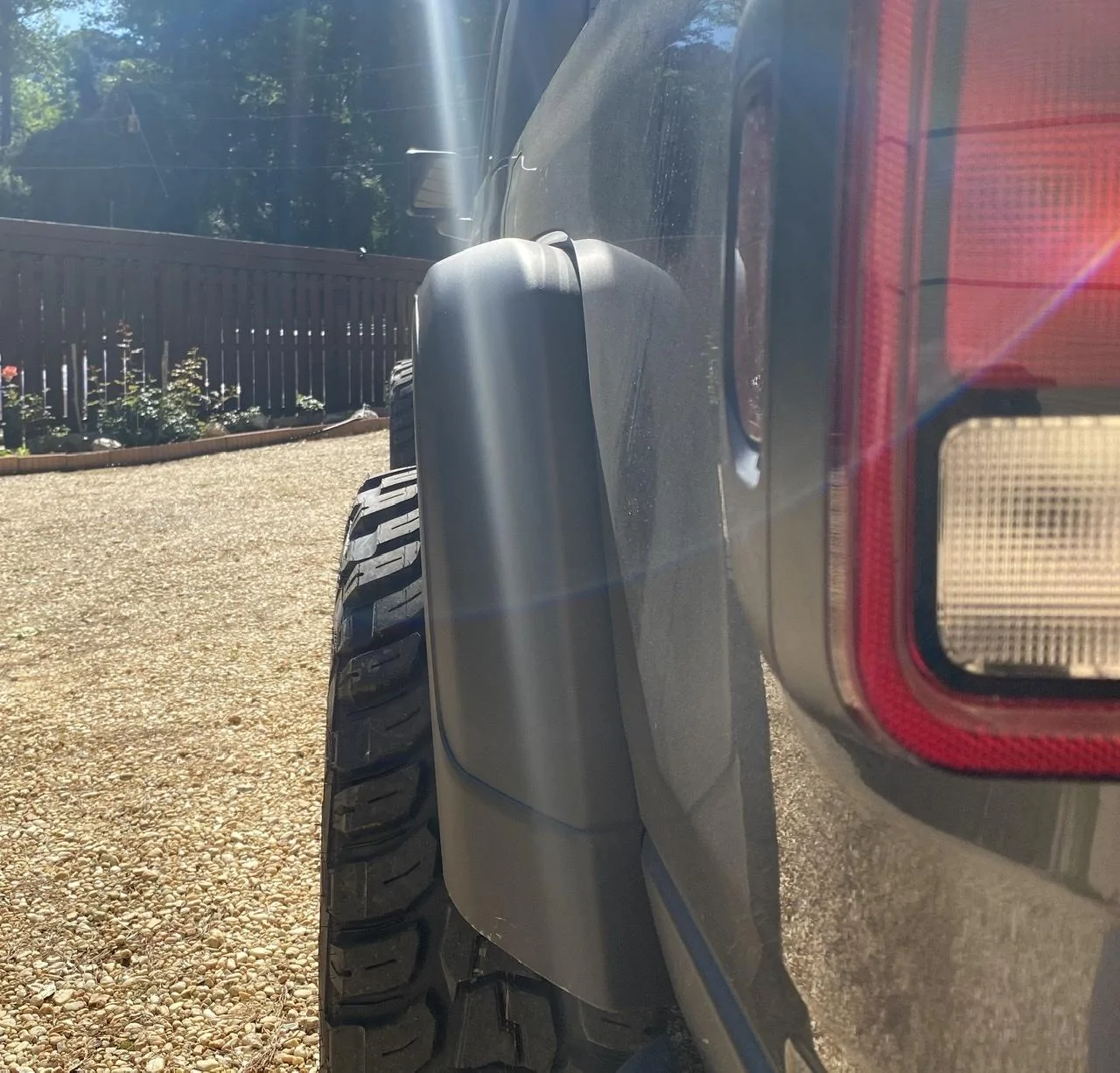

20x10 -24 offset 4.52 backspacing with 37x13.50’s... Only about 2” sticking out of the fenders...
