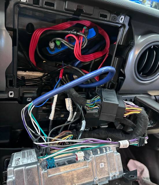

I also attached a photo of what it looks like behind the head unit

Wow that is messy! They should have put the PAC behind the glove box.
Call PAC and talk to them. I believe I read they also have firmware updates. I had the Rockford DSP in my last Gladiator build and I had to update the unit with both firmware updates to stop some of the glitches.
Depending on what PAC tells you about firmware updates, the next thing I would do is fix that wiring mess. That radio gets really hot, I would definitely not have that adapter back there with all the heat
Basically that adapter interfaces with the CAN bus wires (and the other wires). It could be getting hot a freezing up. Some to try next time it freezes, just disconnect the pac adapter (and wiring, basically the T-Harness) and see if the radio works. Depending on how it is wired, you probably won't have sound, but you will see if the radio comes back on. You basically have to start the process of elimination work to figure it out. I wouldn't bring it to any shop for that, they most likely will just point the finger at the other guy ..
