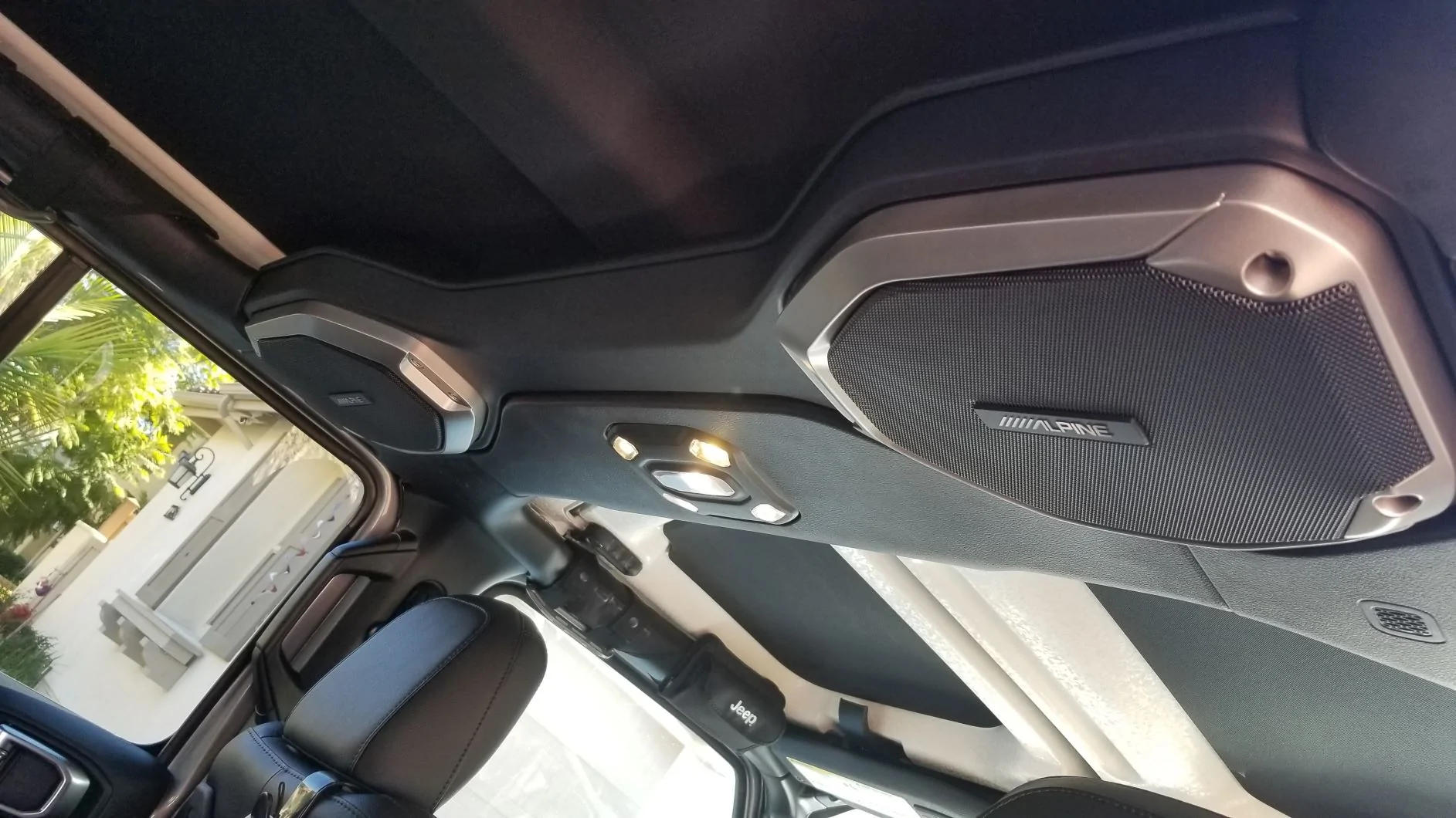

I made changes over time. I have the factory Alpine system. Each change made a noticeable difference. Armorlite flooring made a noticeable difference as well (less road/suspension noise, tighter bass response). Very happy with what I have.

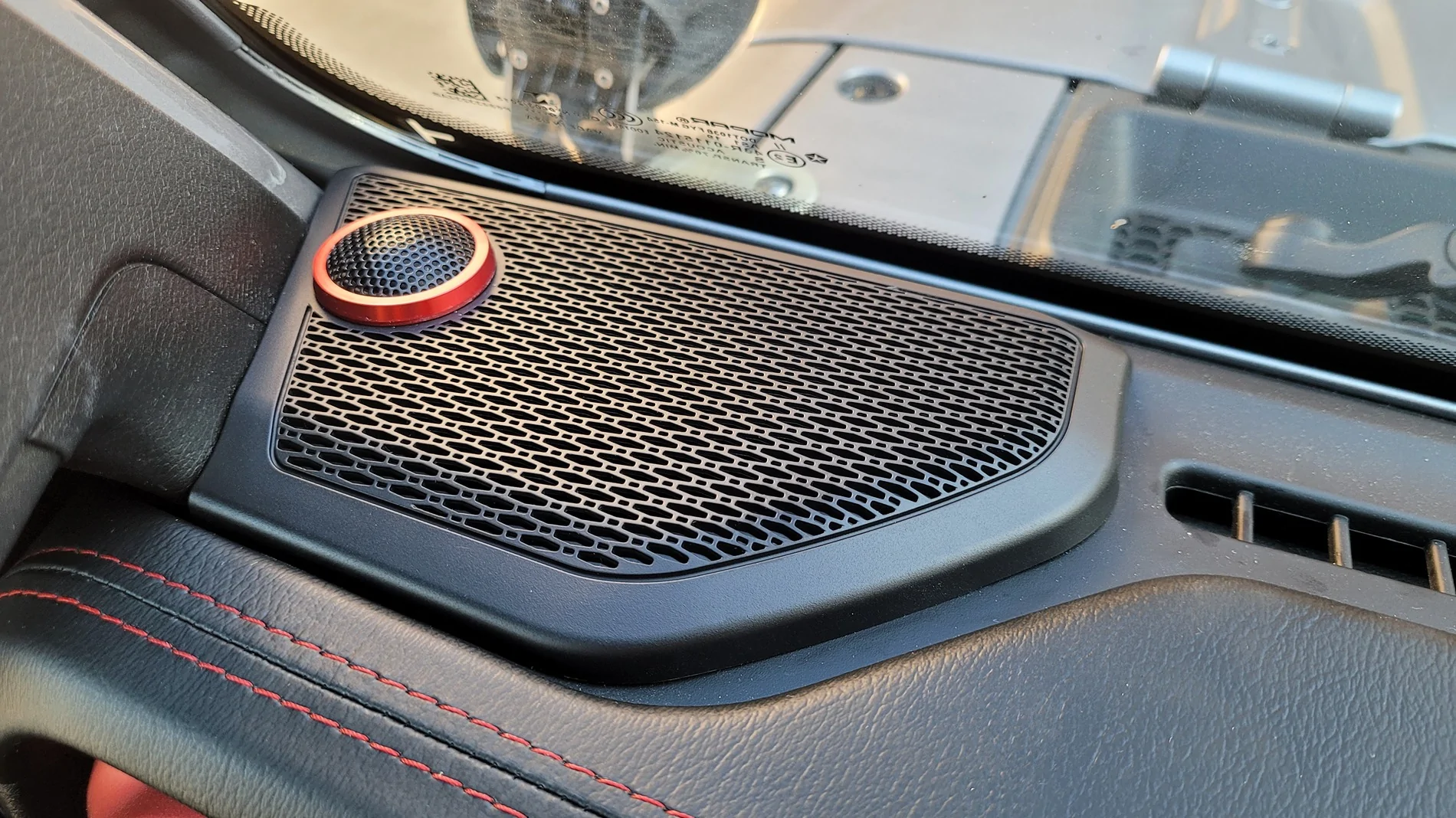

Terra Acoustic dash speakers.

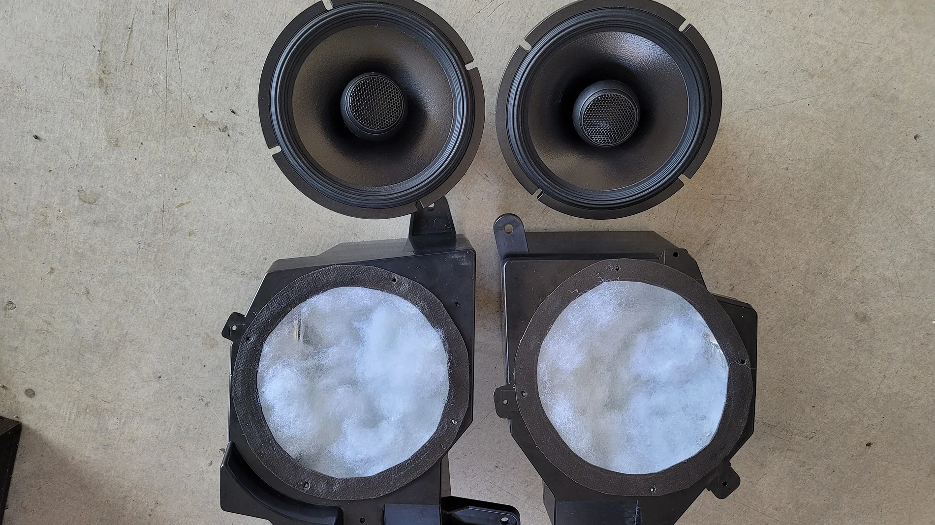

Alpine R-S65.2 knee panel speakers in Metra pods with sound deadening and poly fill.
Alpine SPV-65-JLT sound bar speakers.

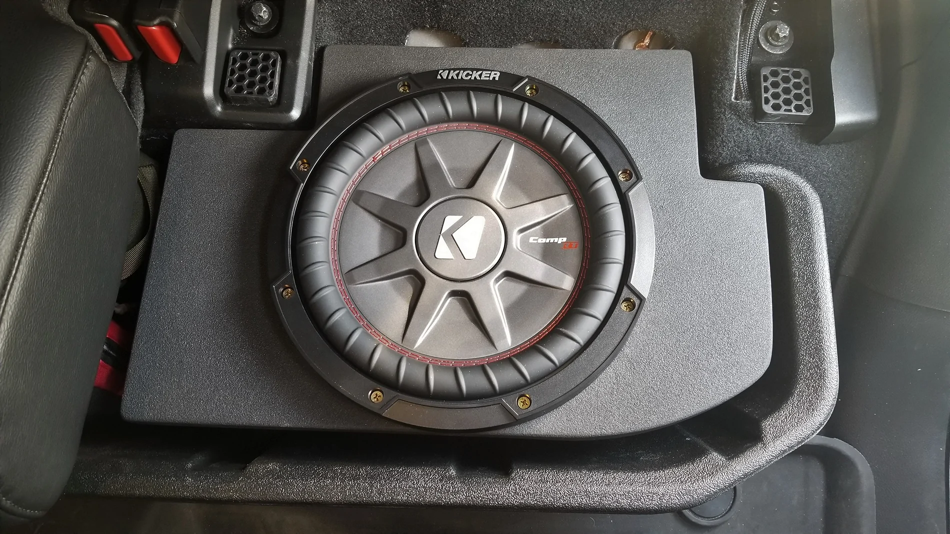

Kicker Comp RT 10 inch sub in custom box (sealed) with Kicker CXA800.1 amp (behind rear seat).
One of my next projects will be to build a larger encloure and replace the factory plastic bin.

I haven't had the need to change or add an amp (other than the sub woofer). The factory amp is plenty for me. I don't even know the the max volume sounds like. I've never had any cabinet resonance or vibrations. I think the poly fill helps (I put them in everywhere).

Where did you get the sub box for under the driver side rear seat

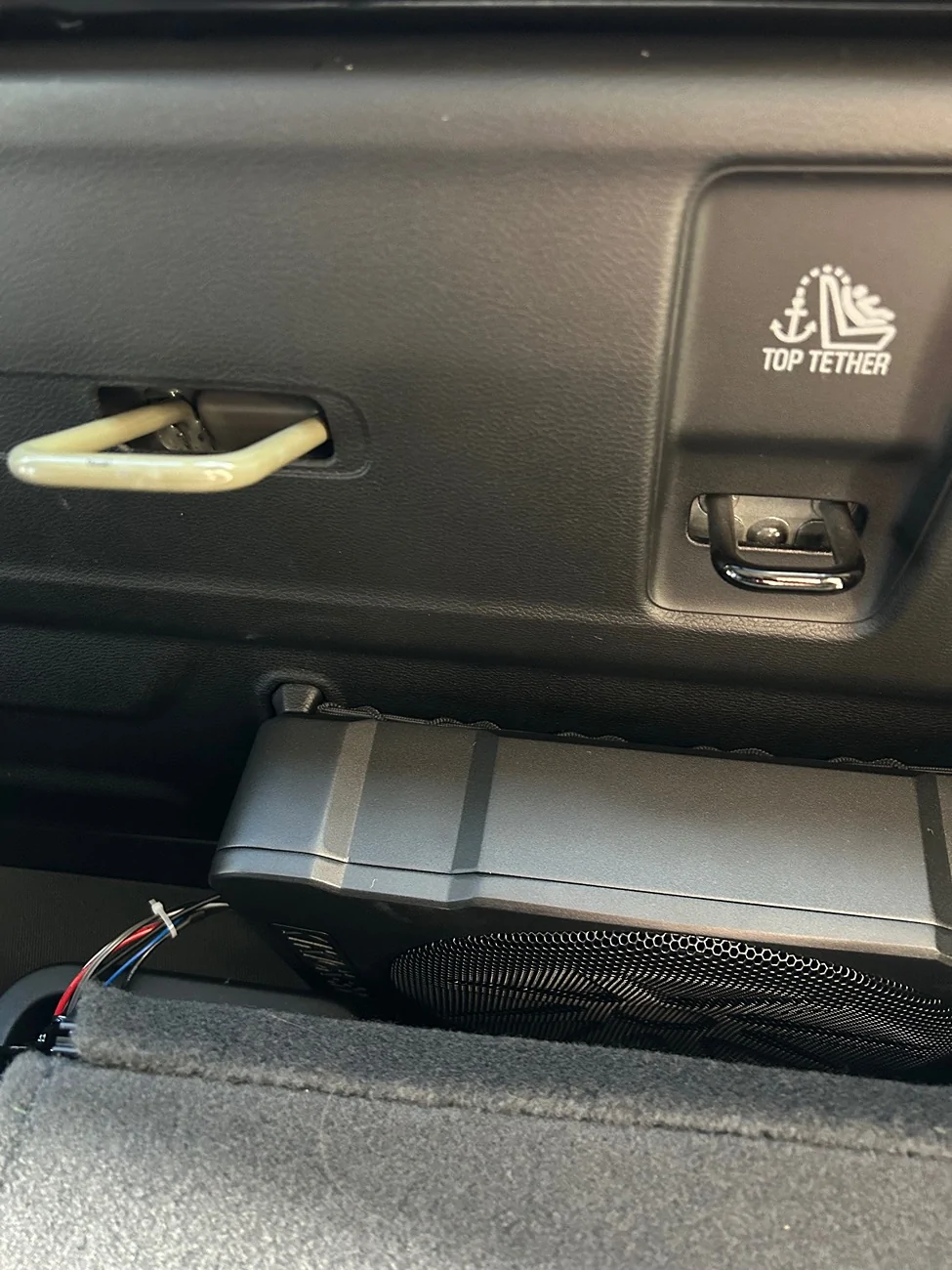

I added a Kicker HS10 self powered sub behind the rear seat. Many others have as well. It definitely makes an improvement, and it doesn’t take up any space. The stereo went from a complete embarrassment to a pleasant listen.
What harness did you have to get for the hook up, I really appreciate it.
You don’t have to get a harness. It is designed to tap into the speaker wires. It also comes with a fused power wire for the battery. No remote lead is necessary. It will turn on when it senses a signal.
