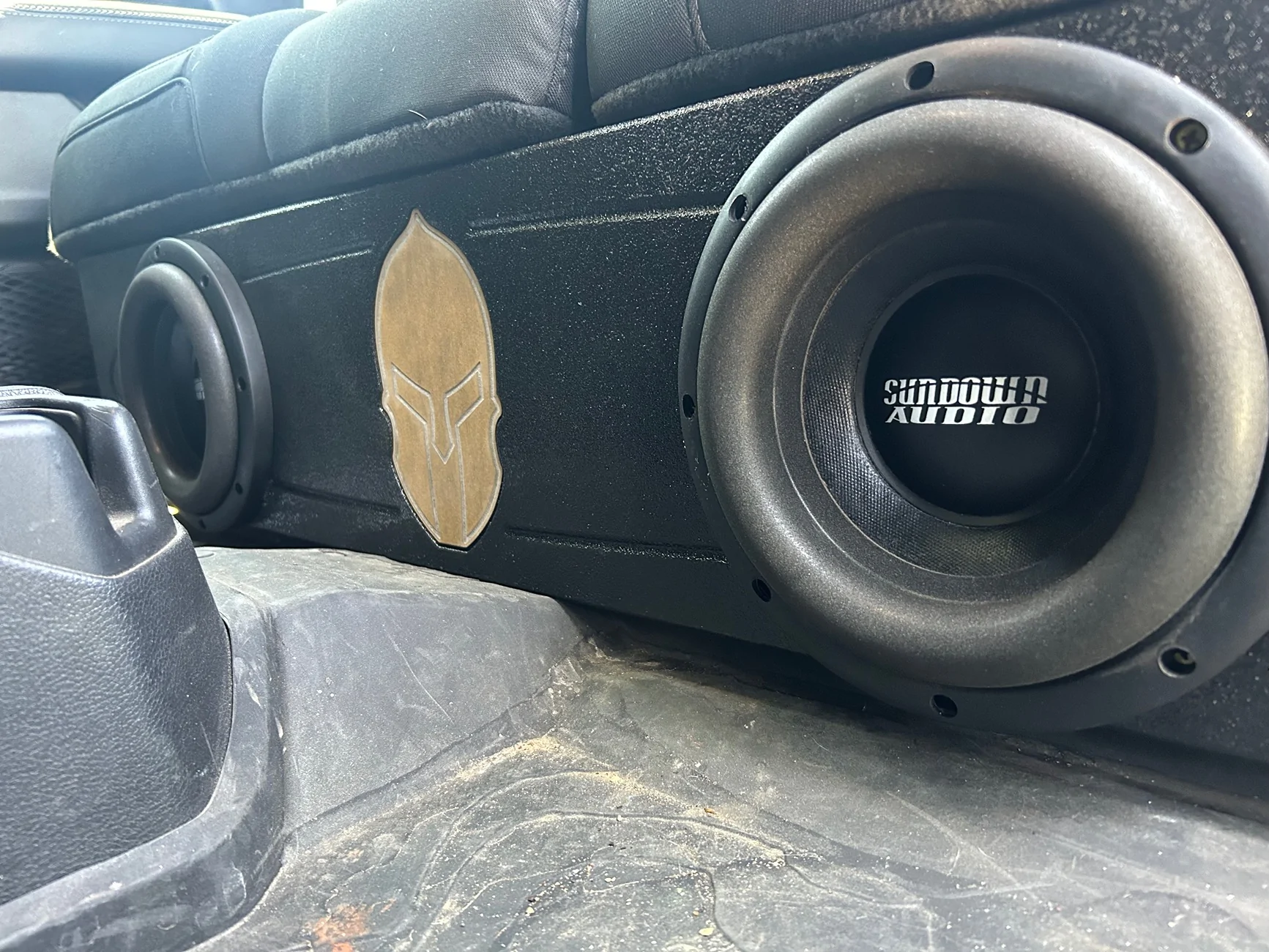

Stop reading things and start doing things. I have the Alpine setup with factory sub still being used in addition to two Sundown 8s under the seat. Only other change was the Kicker dash speakers out of the Dodge Dart. Running an LC2i converter to a 6 year old Skar amp touching 2,680 watts on music. Those little 8s take all the power and then some, while i can hear the factory alpine sub crying for its life in the background. I play my music at level 38 everywhere i go, only because it doesn’t go to 40.

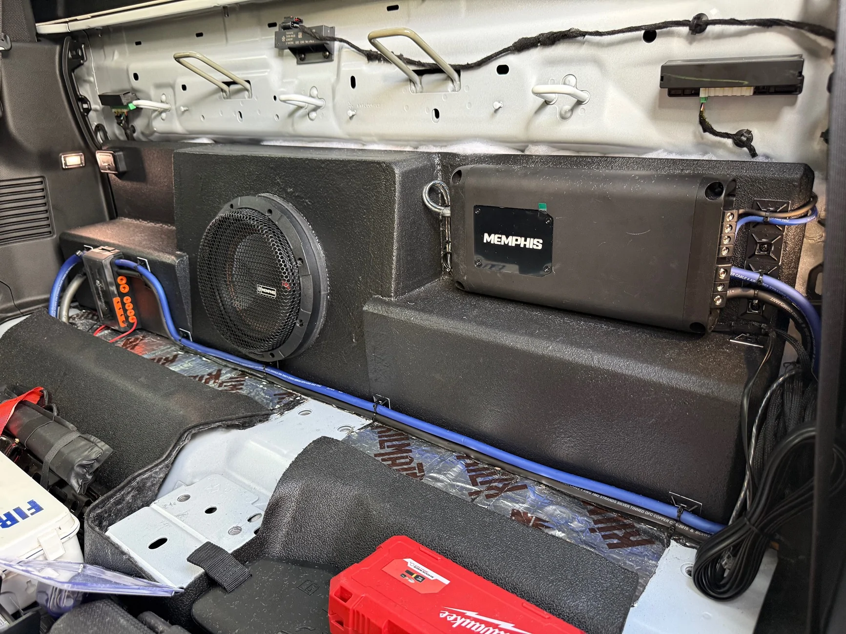

Jumping back in this thread. I’m wrapping up installation of a behind the seat enclosure. I didn’t want to sacrifice under the seat storage and also wanted to be able to still have some functionality behind the seat. I didn’t want to go with a shallow mount sub either as I was hoping to get decent bass out of the limited space. Also opted to go with a sealed enclosure. Box internal volumn is spec’d to the speaker. The two boxed areas on each side of the center is how I accomplished matching my needed air space. Right side fits my selected amp perfect and left side holds a power distribution block on the lower portion and the upper portion I have an outlet for PD/usbc and QC3/usb for charging any future items behind the seat. Rest of the space on the left may be used to mount a flashlight, comms radio, or whatever fits.
My choice of speaker did require me to have to purchase brackets to shift the seat forward 1” (they also raised it 2”, didn’t need the lift, just was all that I found readily available. I may fab some different ones when I move back stateside) a shallow mount wouldn’t have required moving the seat.
Once I get the pac controller installed this weekend I’ll see how it sounds. I also plan to cut the factory plastic cover so it fits back across the top to cover up the metal

Memphis Amp eh? Have been out of the audio game for a minute but those used to be pretty spendy. Really good though. Which sub did you go with?

Went with the 8” mojo mini, it’s 900w/rms. Amp runs 1000w/rms, so leaves a little head room. Was shooting to put a mojo pro in but couldn’t quite make the depth work when taking magnet size into account. I have the mojo pro mids and highs already, I’ve ran them in another jeep and never had issues with them.
