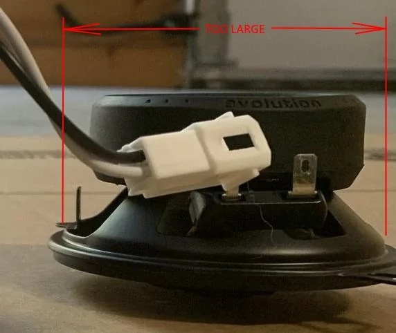

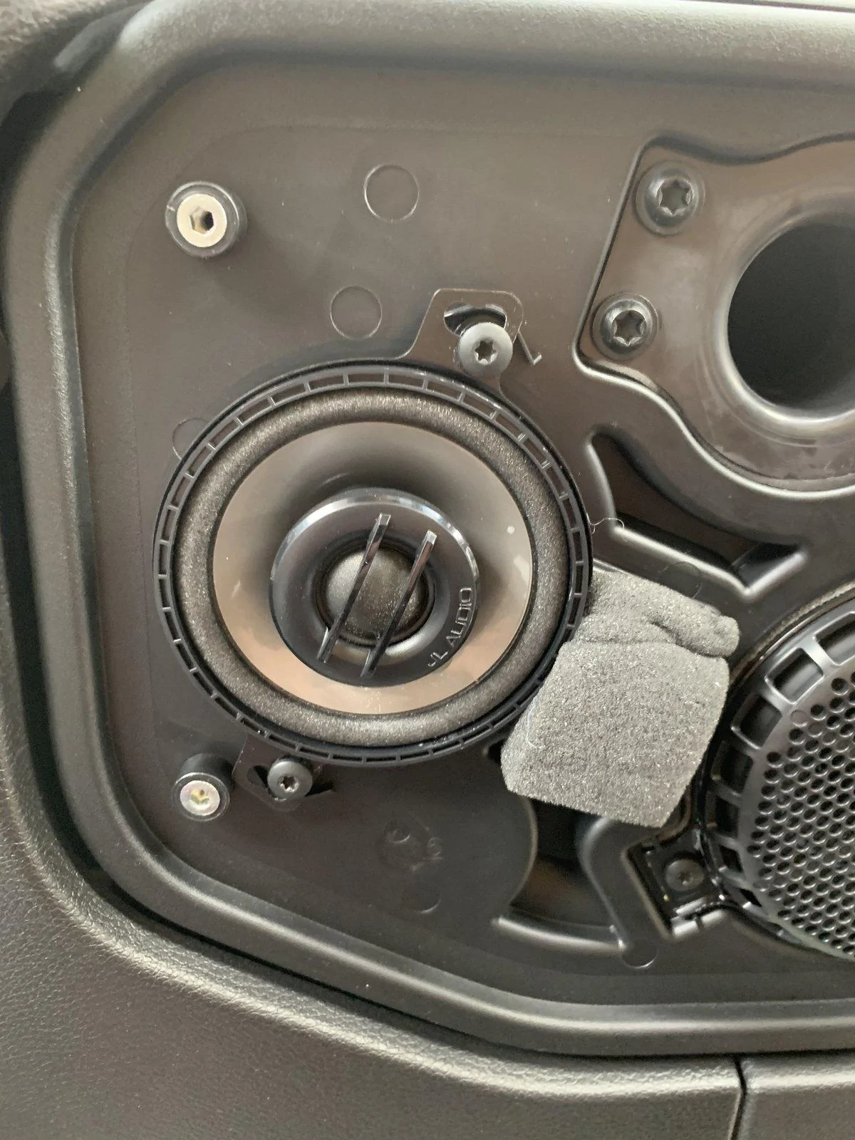

Well, the JL Audio speakers DO NOT actually fit in the soundbar. It's not the mounting tabs that are the problem, but rather the diameter of the speaker frame itself - see below. The dimension shown is too large to fit down into the hole of the soundbar. Maybe my soundbar is slightly different, I don't know, but they definitely don't sit down into the soundbar opening properly. Bummer! I ordered another pair of the Kenwood KFC-X3C's and am returning the JL Audio speakers.

The JL Audio C2 350X fit mine and flush. It’s tight for sure, but was able to get them in. They sound great and was a big improvement over stock IMO.

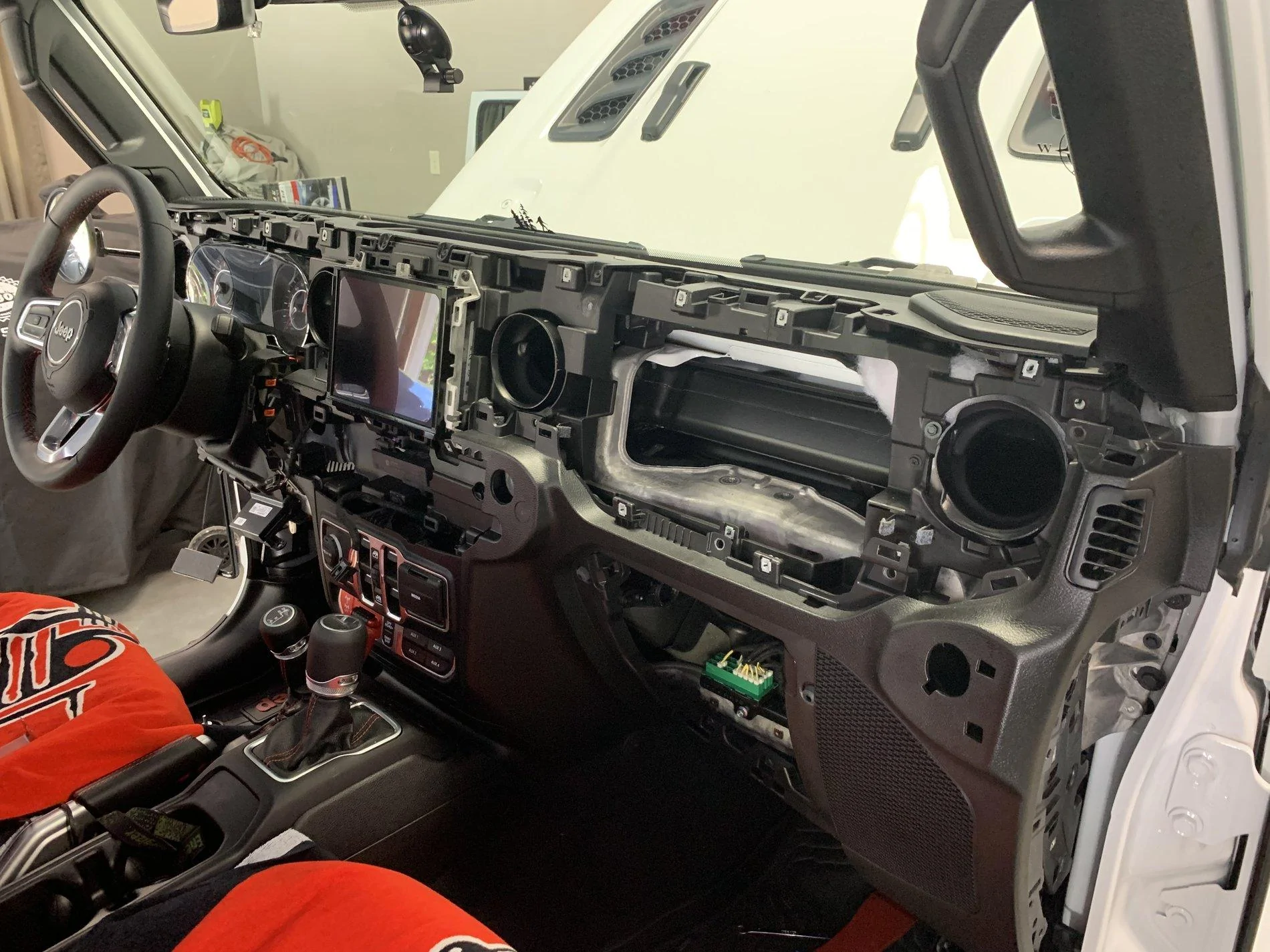

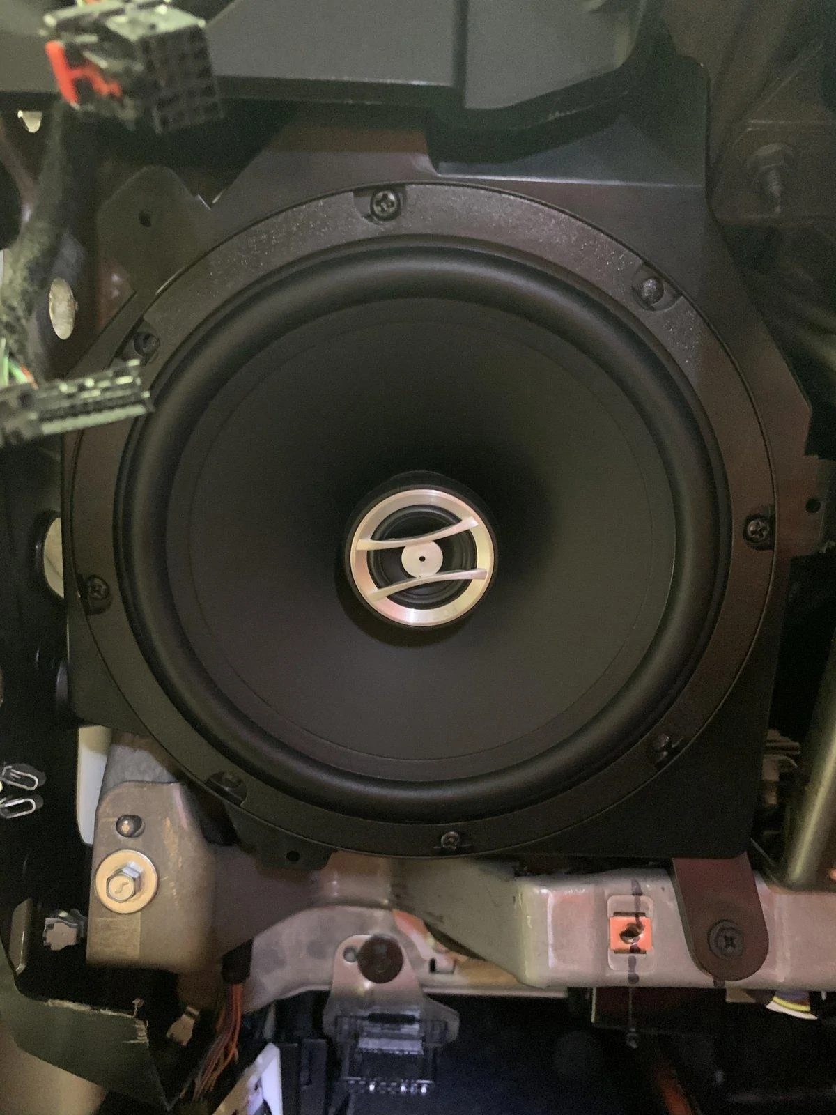

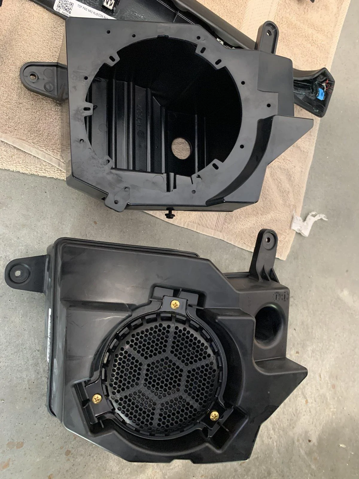

I just couldn’t be happier with the night and day difference. Finally added the Metra JP-1014 6.5ā€ pods and Focal RCX-165 6.5ā€ speakers in the dash knees. Yes, it was a bunch of work disassembling the dash, but so worth it. I also added Hushmat & polyfill inside the Pods. It sounds so much better with the sound stage up front. Think I will hold off on the PAC preamp and Amp upgrade for now. Might swap the 8ā€ sub for a 10ā€ next and see where it goes. Highly recommend this 6.5ā€ modification.

That’s so weird! I’ll take another look, this time I’ll use calipers and accurately measure the hole and the speaker frame.

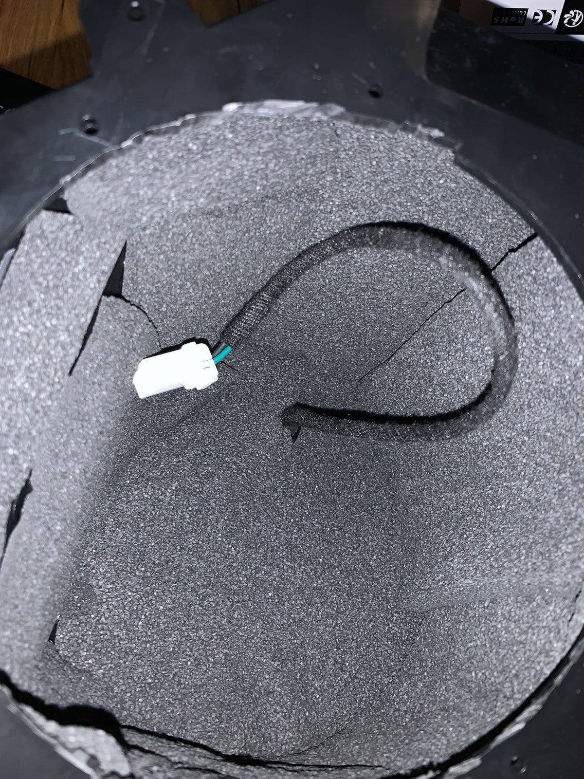

It’s been a while and going off memory, but I think you get the wire plug hidden into the small opening on one side. Then put the speaker in and finagle with a little twist or orientation. They should fit, but might have to play with it some. Maybe my picture will help. Hope you get them to work.

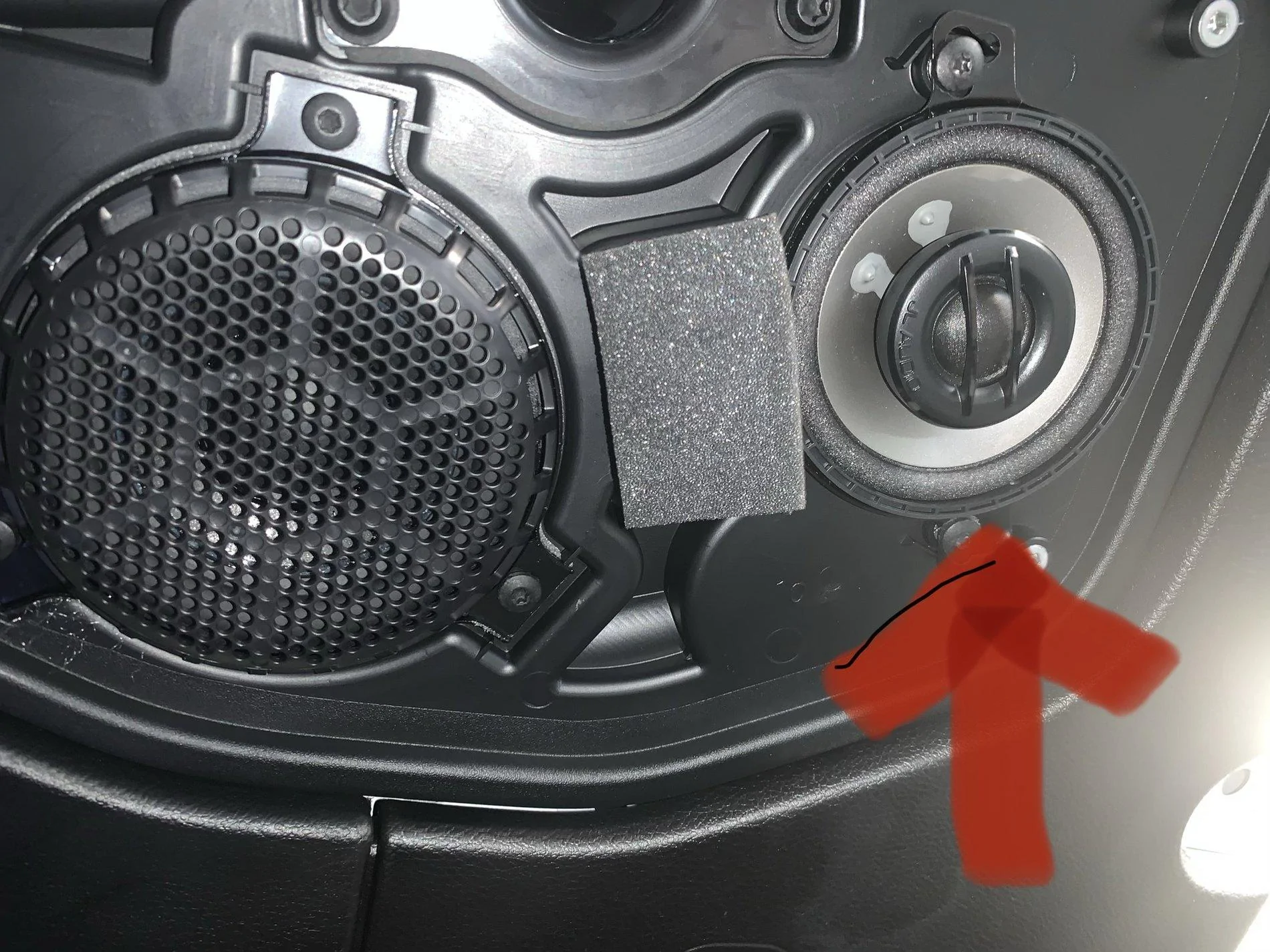

I took another picture for you to see the exact placement clockwise of mine. I was sitting in the rear seat on the drivers side when taking the picture just looking up. The JL Audio letters are closest to the foam insert. I hope that helps with the correct orientation.
