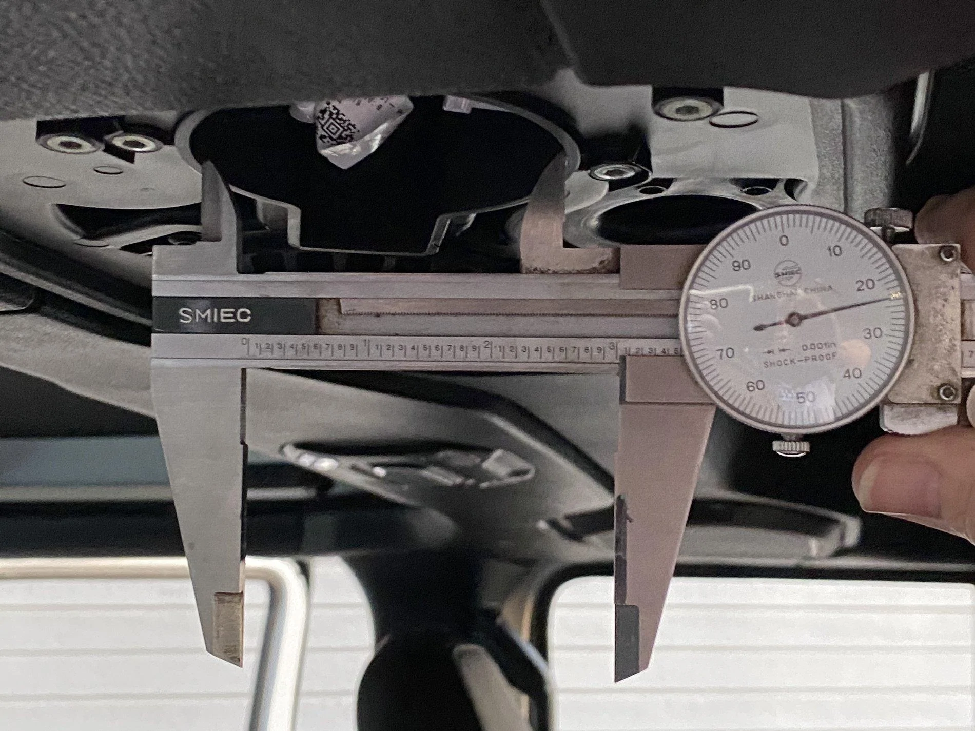

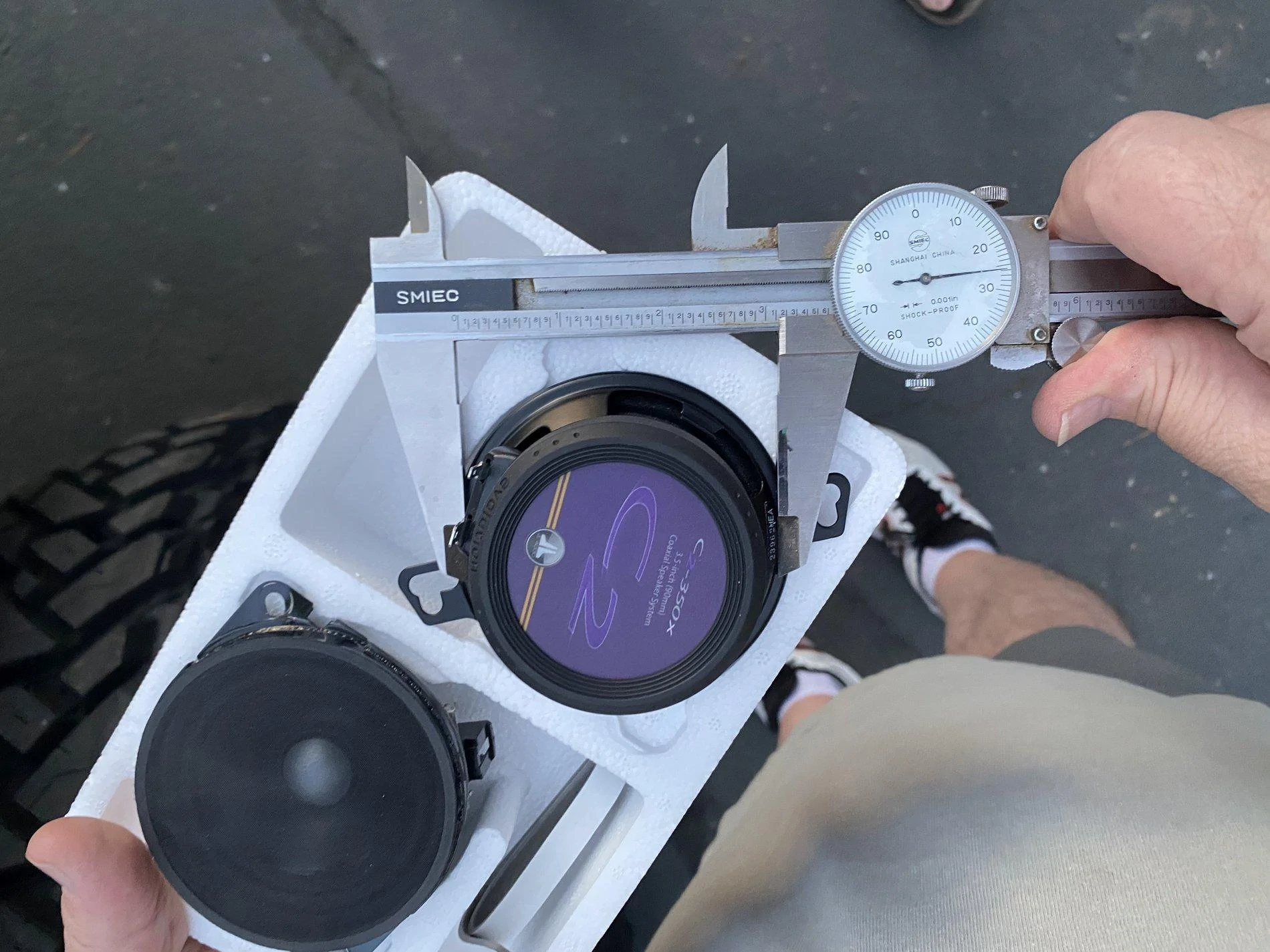

Ok, my kid and I played with speakers today and here's what we found. We put one Kenwood KFC-X3C in the dash and compared it to the stock (upgraded Alpine) speaker and found the Kenwood sounded "cleaner" and had better highs than the stock speaker which to me sounds a little muddy. We then tried one of the JL Audio C2-350X speakers in the dash (not sure it would actually fit, but looked like it might if you tweaked the tabs a little) opposite the Kenwood. The Kenwood had better highs, and like you said, we felt the JL Audio had nicer mids. Wanting better highs, we decided on the Kenwoods up from in the dash, and we installed them commando style as midironman suggested - thanks midironman, commando seems to work great! We then moved to the rear to try the JL's again in the soundbar. I pulled out the 3 1/2" speaker and measured the opening at 3.024" in diameter. I then measured the speaker frame and got 3.125. There is no way I can make that JL speaker fit in my soundbar, not flush anyway. I'm not sure if my SB is different than yours, of if there has been a change to the JL speaker frame, but on my vehicle those parts will not coexist :crying: We ended up puting another set of Kenwoods in the soundbar as the Apline speakers in the SB seemed to be the same ones they put in the dash and we liked the Kenwoods a bit more than the stock dash speakers. I'm not sure if we lost some of the mids in the SB, but it sounds pretty good to the kid and I both, especially after tweaking the EQ on my phone instead of the minimal EQ adjustments on the Gladiator. We're done with speaker changeouts for now.
Below are some measurement pics I took of the hole and the JL speaker frame.
Thanks much to you and midironman for all your help!!
