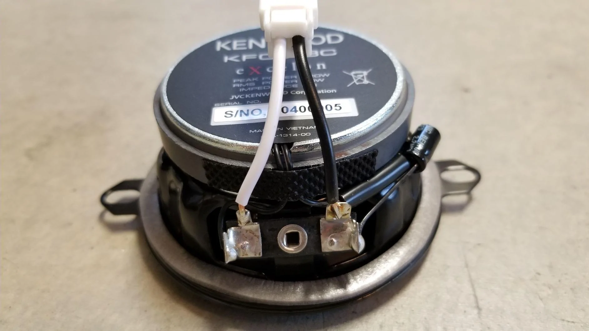

For the dash (top), I installed the Kenwood KFC-X3C speakers. Those really brought out the highs. I bought from Crutchfield, so they provided Metra adapters, which I cut and soldered directly to the speaker terminals. It made the connections less bulky.

Edit 2-13-2021: I may have accidentally reversed the polarity, so I swapped the black and white leads. As expected, made no difference.

I thought they were checking to see which was the true positive and negative ? Isnt that the whole point of polarity?
It's not really about true positive and true negative, it's about all the speakers being connected the same so they are all pushing in and out at the same time. When I first installed the Infinity speakers in my dash, the mid range sounded terrible, that's when I saw the wiring was reversed by the Metra adapters. Switching the Metra wires fixed the problem.
