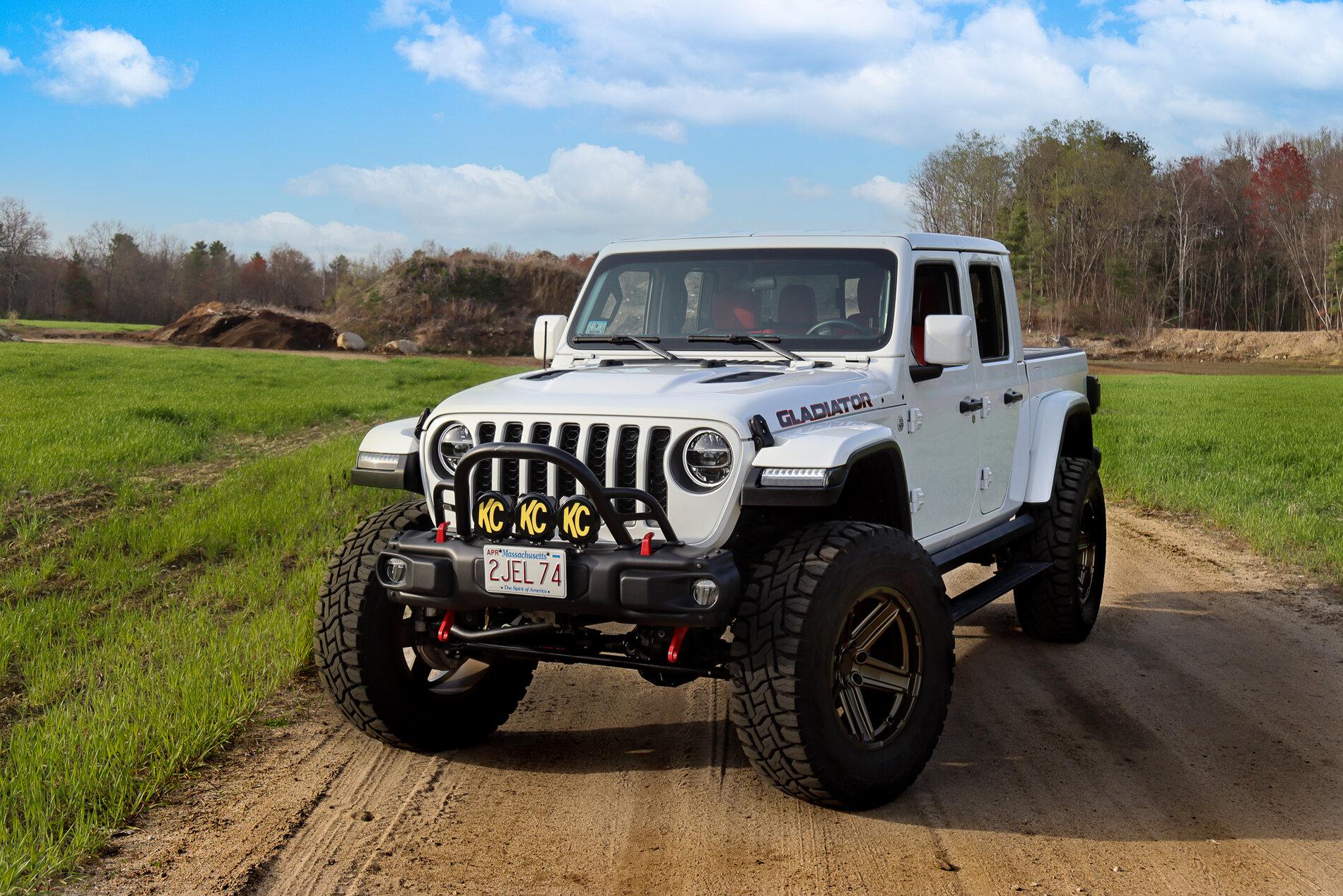

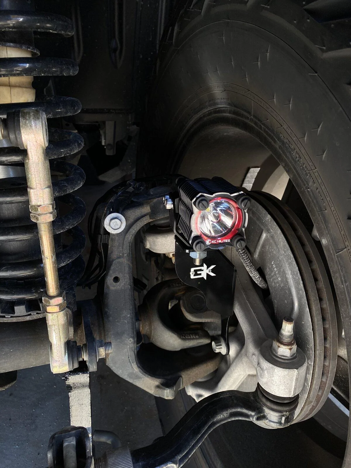

Added on the KC lights (2 wide - 1 spot) on the bumper and some KC flex spots on the gatekeeper knuckle mounts.

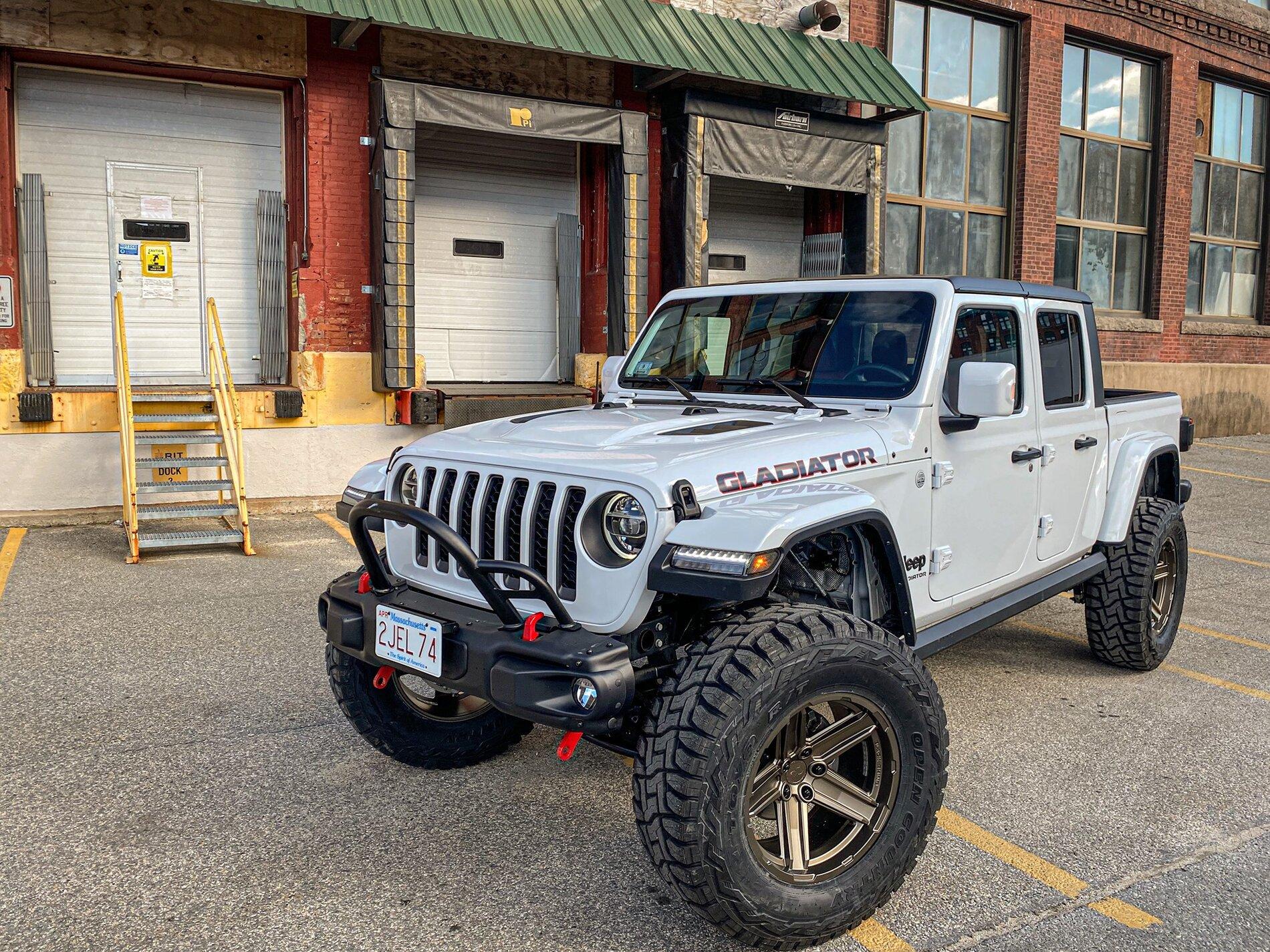

Had a local shop paint match my roof. Originally was the black textured so they sanded it down and hit it with a perfect match.

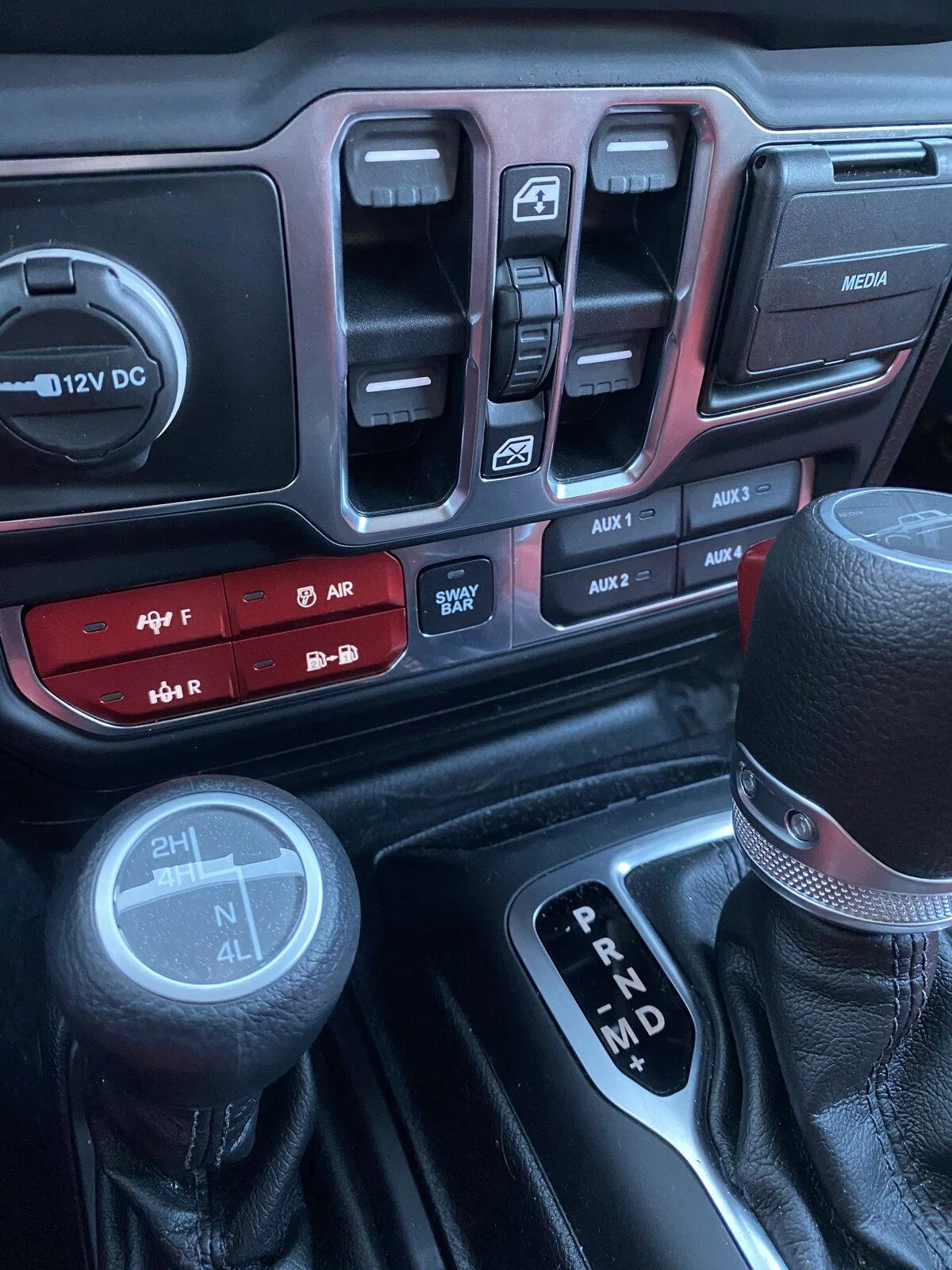

LASFIT switches with OEM Aux kit and custom OEM sway bar button
great work here… I’d love to see how you modded that’s way bar button in there to trigger the ARB solenoid to the EVO sway bar disconnect… did you have to sacrifice a stock rubicon switch to make it all work?

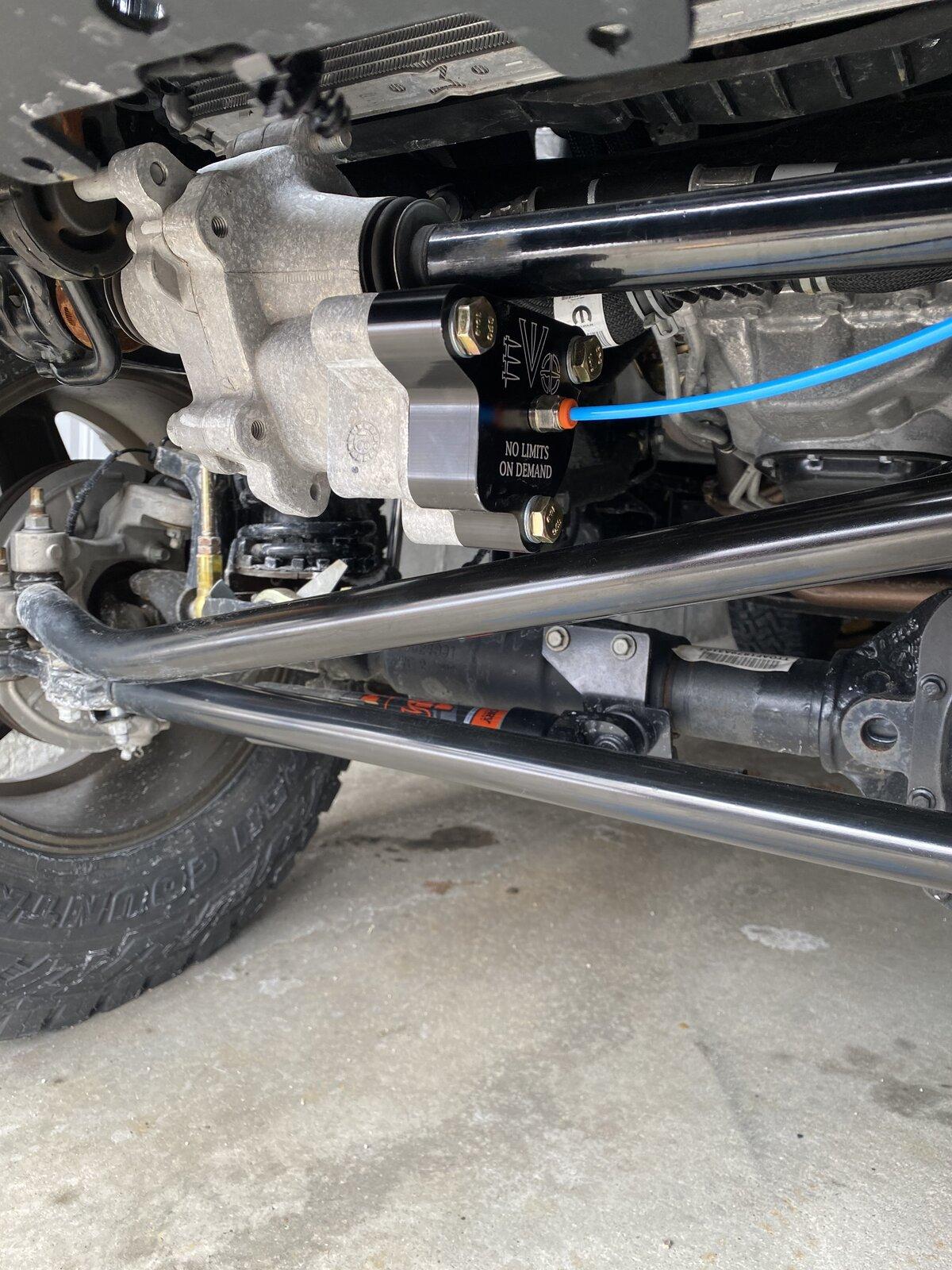

So that was my original plan. I did sacrifice an oem rubicon switch panel to do it but got it on eBay for like $30. I tried using a latching switch and relay but turned out to be more work then I wanted. So currently the sway bar button is display only and I actually disconnect the sway with the aux fuel tank button

Thanks! and paint/labor cost me $1100. I think if I paid with card it would've been like $1350-ish.... and yeah everything is nice and smooth, nothing that I have noticed as far as imperfections. The nice thing with the JT is that most of the roof is the top, so unlike the JL you don't have a huge area on the back window to paint.

KC gravity pro6 lights (2 wide, 1 spot)
KC Flex spots on Gatekeeper offroad Knuckle mounts

this is an outstanding build. Well done. Did you add the front and rear lockers too with the rubicon switch panel or did you just use it for the sway bar disconnect?
With the export mirrors in white and running lights in there, what wiring modifications did you have to make?
So I don't have lockers in yet, but yes they will be wired into those switches when the time comes. The export mirrors are tapped directly into my front DRLs. I actually have them set as running lights but either works. I plan on doing a small write up on themm.
