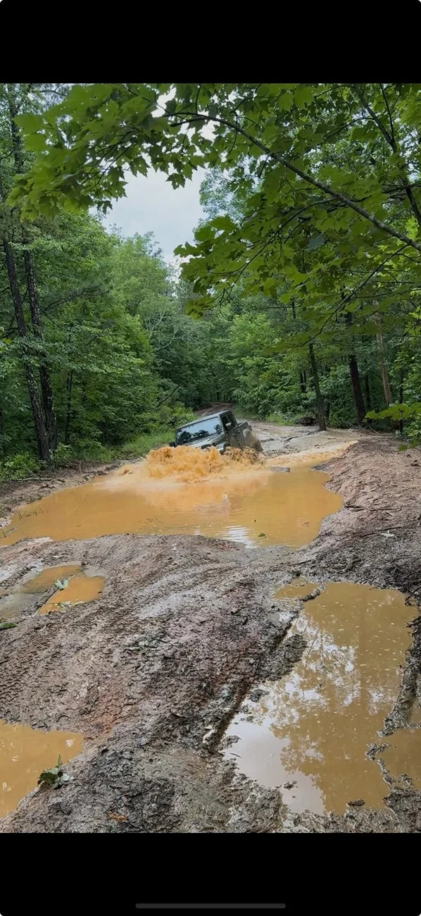

All,
The sound went away after I deep cleaned the engine bay. I washed all around the serpentine belt system. I believe there must have been some crud behind a pulley or something.
Definitely has to be related to a mud puddle i lovingly refer to as "the incident"

Almost everytime I took the Power Wagon swimming. I had to replace the idler pulley. Wonder if the JT is the same way.
