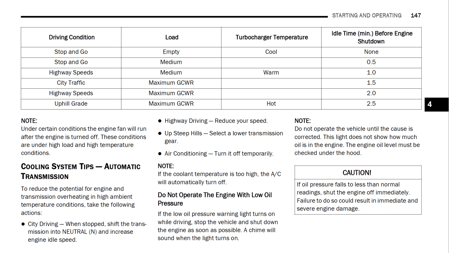

Checkout the JL forum regarding the same issue. You need to let the vehicle idle a certain amount of time after driving for the turbo to lubricate itself.
Yes.
From the manual:
Jeep Gladiator EcoDiesel Buzzing Sound from Engine After Shutoff 1612830690602
