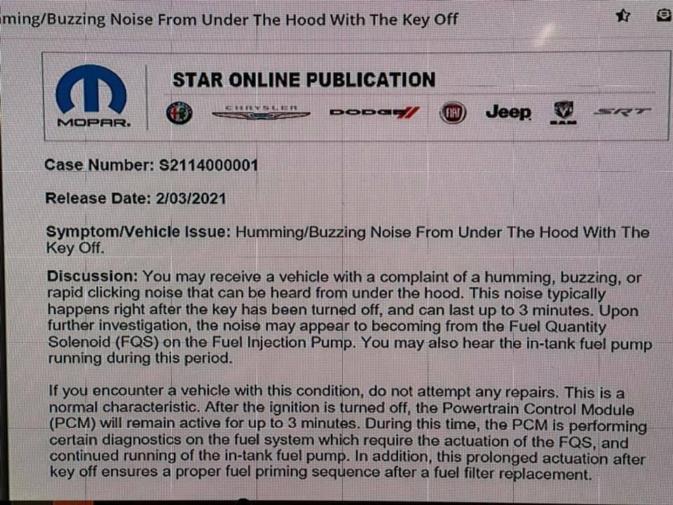

Ok guys here’s what the noise is. Put all the rumors to rest
Thanks. Now why could they not put that in the manual or in the “pass down notes” when you pick it up?
