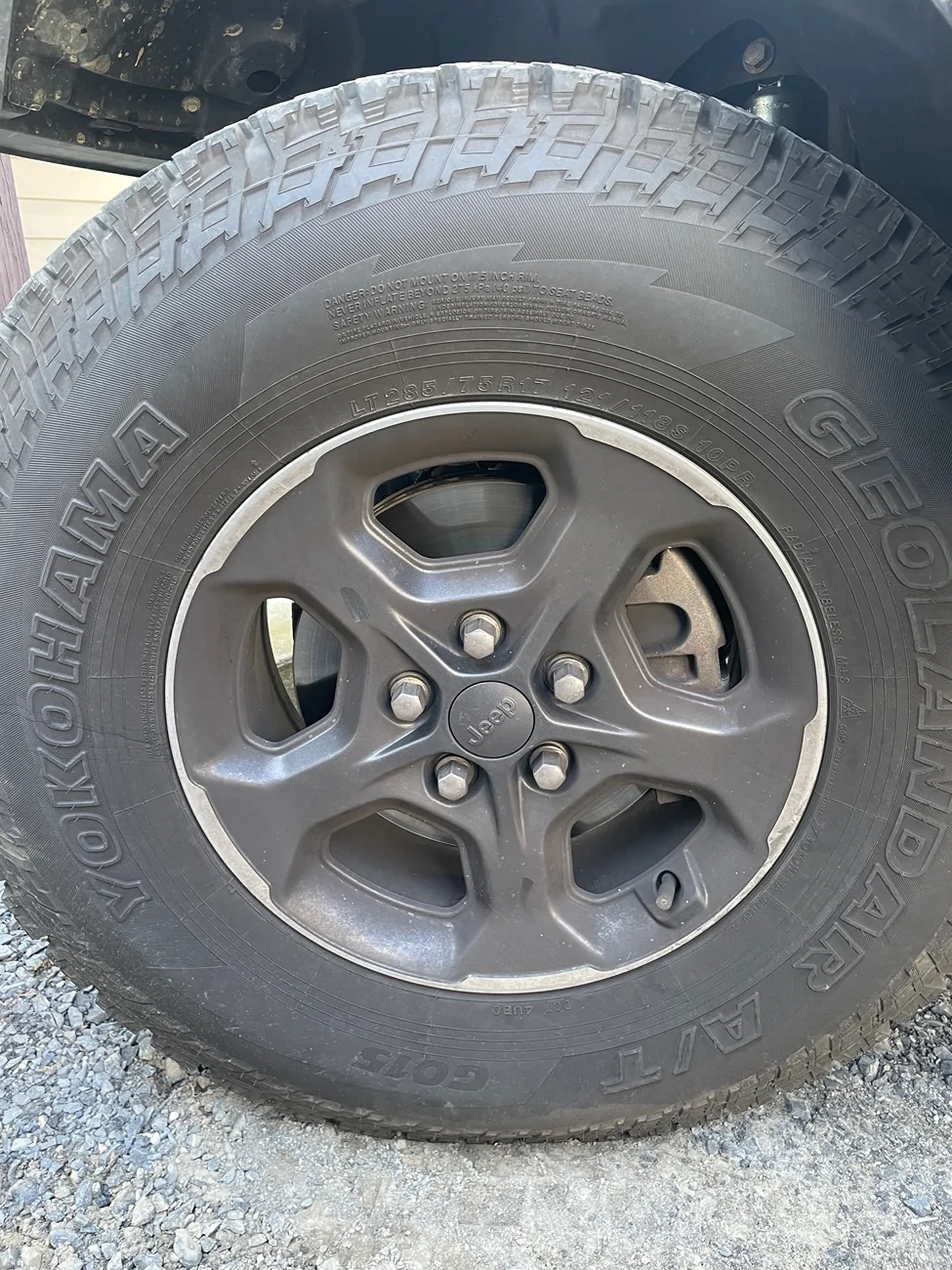

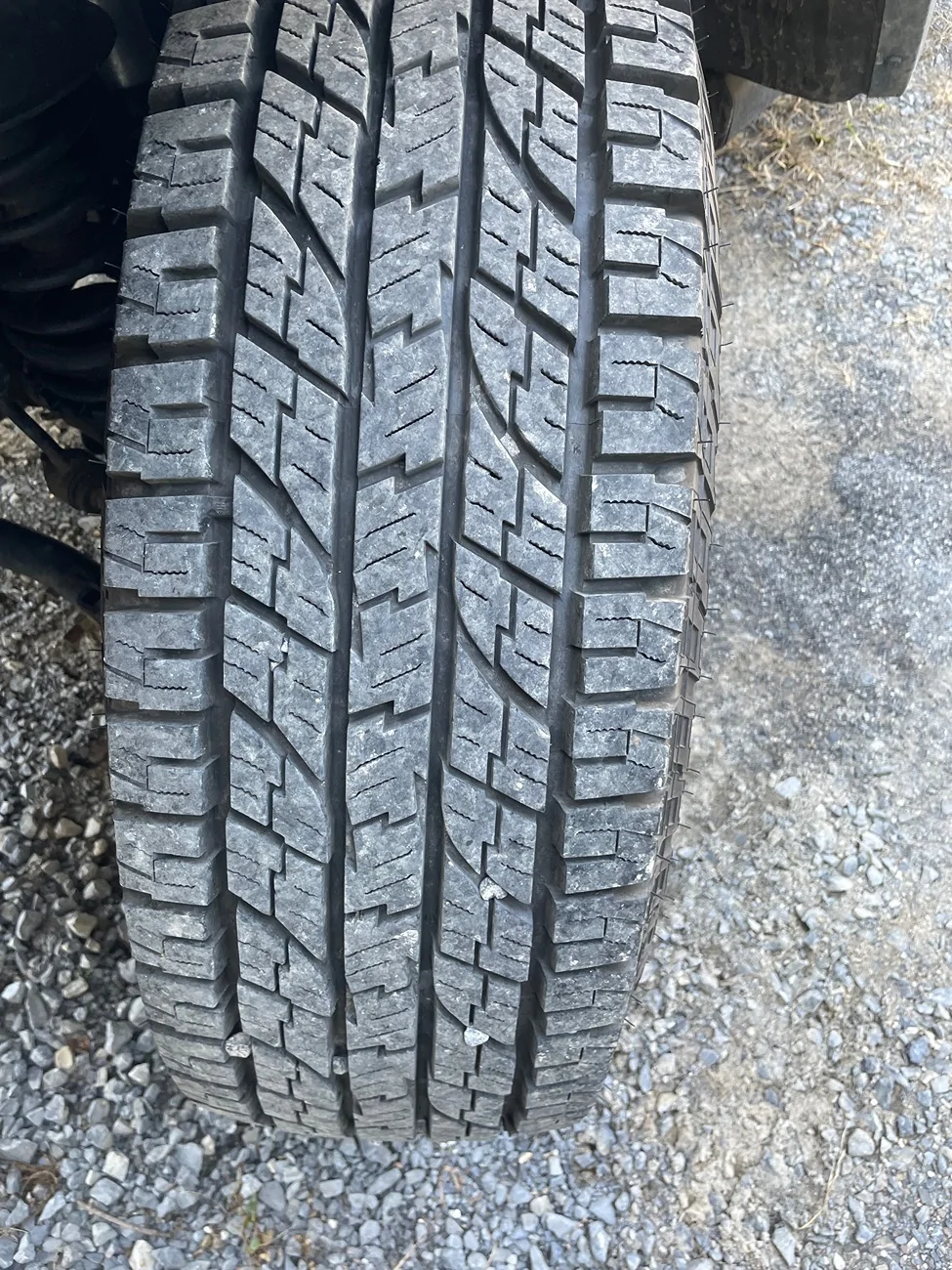

As Joe said, you can’t go wrong with Michelins unless you are going off road. I have never been a fan of Fire/Bridgestone on pickups, won’t run them. My trail tires are Nitto Trail Grapplers but my daily road tire is a Yoko Geolander. They are a bit stiff because of the 10 ply rating but not bad at all! I am actually on my second set of them, (got a deal on the first set from a member).
