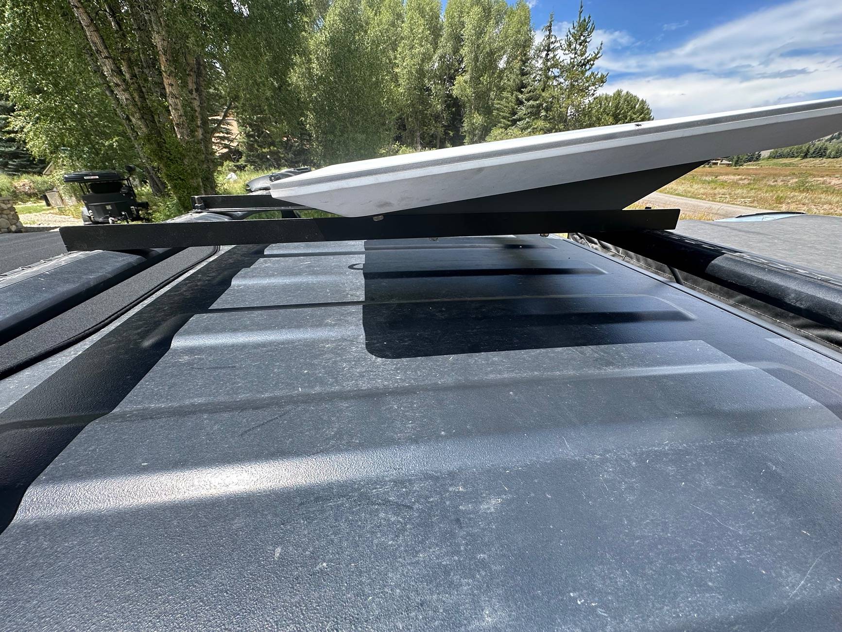

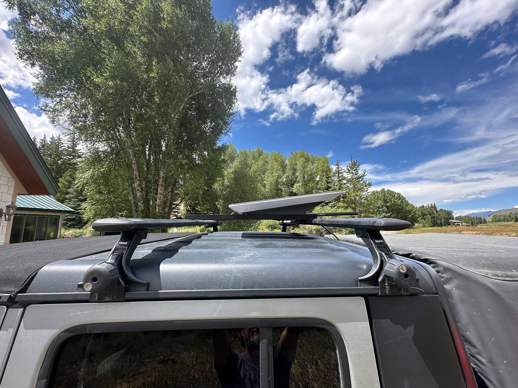

I made a super easy mount for mine that just attaches to cross bars. It’s completely universal. It maybe cost $10. Just aluminum angle iron, black paint, some t bolts of your rack uses those, and a drill. It looks seamless.

Any pics of how it attaches to the dish?

Yes, for my solution, you need cross bars, but the high performance panel actually provides a water tight method to mount directly to the roof. I just couldn’t drill the roof. Some might be less ocd than me.

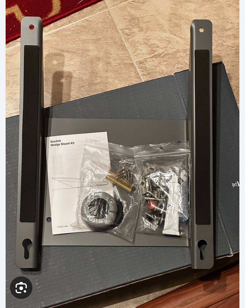

The flat high performance panel comes with a wedge mount with 4 mounting holes. I attached it to the two pieces of angle iron, and used t bolts to attach the angle iron to the cross bars at my chosen bar spacing.

Here’s an image I found online of the wedge mount. It should clear
it up hopefully.
Jeep Gladiator Starlink Mini IMG_0531
There are holes in the bottom that I used to attach to the angle iron. Obscured by the “stuff bags”.
