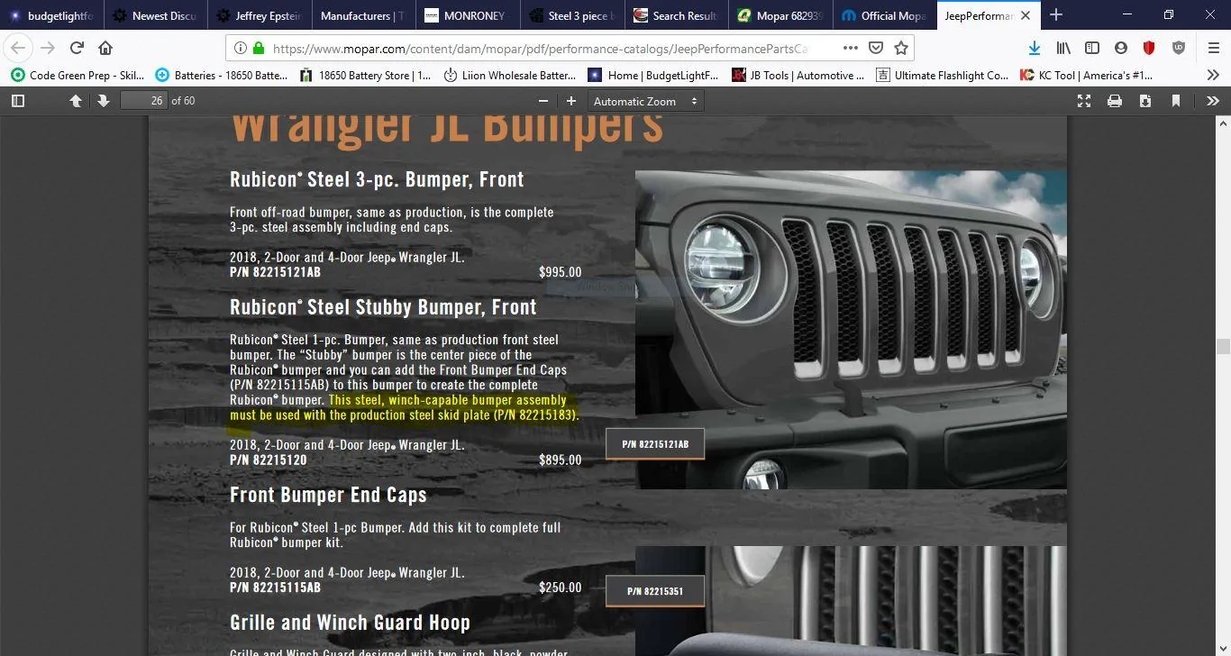

See the highlighted part, this is from the Mopar Performance catalog. I understand it doesn't say JT but it it does say JL which for these parts should be synonymous

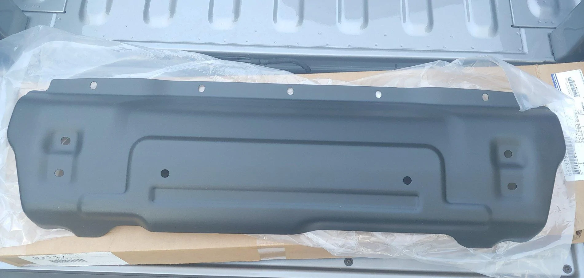

I have ordered this one and have it in my garage. The instructions are.specifically for adding this to a JL. it is steel and has all.of the hardware needed to attach to the 3 piece jl steel bumper

Skid plate arrived, and although I have not got the bumper yet, it appears to be correct. Is substantially constructed, and based on the label attached, if you want one should probably get to ordering *close-out skid plate*

Open it up! Take a pic.....I ordered the other one and we can compare notes!

I'll admit to assigning value to the connection that I cannot substantiate with factory supplied data or design drawing. I will however say that I have assembled/dis assembled and built from scratch enough stuff to say that deflection in the bumper is virtually guaranteed without the skid being integrated in all but a straight pull. The simple fact that the Mopar Performance website dictates that the skid must be used to complete the assembly would seem to substantiate that opinion.
Will the frame horns deflect without it? I don't know for sure, but again Mopar says the skid must be used so I can't see the value in rolling the dice for $125.

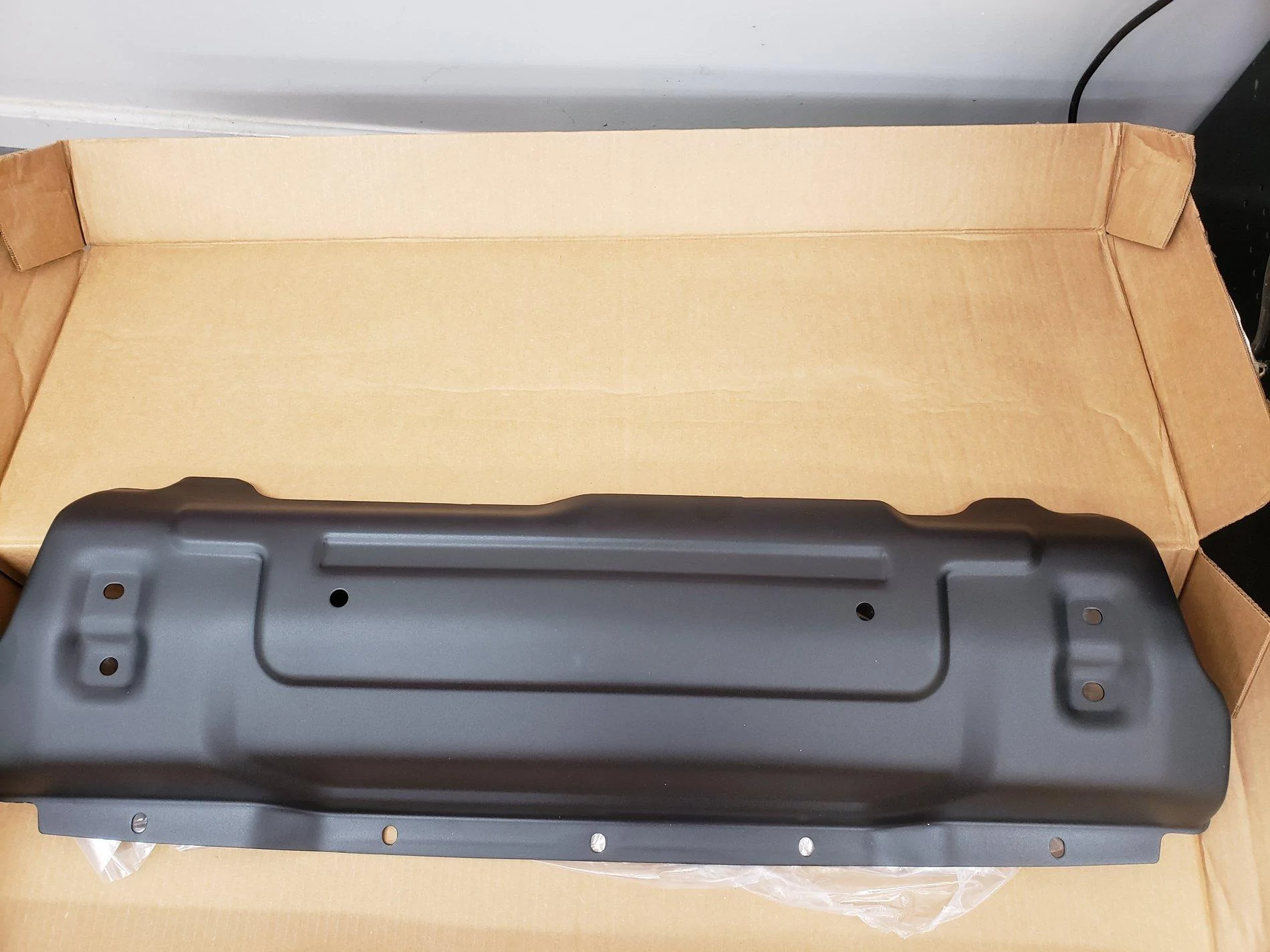

Here is mine. It comes complete with hardware.....that may or may bot be there already on the rubicons. Not that this one weighs 30+ lbs. Is there a difference in thickness?
Looks identical, I took the weight off of the shipping label.
Put a set of calipers on it and give me a thickness.
