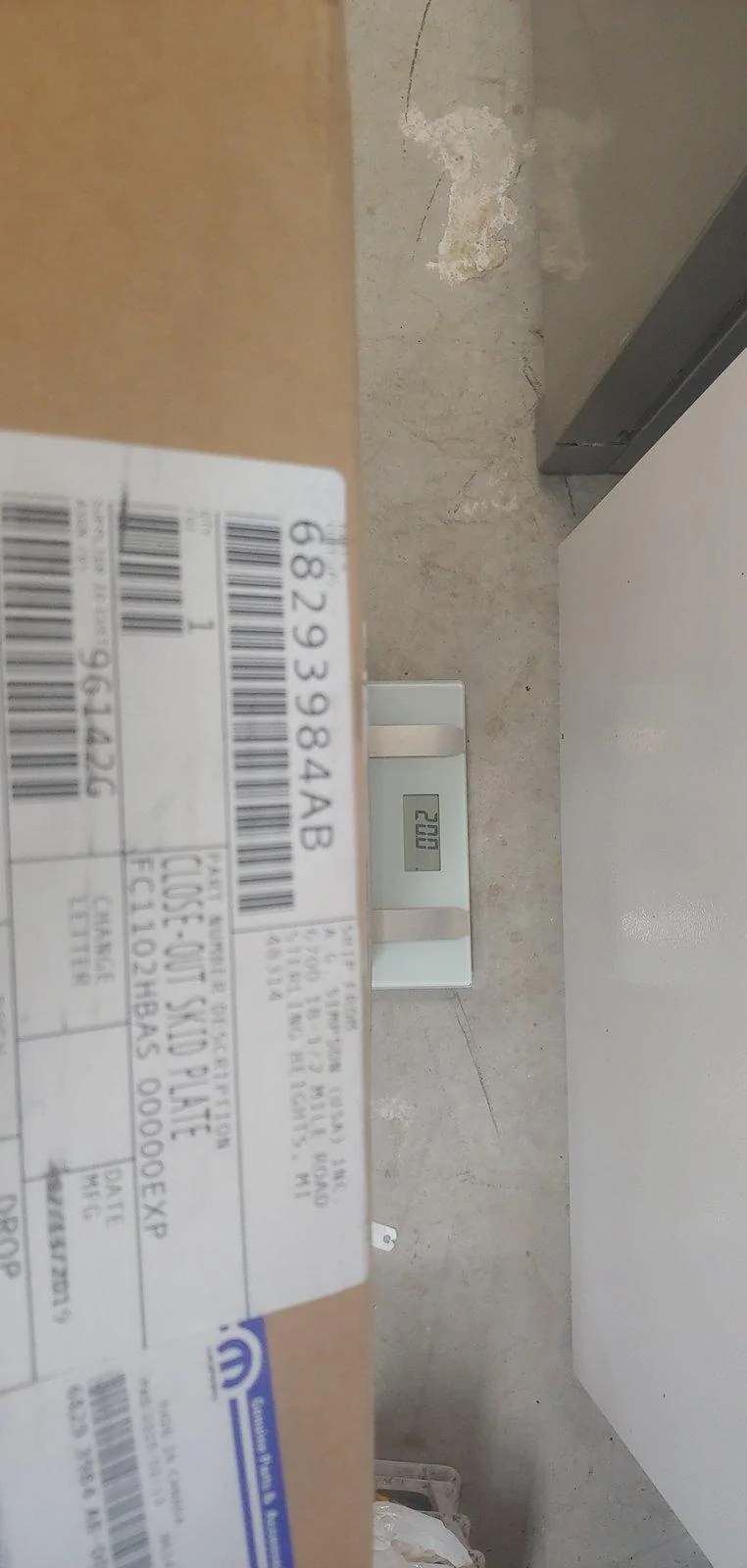

20 pounds in the box

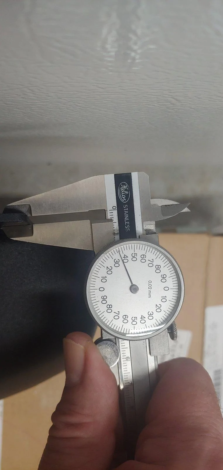

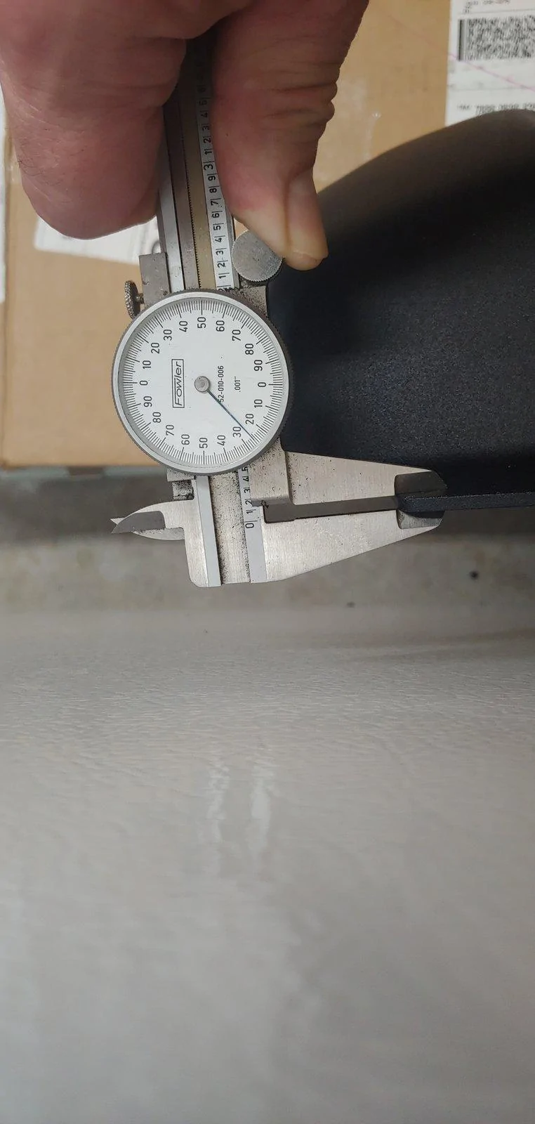

3.3mm or 1/8" depending on your preferred measurement system

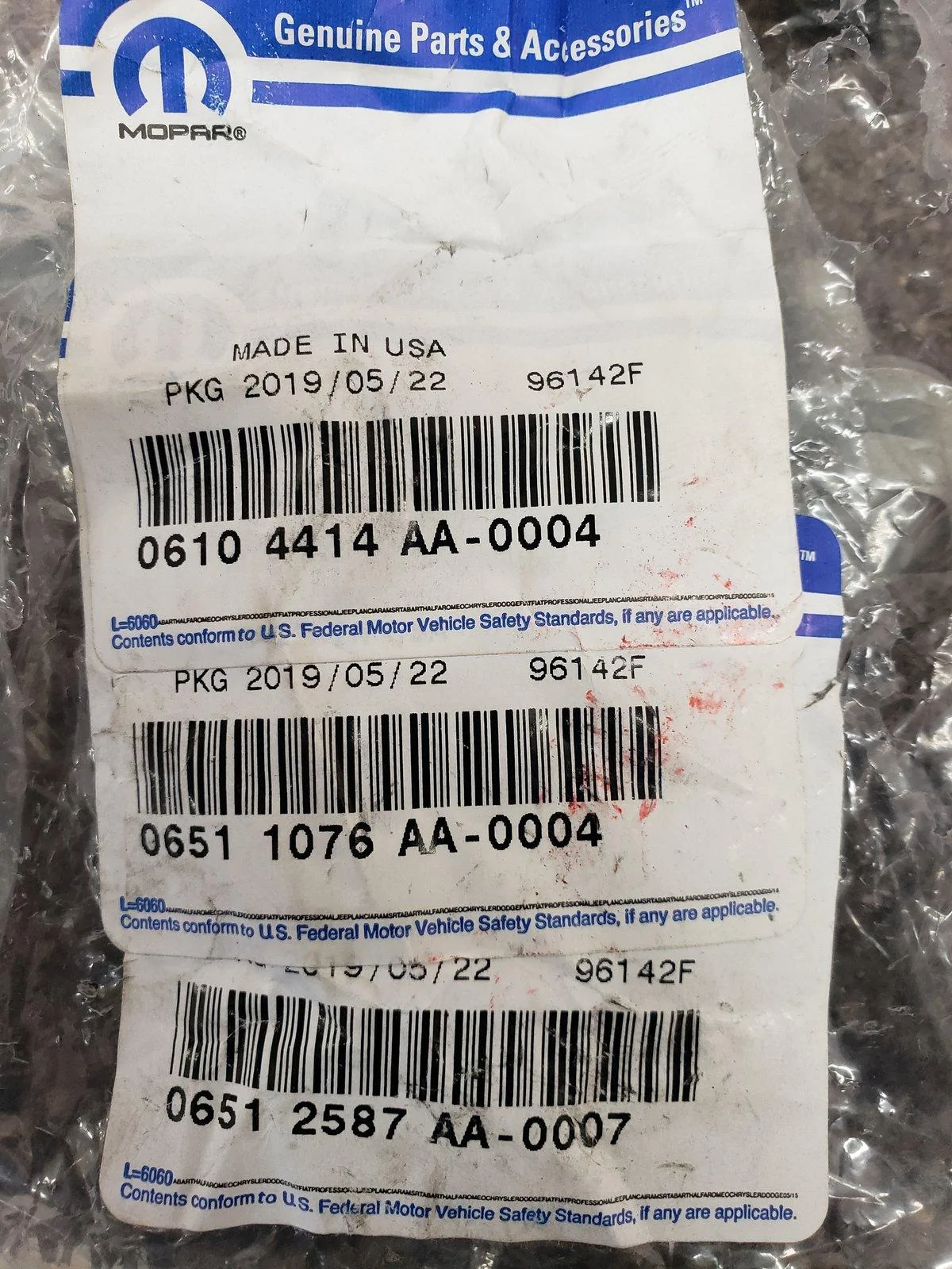

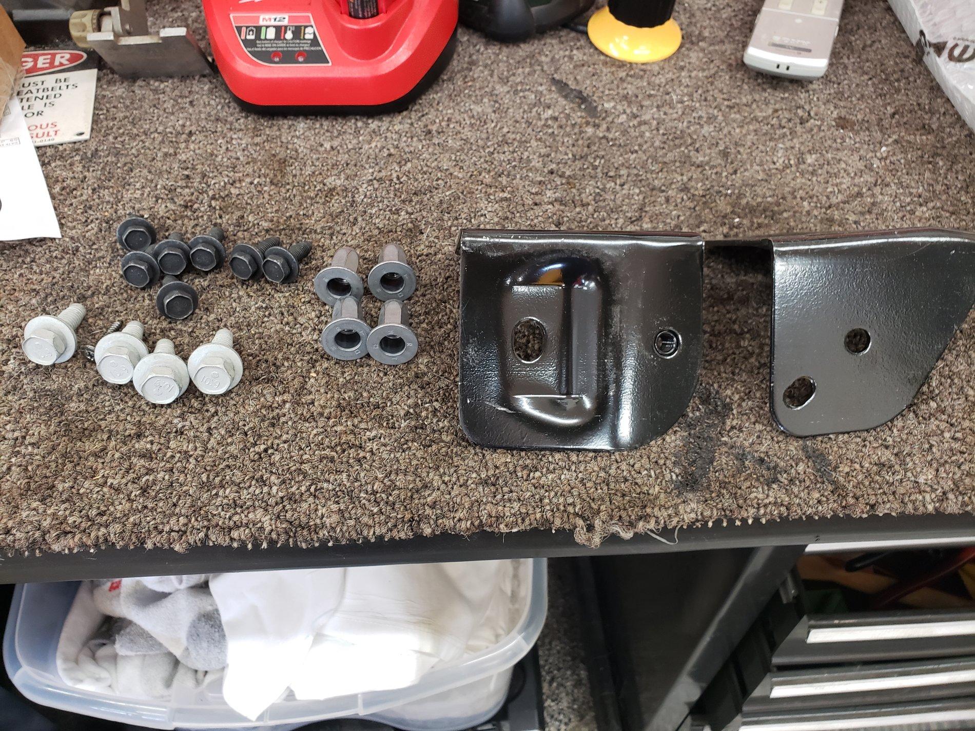

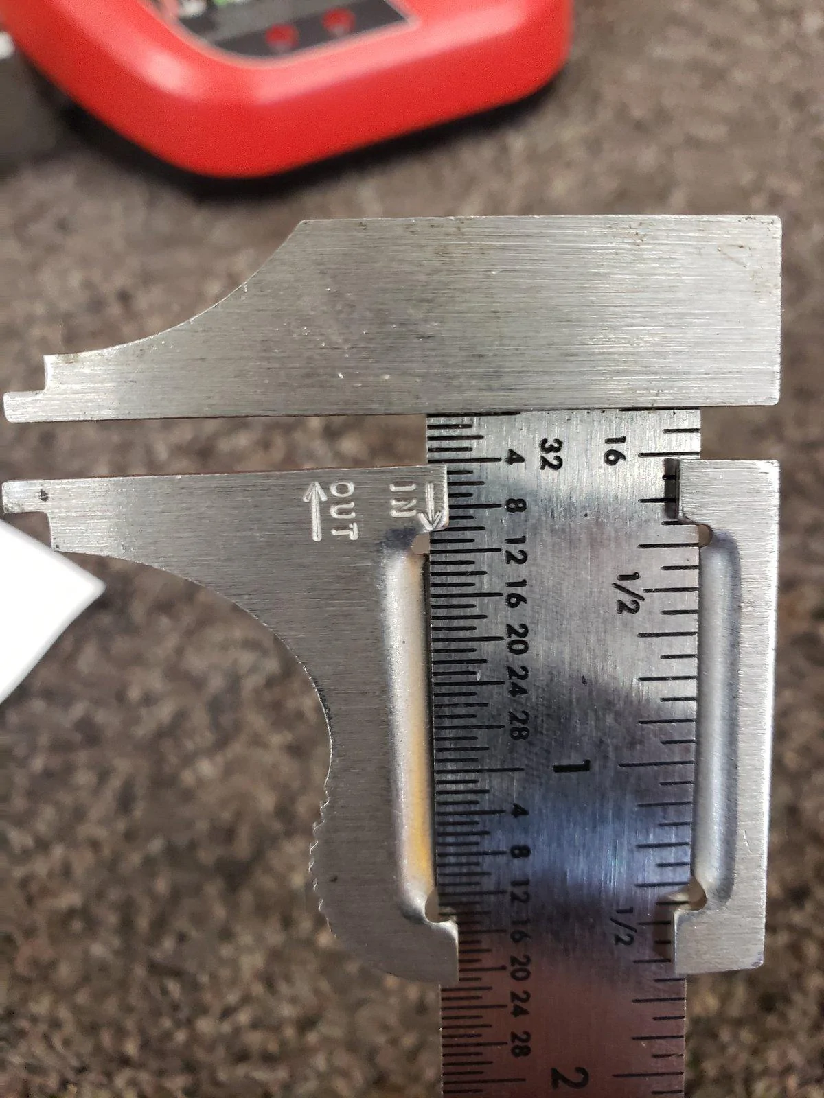

I have the 220 dollar one.....it looks identical to the cheaper one.....this I e however comes with the hardware and brackets. The thickness of the steel is similar. Here are the part numbers for the bolts......no numbers for the brackets.........the very last number of the tag indicates number of that item in the package.

Thanks! 4/32 =.125
For clarity anyone who is installing a steel bumper and skid on an Sport/Sport S/Overland will need everything in this "kit" to complete installation.
If you are installing on a Rubicon with the PPOS (plastic piece of shit) bumper, you will in addition to the bumper need only the skid plate and 4 rivnuts I have linked above.ETA: and 5 bokts/nuts/washers to connect the bumper and skid
