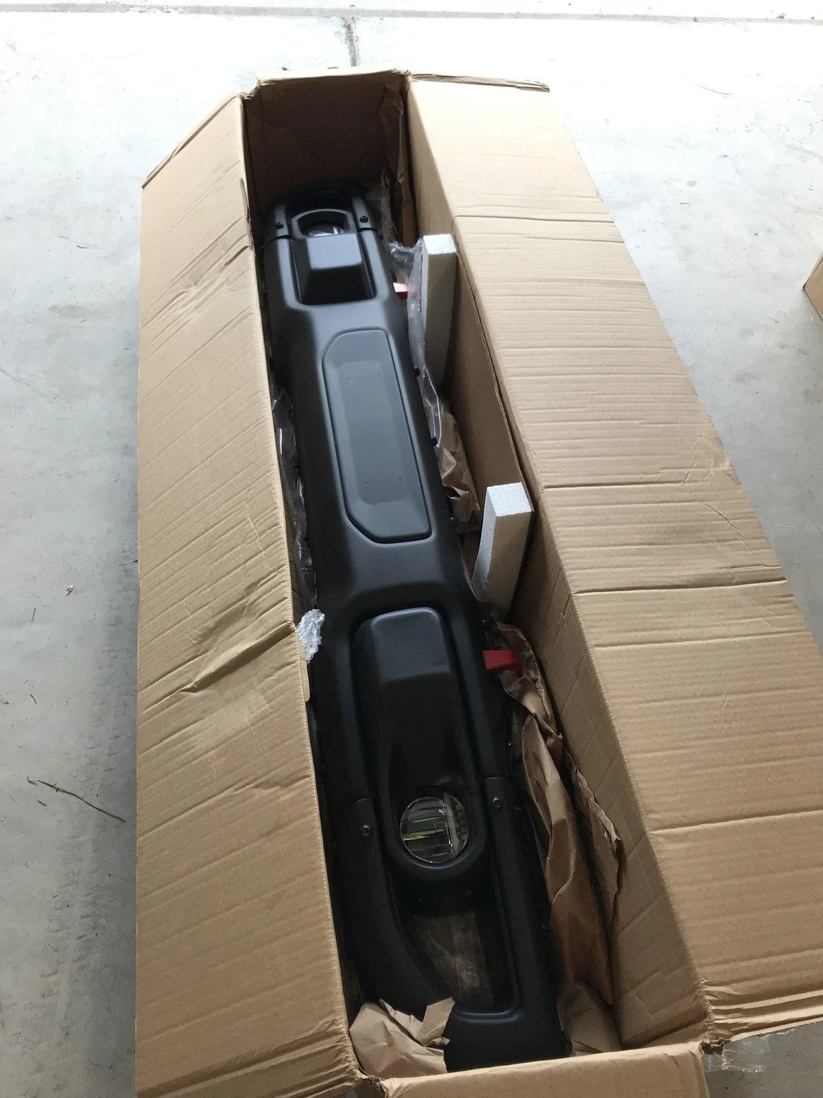

    Just received bumper from BAM. Packaged really well. Only one small cosmetic issue with a plastic piece that should be easy to replace if they don’t respond. Overall good experience and ready as soon as I get my JTR in a couple weeks.
    bgenlvtex likes this.
