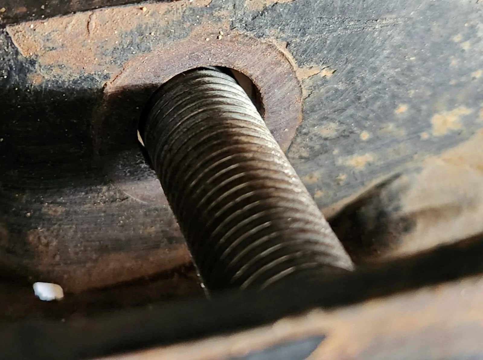

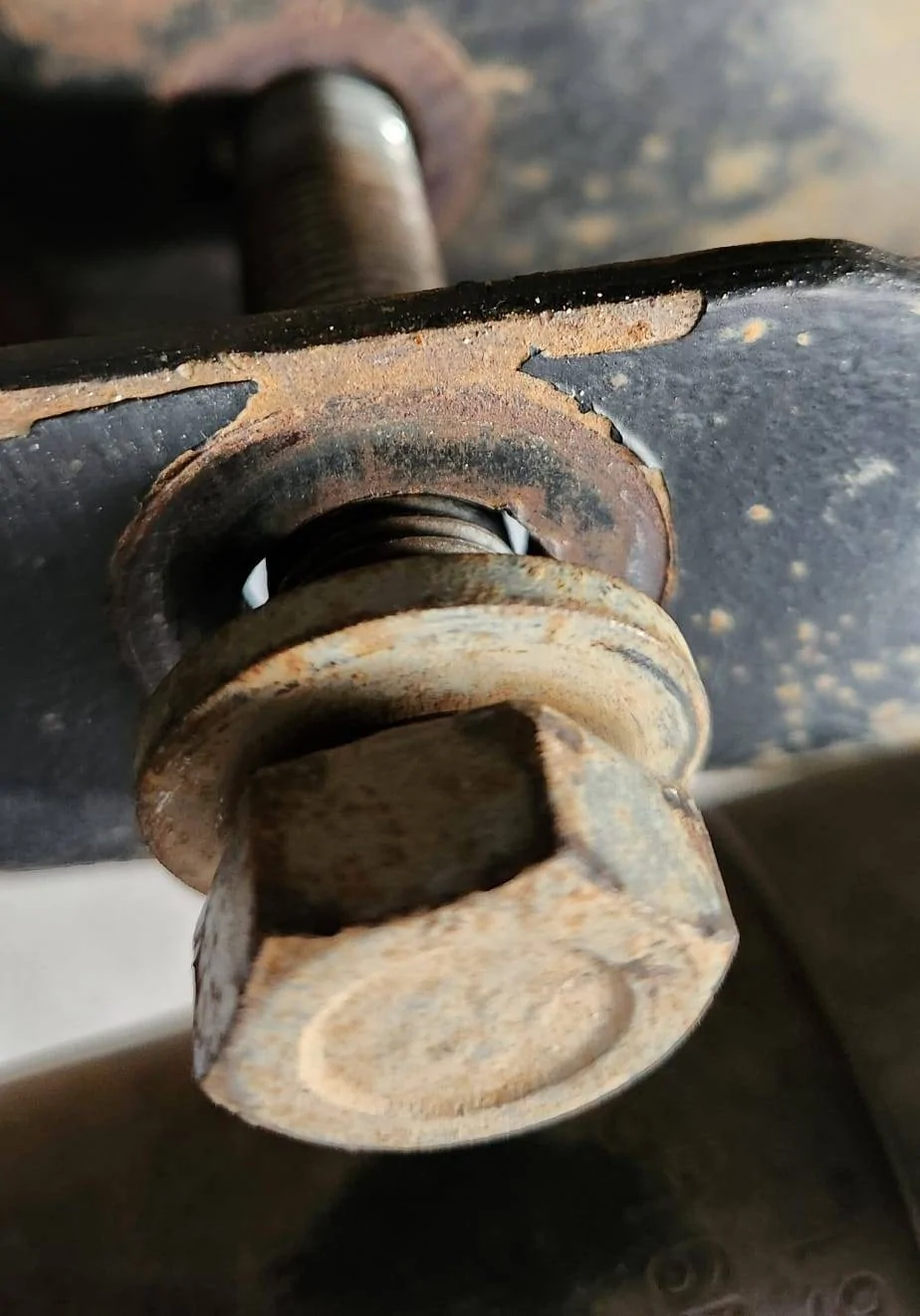

Problem came back after correct torque check a few months ago. I removed the track bar to inspect. Could the axle mount hole be causing excessive play? The mounting bolt isn't very snug when inserted. The mount bolt fits snugly when inserted through the track bar itself. Thoughts?
Thanks -Ron

The track bar and the frame/axle side is one of those things where they are actually drilled out to a inch standard and not MM but Jeep puts in a 14MM bolt. Going to a Grade 10 9/16" bolt will take up some of that excess space.
