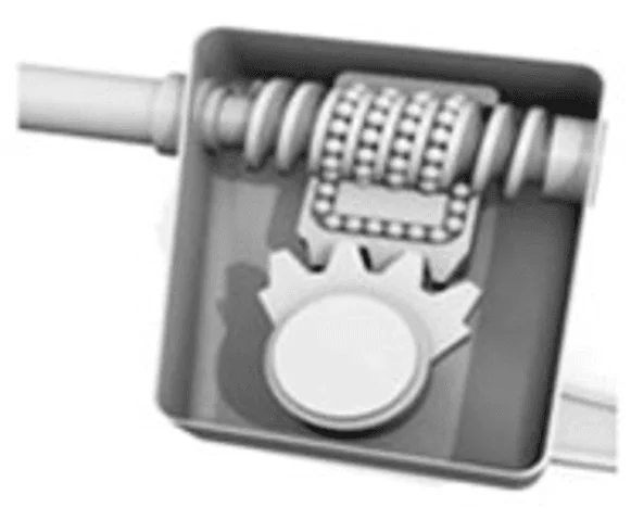

One way to test that thought - with the load off the tires,
Make sure to start out with steering wheel perfectly centered,
turn the steering wheel full left, note the wheel position.
Go back to center, then turn full right and note position.
there should be the same turns and partial turns center to left, and center to right.
If the steering column itself has slipped on splines or the coupling has shifted, you'll not get as many turns center left vs. center right because the steering gear's sector should be centered on and facing the worm gear at a perfect 90 if the wheels are straight.
This isn't a great image but I didn't feel like grabbing one of my tech manuals on steering overhaul right now (dizzy on stairs)
Jeep Gladiator Steering wheel is turned left while driving straight. 1704740210438
The sector should be at the high point with wheels facing perfectly ahead and steering wheel centered. That should be a perfect 90 degrees from worm to sector.
I don't know about these, but most older models I've worked on, there was a flange pressed and welded to the column's shaft, then a flex joint which was splined and clamped to the steering gear's input shaft. I can see something slipping, but at some point you are going to run into serious trouble if it slips there. (not implying that anything else slipping is ok! It's not)
I appreciate this test... It seems very logical and I'm not jeep mechanical expert. I did run the test you mentioned and steering to the left gives me just OVER 1 and 1/2 turns. Turning to the right gives me just UNDER 1 and 1/2 turns. So would this indicate that the teeth in the steering box are jumping? Like I stated before. Sometimes I have to correct the wheel one way and then sometimes another.

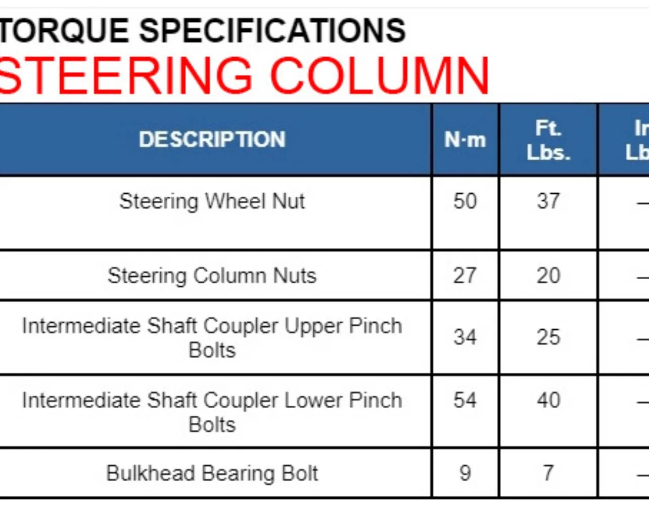

Take a look at this pic of the steering column:
Jeep Gladiator Steering wheel is turned left while driving straight. 1704744259092
bolt 8 in the lower left corner appears to connect the intermediate shaft to the steering box. From the pic it appears that the shaft is secured to the steering box with a clamp and bolt 8. To me that looks like a point for slipping if not properly tightened.
Pinch bolts:
Jeep Gladiator Steering wheel is turned left while driving straight. IMG_4655
Pinch bolts:
Thanks.... It is very tight. Also, the steering box is not the aluminum one if that gives any helpful information. Thanks again!
