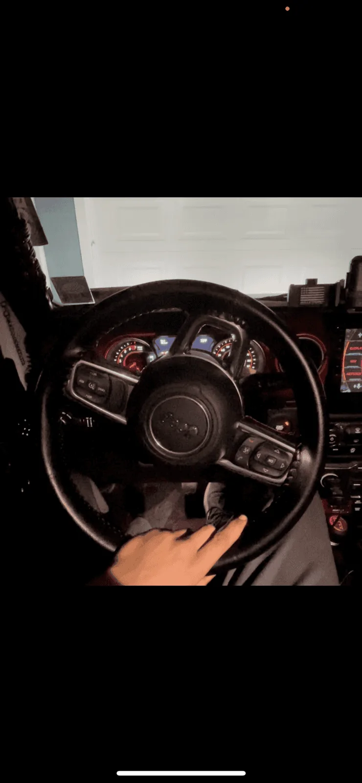

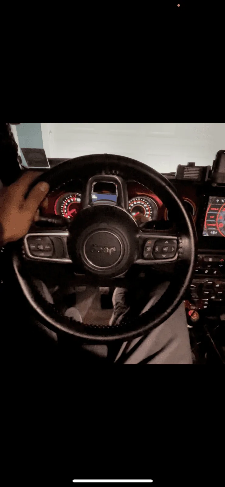

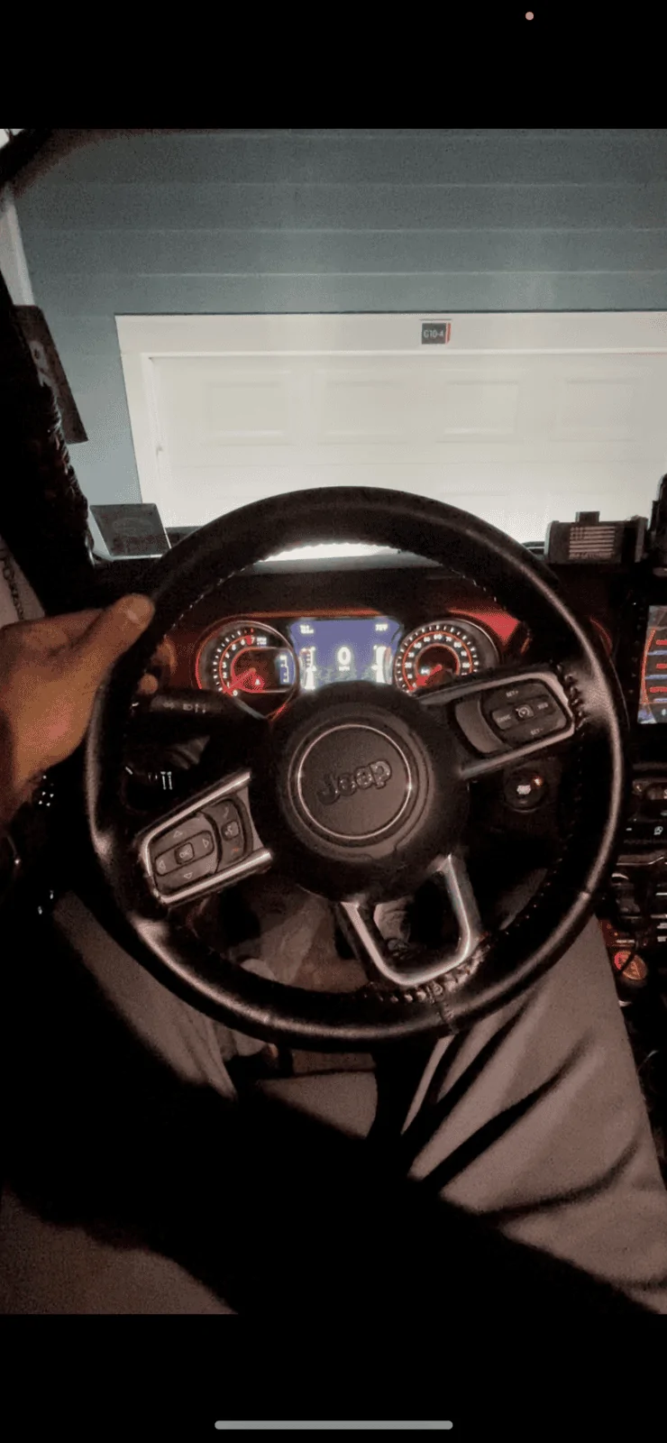

Update:
This is not an alignment issue. Alignment is perfect, sitting on turn plates truck not running tires are straight. You start the truck the steering will turn to about the 11 o clock position with no input.
My friend does have a Tazer installed. We just uninstalled it and the issue went away. He is going to update the Tazer and reinstall and see if the issue comes back. Looks like it is software related.
