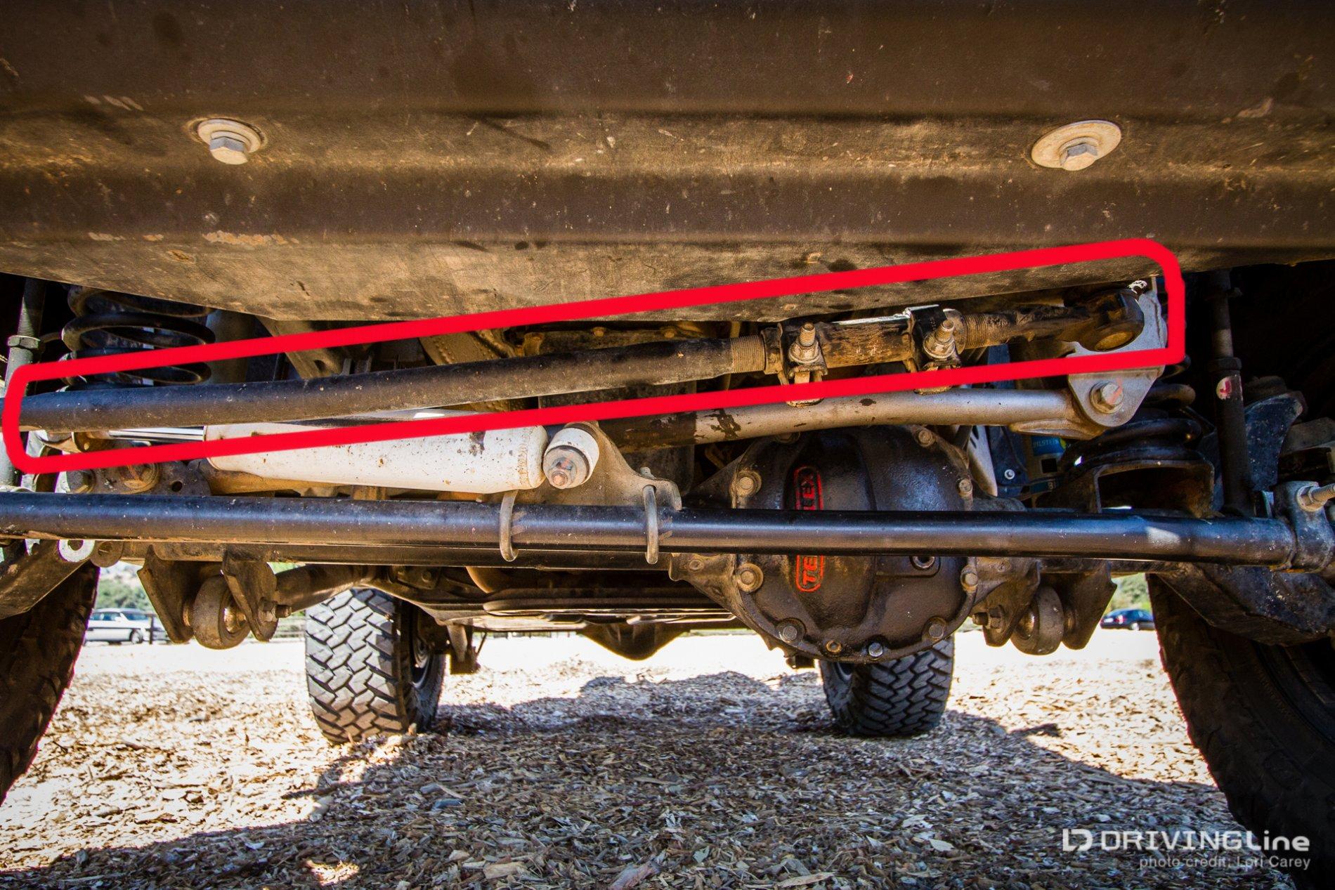

I seen this thread for the first time today and it sure don't see a need to explain: To correct steering wheel - adjust track bar if needed to center axle then adjust drag link to center the wheel. Short and simple. Have a nice day

You are assuming a lot - like adjustable track bar, for example. I don't have one.
I've recentered the steering wheel multiple times due to various other factors.
The problem is, a lot of novices aren't sure the drag link from tie rod and why should they know all of that and exactly where and how to adjust?
You can do it, I can do it, many can, but the vast majority of Jeep owners can't even ID the parts under the front of their Jeep.
The point is to educate some folks on what's what, how and why and when to do something.
Then there's some, those few, who should take any wrench they own back to the store and stick to their day job (hopefully not working in an auto shop).

This short video does a good job
of showing how to do it.
Straighten Your Jeep's Steering Wheel
A deep 15mm socket may be needed.
I did not have one.
At 76, I am so weak I used penetrating oil,
a long 15mm wrench with a cheater pipe
and a pipe wrench to turn the collar.
Just remember, turn the collar clockwise
to adjust the steering wheel counter clockwise
and vice versa.
One quarter of a turn was all it took
to make me straight.
Avoiding the rest on purpose................
That's the thing with this - if you go thinking you need to take it a full turn or even 3/4 of a turn, you'll find yourself with a steering wheel tipped the other direction, well past level.
If you have JSCAN, you can watch the steering wheel angle from under the Jeep as you turn that piece.
The JSCAN angle reading has been the real game changer for me, find the angle it's off, turn it to that when on stands so the tire squish doesn't fight, then twist and go. It's especially handy with the aluminum drag links that use jam nuts torqued to hernia levels so you don't have to do it multiple times.
