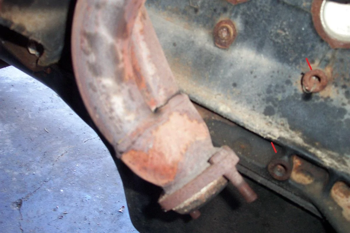

The header of the 90s 4.0 would split or crack at the collector. After-market headers used a flexible pipe on one of the pipes to allow for expansion and contraction with less stress. Seems there were other things 3rd party suppliers did. I never had one crack while on a Jeep but the engine I got for my Eagle had a cracked collector and I had a neighbor slice it off and re-weld it. Stupidly, I told him to put it back on in the same position instead of turning it to clear the front differential pinion brace! So I had to make a brace to clear my exhaust. If that head pipe ever goes bad I'll probably have to drop the engine out to replace it.
The holes marked with red lines are where the pinion brace bolts to the block for Eagle - exactly where the 4.0 exhaust points.
This is the only I6 I've owned that had any exhaust manifold issues and this doesn't count as I was pulling the engine out of a Jeep and putting it in my car so it was all apart for a complete rebuild and little bit of upgrading anyway.
This is pretty common on some years of the 4.0. This one went 100,000 miles.
Yup. Common issue, but I don’t remember it being a bad job. There was a lot of room on the left side of that engine.

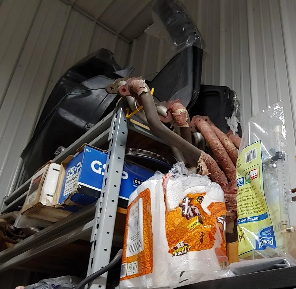

The 2 piece header/manifold is what fixed it.
Yeah, I believe I have one hanging up in my shop, with an experimental aluminum head on the shelf, and I think a performance header unless I got rid of that already. (along with spare axles, stuff for CC'ing heads, interior parts)
