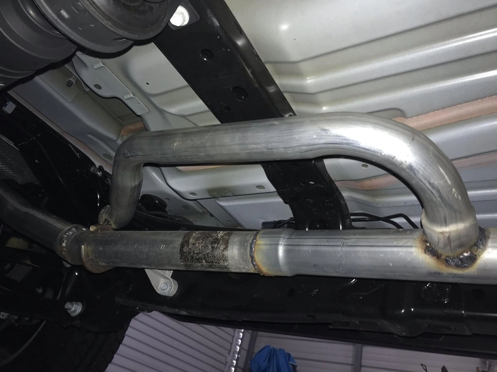

Took out the first resonator and the huge muffler. Left the last resonator. Added a J pipe to cancel drone at around 2000 rpm. Love the sound.
Any pics of your setup from underneath?
Cut just in front of first resonator and behind suitcase muffler. Added straight pipe. Then added resonator to dampen 2000 rpm drone. Still running this way and still like it.
Jeep Gladiator Exhaust delete and replacement straight piping CE3E78B4-6E32-4187-8406-46B1938286CC

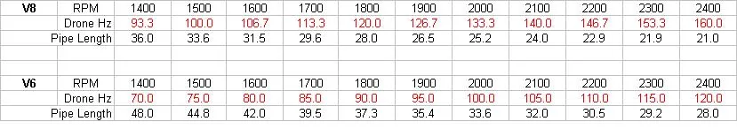

Resonator pipe lengths if interested
Jeep Gladiator Exhaust delete and replacement straight piping 0E281FC0-E2BB-482E-B9B2-BE3E9EA9C04F
