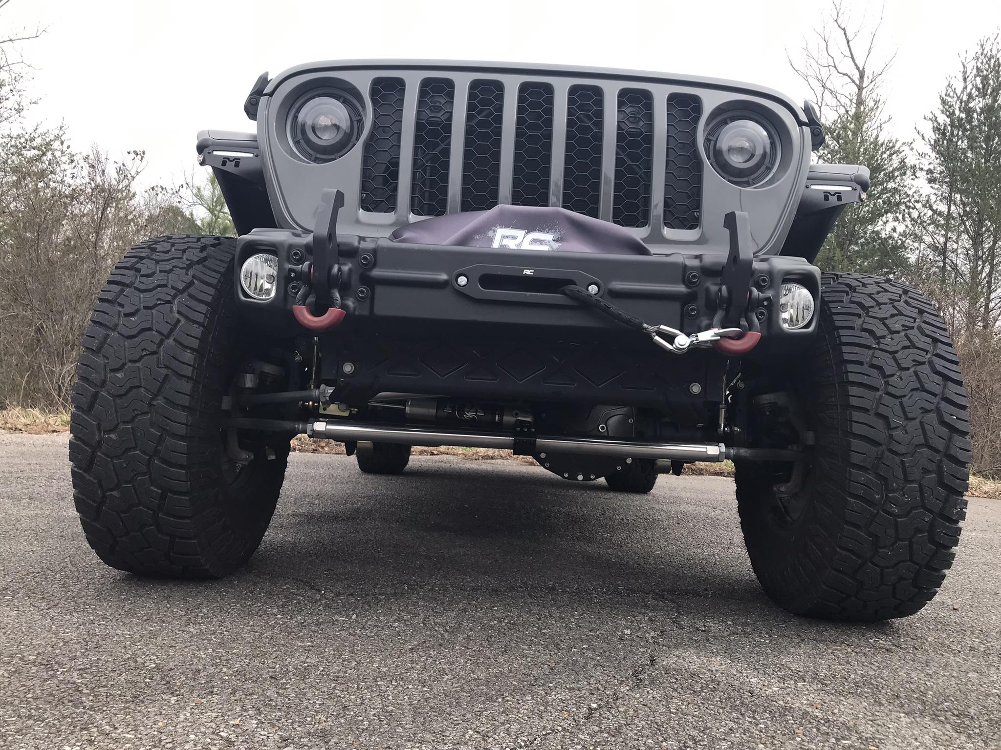

I’m hoping anyone can give me some tips on the RPM tie rod, long story short I had the whole 2.5 ton steering kit installed at a shop, a few weeks later both lock nuts on either side on the ends came loose, I brought it back and they fixed it. Now 3 months later one of them is loose again, is this just technician error when installing or is there something wrong with my actual tie rod? I do have a 2019 wrangler, with 4 inch lift on 35’s, but figured this wouldn’t hurt to ask here.
here are pics from both instances, back in May and yesterday.
Jeep Gladiator Steersmarts vs rpm vs apex chasis 5F54094B-30E8-492D-B94C-6A9CB41F387F
Jeep Gladiator Steersmarts vs rpm vs apex chasis C6649D56-C28D-4C19-BF50-A666CF8D28E2
hjdca
Oct 27, 2019
1,733
2,494
Southern California Mountains
1. First re-validate your toe in, and make sure it is correct.
2. Take blue locktite and pour it over the threads near the washer.
3. Use a two cresent wrenches, ie. 15 inch and 18 inch and tighten the lock nuts with as much strength as you can muster. Use your legs and pull like crazy.
4. Mark the nut and bar with paint pen so you know when it comes loose.
5. Let the Blue locktite dry before driving again.
This procedure has worked well for me. I just ran The Rubicon trail with my RPM stuff and neither bars came loose, and my RPM tie rod took lots of rock hits. Still straight as an arrow. Really like the RPM stuff so far.

What he said.
My tie rod hasnt come loose on the RPM steering stuff, but I was fighting with my draglink for the longest time. On the draglink i had to rotate the pitman arm side forward if that makes sense then lock it down with the double crescent wrench method to get it to actually stay.
